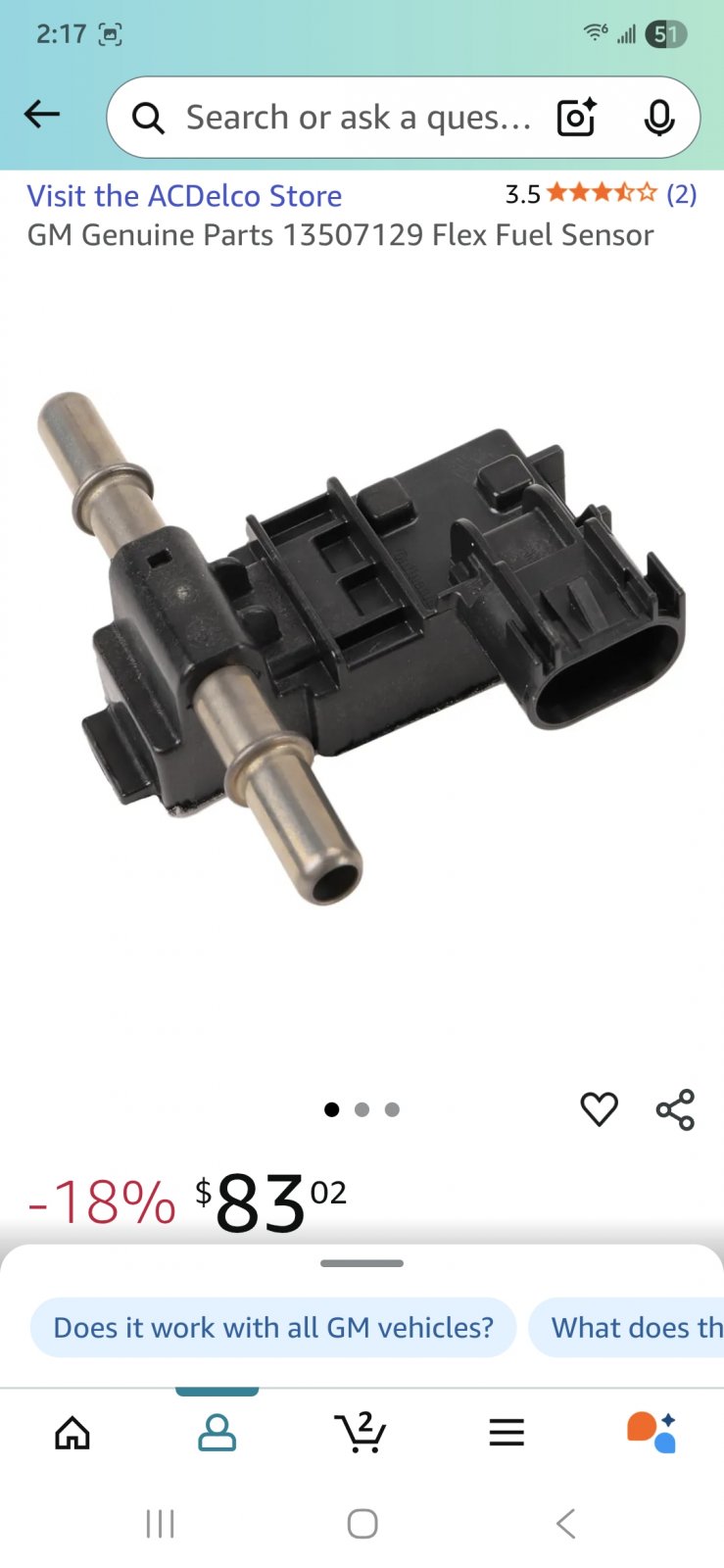

Tell me more of this sensor and tables gettin turned on please..
E85 worth the trouble of adding a sensor and getting tables turned on?
Cost me about 130 bucks maybe in parts, and asked my tuner from BBP to let the car run on e85
