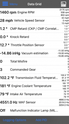

I ran my distributor at +4 for weeks without a code. And my above numbers were off. +22 is idle, it’s in the 30s with throttle.
1st pic is “timing” at idle
2nd pic shows the cam offset reading (CMP RETARD)
This reading is only accurate over 1000 RPM

The “timing” is programmed into the computer and requires a tuner to edit. The CMP offset measures how well the distributor was installed. As I understand it, the computer tells the coil/ICM when to fire, the distributor is only to get the spark to the correct cylinder.
With the timing mark lined up, the rotor should point one of 2 places: toward the passenger seat (#6 maybe?) or toward the driver tire at TDC #1.
If you’re running at all and not idling violently then you’re close. There is good bit of adjustment in the distributor degree range.
A 1/2” distributor wrench, scanner and $20 in apps or let a shop correct it. If I can do it, anyone can.Just remember to check CMP over 1,000 RPM
