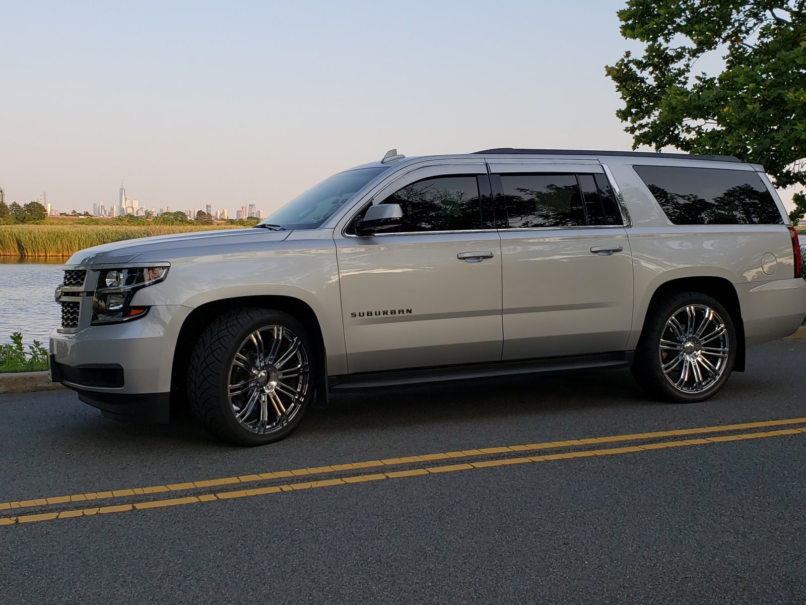

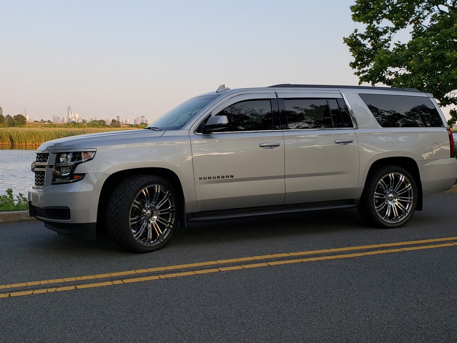

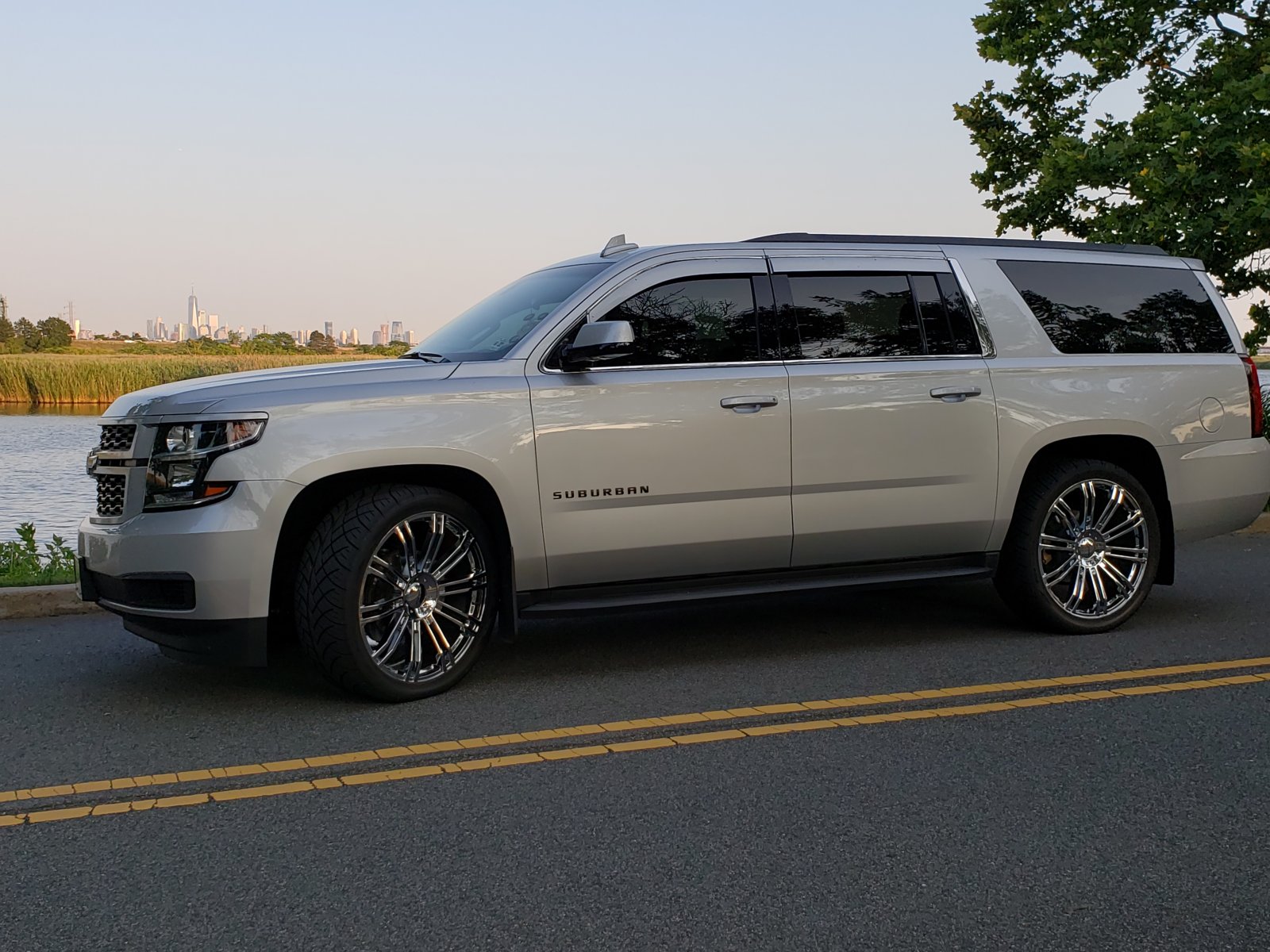

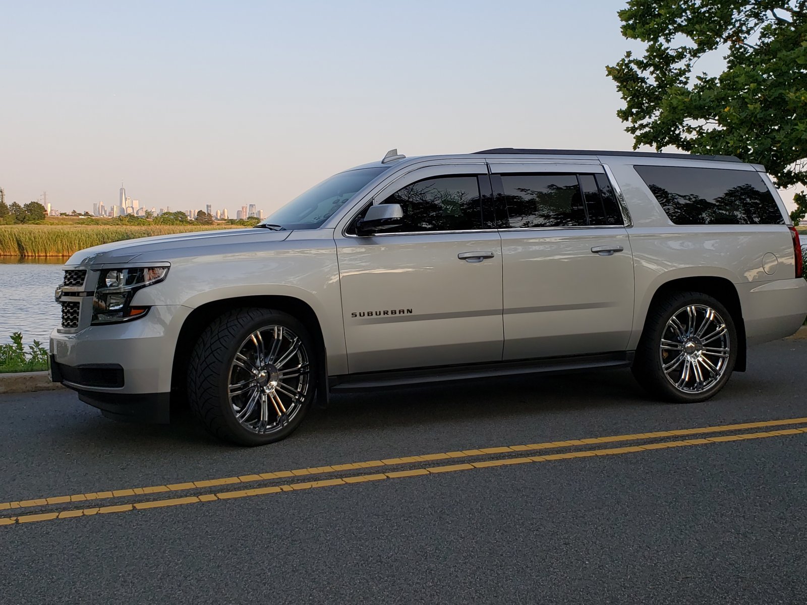

The 2 inch spacers saved the day. Pulled back wheel wells and no rubbing except in reverse on a lock. Had 6 people in the truck plus weekend bags and headed down the shore. Truck was perfectly level. Ride is a little harsher than I expected but handles much much better. The Nitto 420s are a little bit on the noisy side but I wanted the wet weather performance so worth the trade off. The only disappointment is how much more sluggish the truck is with the big wheels. Its very noticeable going from factory 18's to the 24's. I guess the Whipple 2.3 will solve that problem.

2” spacers were the ticket on the rear. Lowered stance looks much better glad you’re happy with it.
You bring up an interesting fact touching on how sluggish the truck is going from 18’s to 24’s. I’d be curious to see the wheel weight comparison of your stock 18’s with tires compared to your new 24’s with tires.

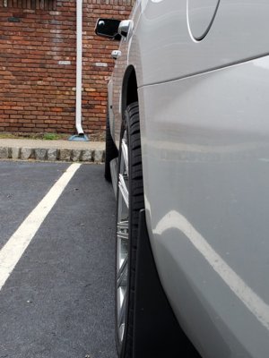

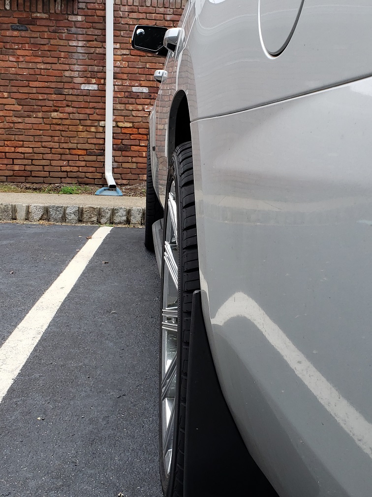

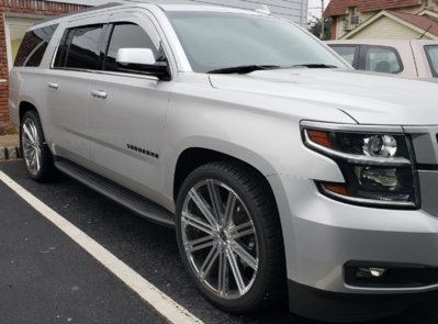

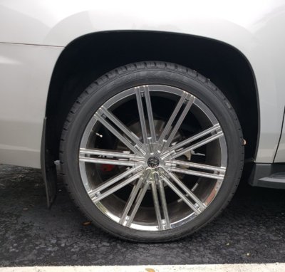

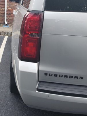

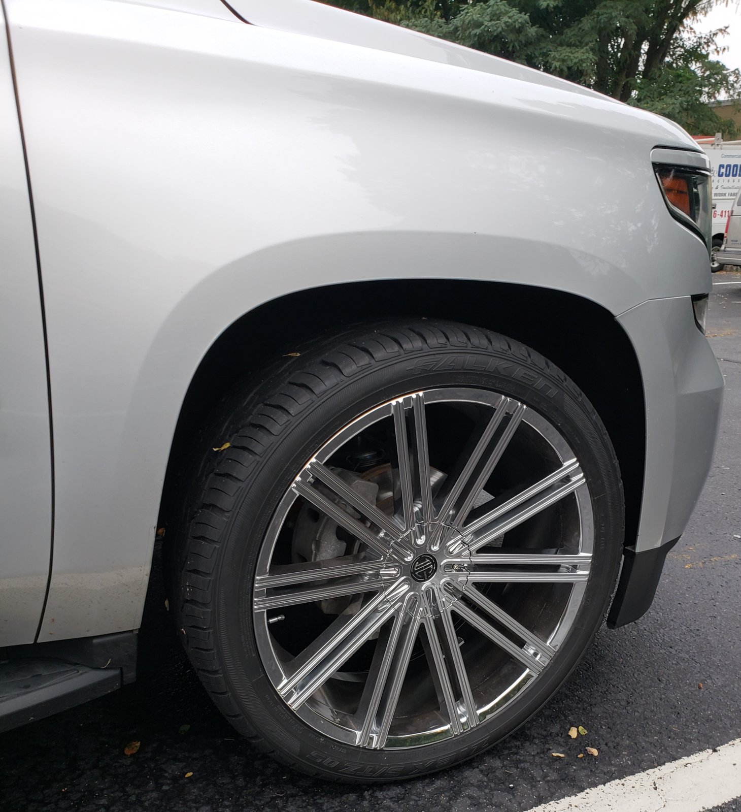

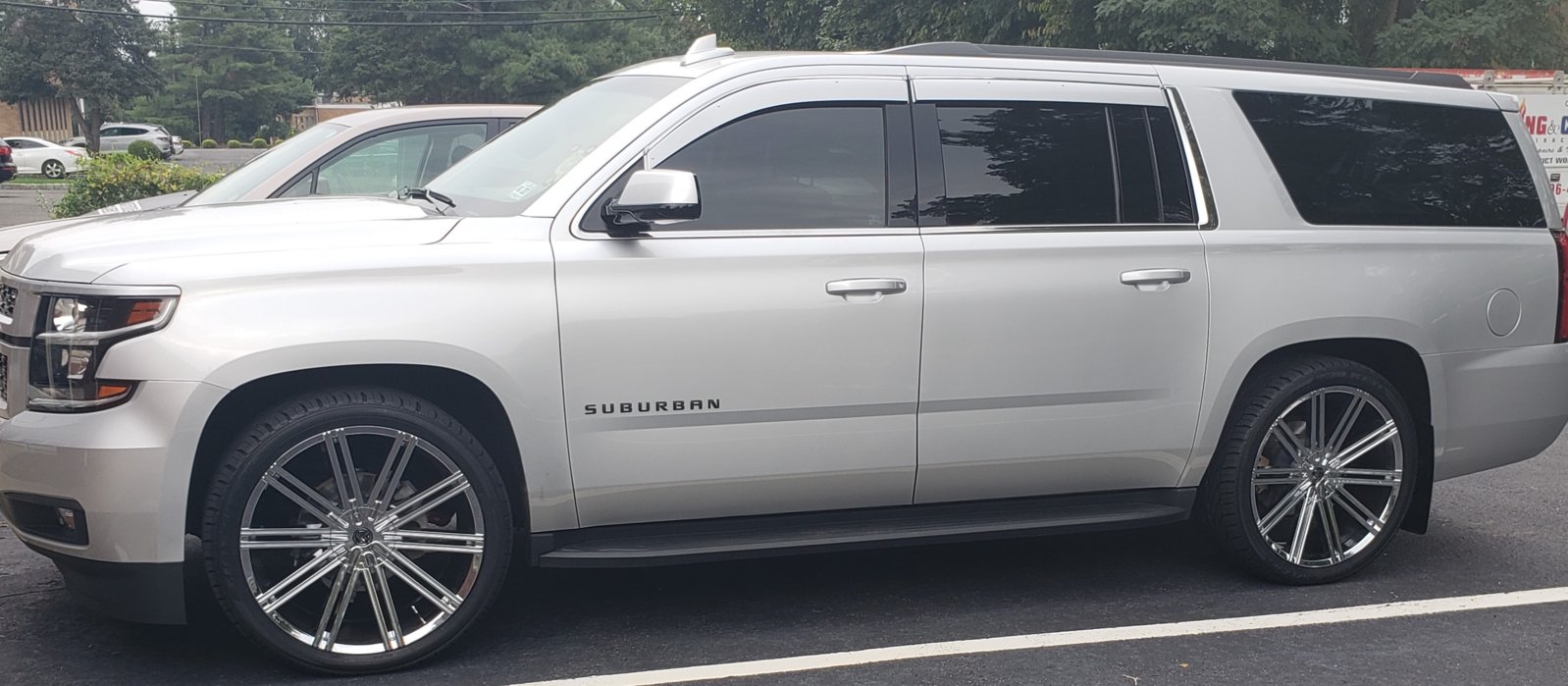

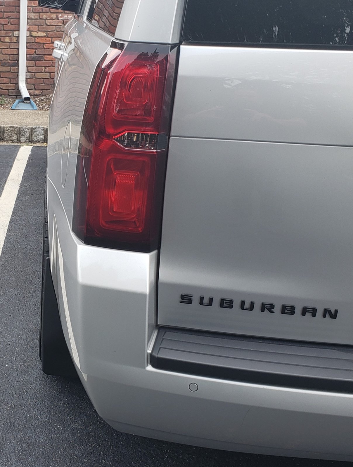

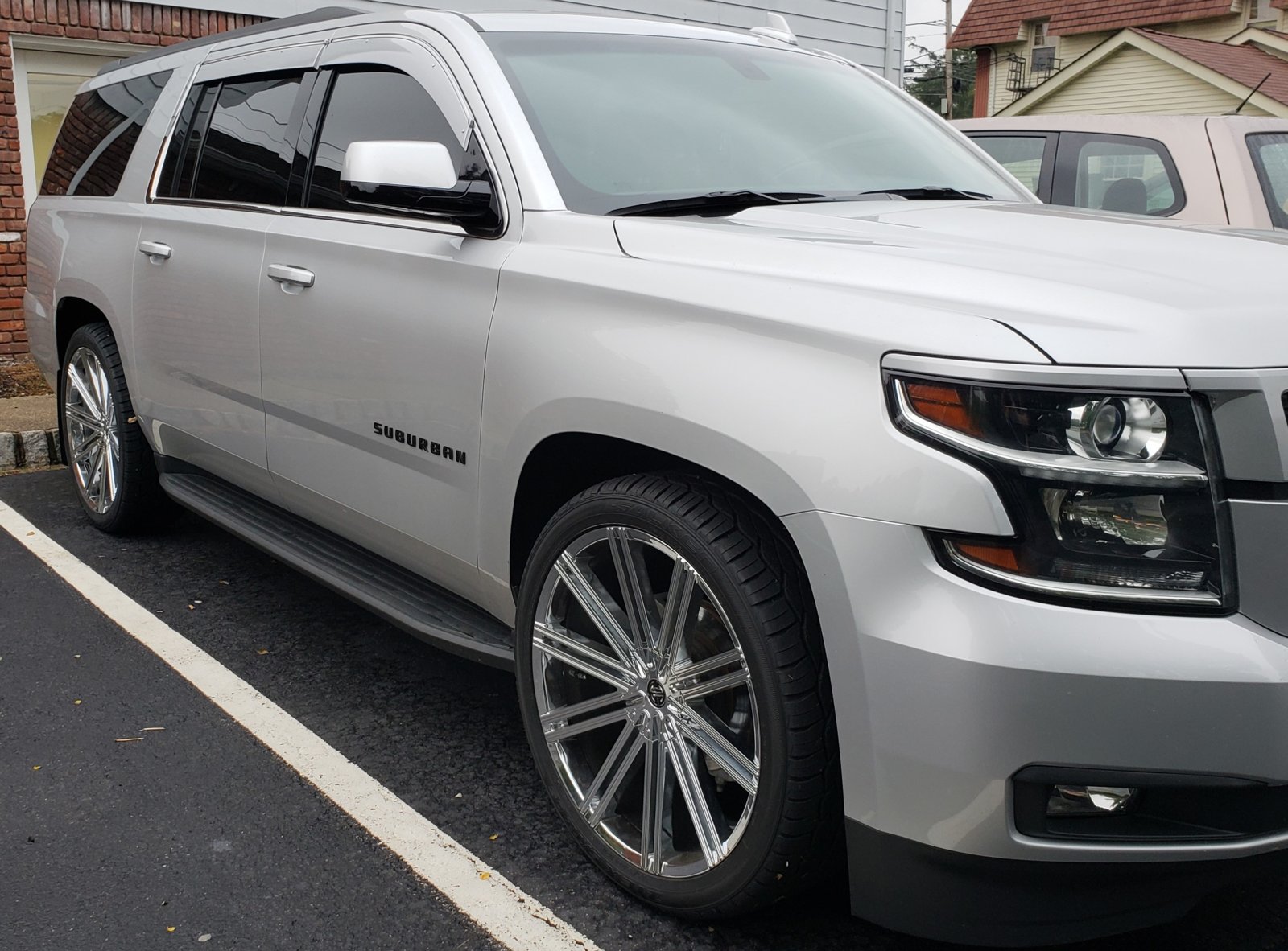

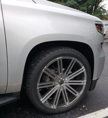

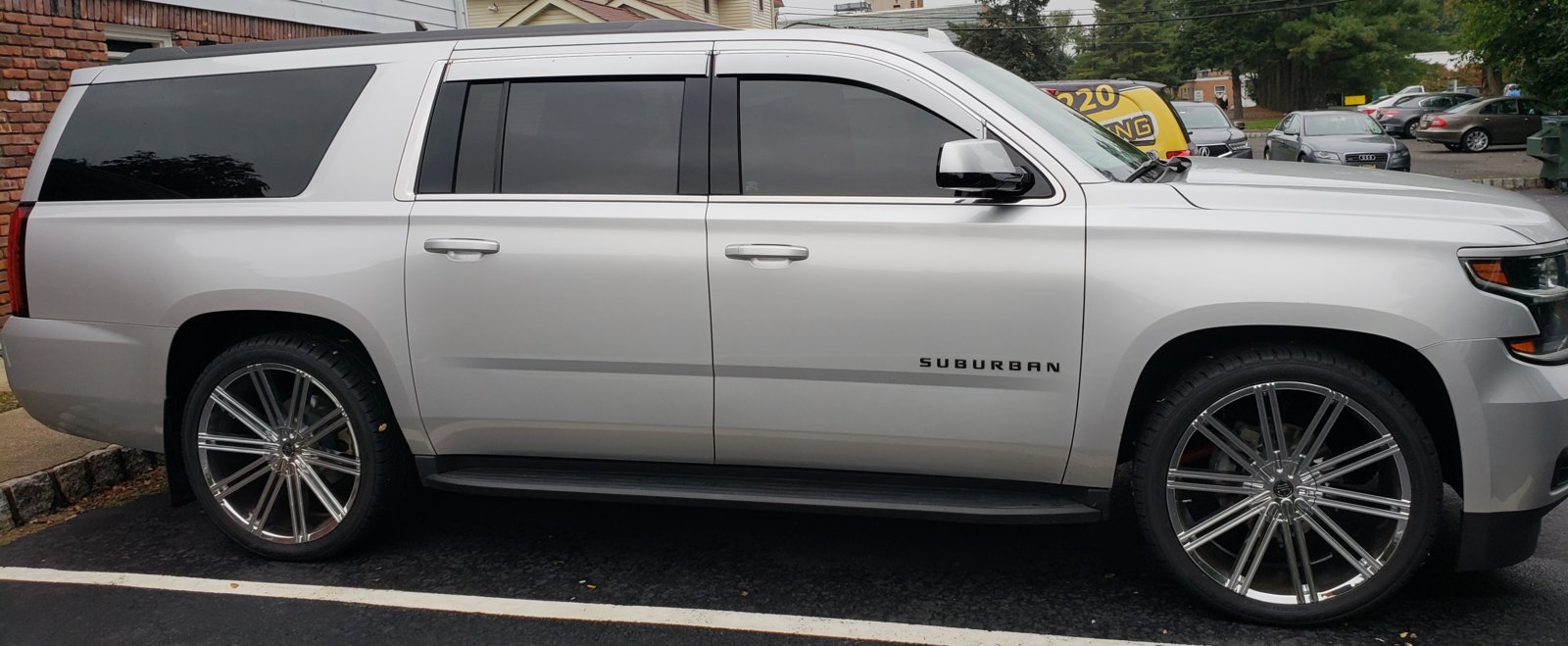

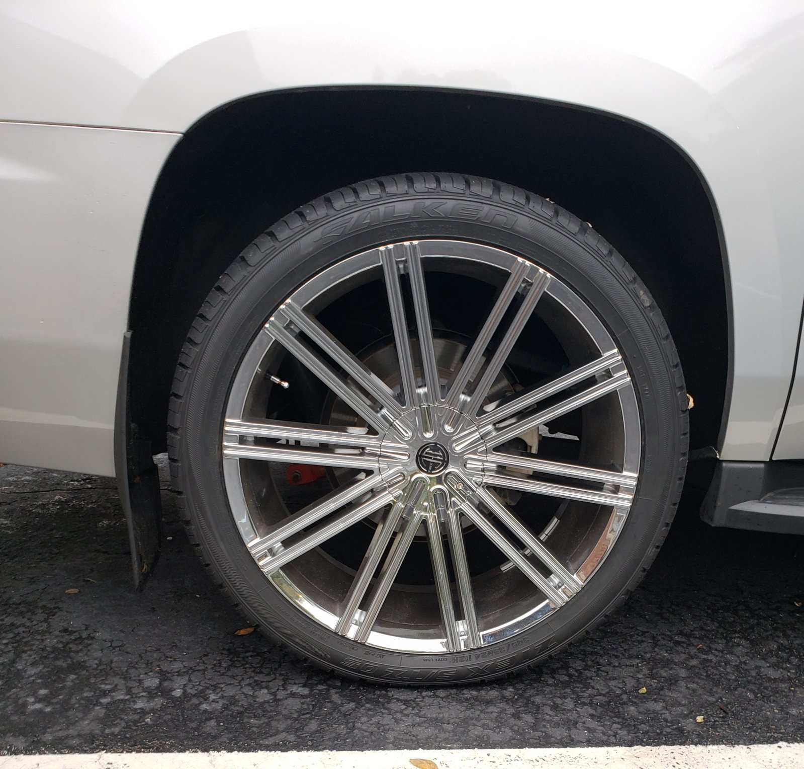

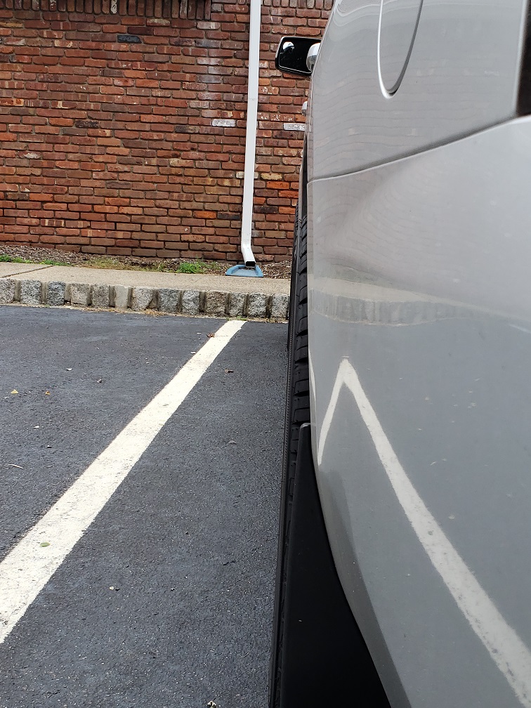

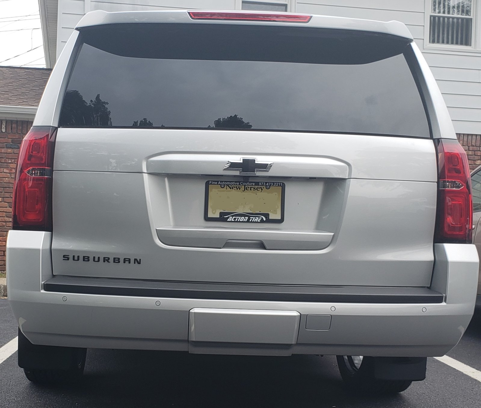

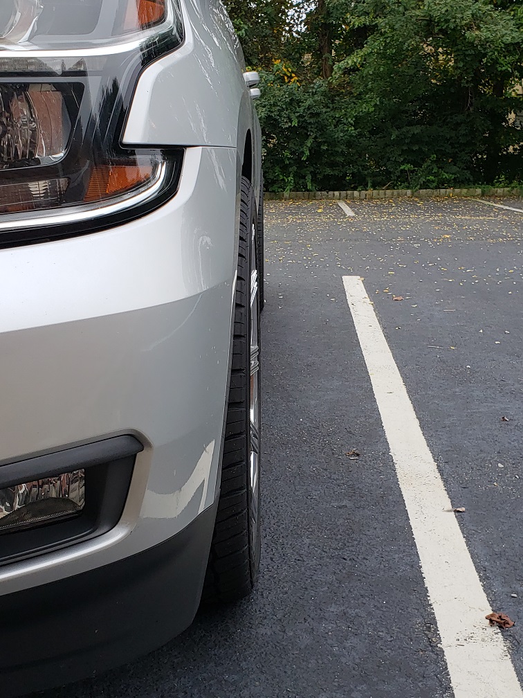

Sold off the KMC D2 and ordered a new set of wheels. 2 Crave No 47, 24". +15 offset, hub centric, w/ Falken 305/35 24s. Much quieter ride than the NT420s. Handles awesome. No vibration in the truck compared to the lug centric KMCs. They rub just a little on the inside of the fender wells but nothing a BFH and some elbow grease can't fix. The +15 offiset sticks out just a hair from the fender wells but its a great look without being ridiculous. I'm much happier now.
The 2 Craves don't look as aggressive and the KMCs but knowing I was hitting the sway bar on lock to lock was pissing me off. And the vibration after 40mph was to the point where it was unbearable. Even my wife didn't like it. So these wheels solved 2 problems.
20181004_153934.jpg 20181008_162540.jpg 20181008_162546.jpg 20181004_153845.jpg 20181004_153845.jpg 20181008_162613.jpg 20181004_153920.jpg 20181008_162555.jpg View attachment 208944

I could have went with 295/35 tires and avoided the rubbing but I wanted some more meat on the tires cause the roads in Jersey suck. Now I just need to do something about those tiny tiny brakes!

Looks really good. Any pics more staight on of the front fender to show how little the tires stick out past the fender? It can’t be much as it is hard to tell from the pics.

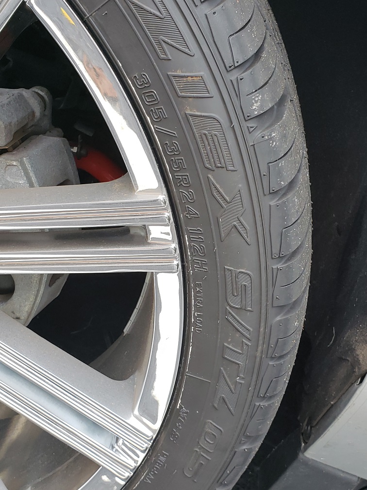

Are the Falken’s S/T Z05’s?
The wheel sizing and fitment look great.

Yes. 305/35R24 S/TZ 05 model tires. Very little hum. Much quieter than the NT420s but still a noticeable hum if you turn off everything and just listen. I'm beginning to relaize that once you breach the 24" wheel size I don't think there is any tire that will have 0 noise. I was on some other forums and it seems that everyone has a little bit of tire noise at 22" and up.
Another thing nice thing about the 2 Craves over the KMCs is that the truck isn't as sluggish. There was a HUGE difference in performance going from my OEM 18"s to the KMC...night and day difference. It was like having a trailer attached to the truck. I borrowed a freinds Escalade 22's while waiting for the 2 Craves to come in and those wheels made the truck perform just like my factory 18's. When the 2 Craves went on, it was slighty more sluggish but no where near how bad the KMCs were. It could be a combination of the NT420's and the wheels but it was pretty bad. These wheels are rated at 50lbs. I was considering DUB Futures that came in at 45lbs but they only were available in +30 offset...same as the KMCs. The +15 offset makes the difference - no touching the sway bar on lock to lock. As I said earlier, I probably could have avoided the fender well rub had I gone with a 295 tire but too many "craters" on NJ roads made me go for more meat.
I'm very pleased with how the truck handles, rides, and feels now. Down the road I will get a little stiffer spring for up front and maybe a shock that isn't as forgiving to further reduce the body roll but considering the size and weight of the truck and how I can carve corners now, I'm very happy.
