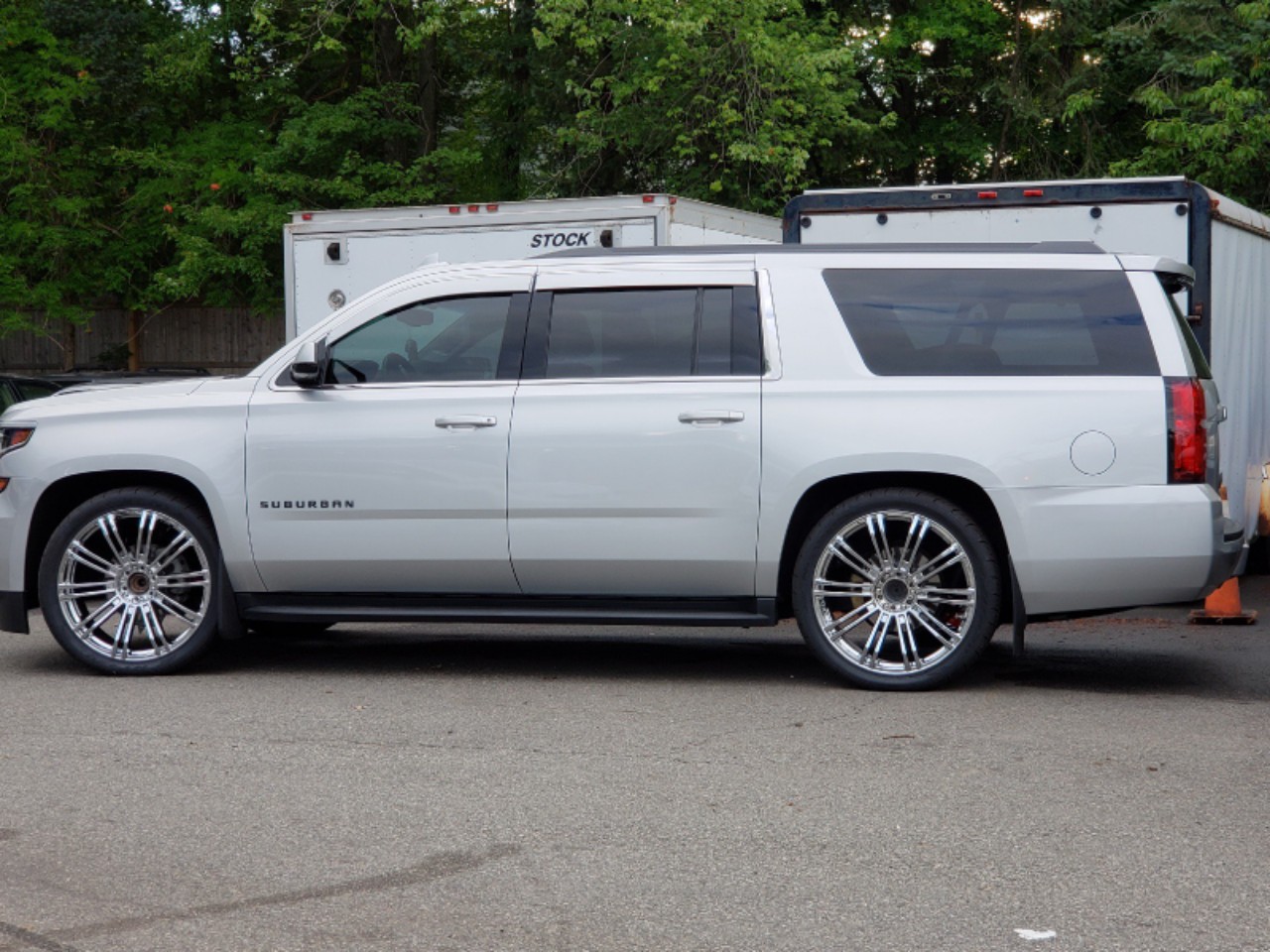

I'm venting a bit and still working through the issues but this experience has been pretty disappointing. Ordered the 2-3 drop kit and heavy duty sways from Tony, 24" KMC 677 D2s from discount tire direct along with nitto 305.35's, and a fog light kit from Vanquish auto.
Nothing has gone as expected. The rear looks like it got a 5" drop so there is no rake at all in the truck. The tires are rubbing. And Vanquish failed to include instructions for the fogs.
I'm less worried about the drop kit cause everyone's experience here and my brief conversations with Tony via emails, instills confidence so I am sure he will help me work through the drop issue.
KMC and DTD are less awe inspiring. After getting shipped a set of black wheels instead of chrome as per my original order, I come to find out that there are 2 types of wheels - hub centric and lug centric. The D2s are lug centric so I need to order a hub rings to correct that. I was told I needed to buy shallow/short lugs in order for the center caps to fit. So i did. And with the wheels mounted, the center caps still don't fit.....sigh....
I'm having a hard time believing that I am the first person on the planet to buy these wheels from DTD for a Tahoe/Burb/Yukon/Esky and them not have at least some type of information to provide customers.
Lastly I purchased a fog light kit from Vanquish. They sell a kit that hooks up to your existing harness so that the fogs come on when the headlights come on. Good enough for me and I don't have to add a switch to the dash or have my BCM programmed. No instructions. I reached out t them multiple times over the last few months with no response. Someone finally got back to me at 10pm EST last night. I'm disappointed that it took me threatening to return the product to get thier attention. Especially since they got my money months ago.
So anyways, I am hoping my post will help educate a few of us rookies who don't know all the ins and outs of wheels. Vanquish has been a disappointment thus far. I'll post again as I work through the issues. All the vendors I'm working with do deserve a fair shake so I will keep everyone posted. I'll put a picture of cheese on my next post since you were all so kind to listen to me whine.

Sorry for the headaches. But it does look f ing slick

Gm used 3 diffferent spring rates on the trucks and rear on suburban will lower .5 more due to weight.
We can always get a spacer for rear to lift it up more

Suburban looks good though. I think the drop and wheels look perfect IMO

Is this with just the rear lowered?
Did you lower the front at all?
Assuming the swaybars you got from Tony were Eibach, how’d the install go straight remove stock and install Eibach?
Did you get aftermarket endlinks?
Where are your tires rubbing? Front or Rear?
This ride height looks really good, very level. Are you wanting to raise the rear from the ride height in this pic?
Sorry so many questions, but I’ve got quite a few parts sitting in my garage (similar to your list) awaiting install.
52,954
The stance looks perfect to me- why would you want a rake? Most of us want it level. Hope you get the rest figured out, looks good. Vanquish service is terrible.

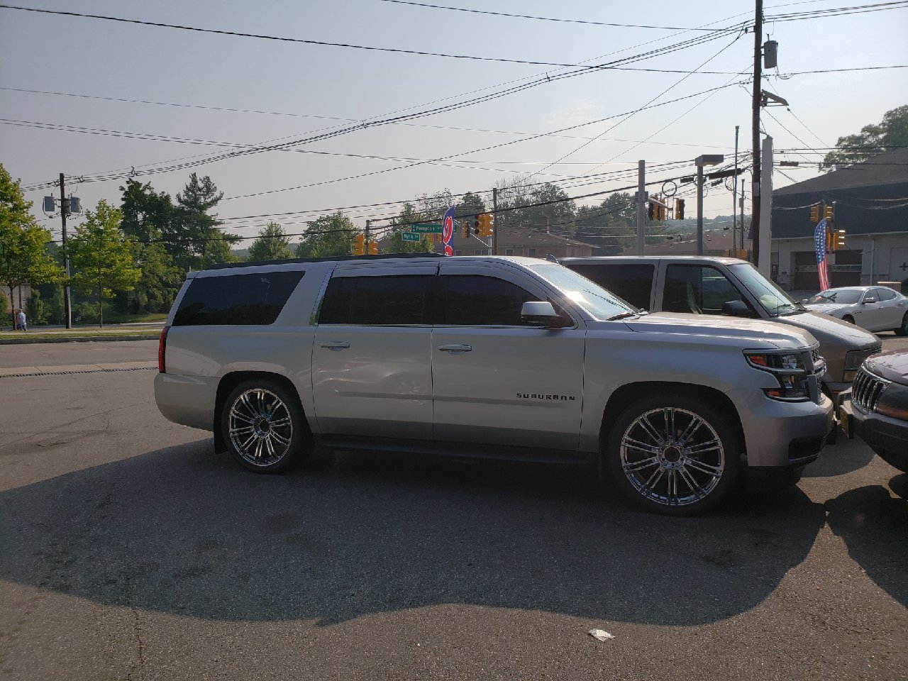

After a couple days of settling, the rear fell a bit more. Mind you I am not driving the truck around. Its basically sitting in a lot.
Tony showed me 2" spacers that will replace the 1" spacers that are installed. I may even have the installer do the heater hose on the coils to give it a little extra lift. That level ride with 6 or 7 passengers or 4 people with luggage is going to look awfully silly driving down the highway with a negative rake when the truck is loaded up. Plus it puts the truck in a bad position from a steering and handling perspective...especially when that many more people are in your hands.
Vanquish finally sent me directions to the fog installs although looking at them confuses me more. Maybe the installer will figure this out. Lastly I still need to call DTD to get more shallow lugs. They responded to my email by saying "please call".
@CMooore
  • Front and rear is lowered. Its a 2/3 drop from NorCal. Rear is too low for me. I need to know I can add weight to the truck in the form of passengers and luggage without the rear squatting lower than the front. I DON'T tow but I do put passengers in it pretty frequently.
  • Eibachs are in from Tony but I think my installer put the mounts back in stock location. so he couldnt use the upgraded links Tony included. Possible no directions in the box? I dunno.
  • Tires as of now are rubbing front and rear. Installer is going to play with the well guards on the front to see if he can tuck them back a bit. I assume the back rub cause of the height which should be corrected when the 2" spacers arrive.

Agreed. From this pic the rear has settled too much.

I think it looks great in the first pic. But I agree on the second pic posted that it has definitely settled too much. Obviously you do NOT have autoride correct? Have you thought about the in spring bags for when you have passengers. You can possibly put a compressor with an auto level setup, although that set up would cost a little more. You can also run the lines inside the gas cap or something and manually fill the valves!

Ordered 2" coil spacers for the rear as per Tony from NORCAL. Hoping that levels the truck out. In the meantime I may rethink the rear drop. If I put the rear back to stock and just go with a coil that has a 2" drop I might be better off. I really didn't want to add helper bags to the rear. Its more stuff in the truck that needs to be maintained. I bought an LS with the intention of keeping it light (I know its an oxymoron - suburban...light).

The 2" spacers went in yesterday under the rear coils and it settled. Looks much better. Dropped off the acorn lugs this morning. I should be able to pick it up tonight. I still need to find some wheel locks and think about a wheel spacer. The mechanic pulled back the fender wells as best as possible. He said its still rubbing a bit on lock to lock but not like before.
He said since they are progressive springs I shouldn't worry about the rear sagging unless I really load it up. Even with 4 or 6 passengers and luggage it should still keep level. That eliminates my concern about bagging the rear. I can always add stiffer springs down the road if I want.

if you want the rear to be level even stock with 6 people will sag down. Airlift helper bags then you can adjust the height
