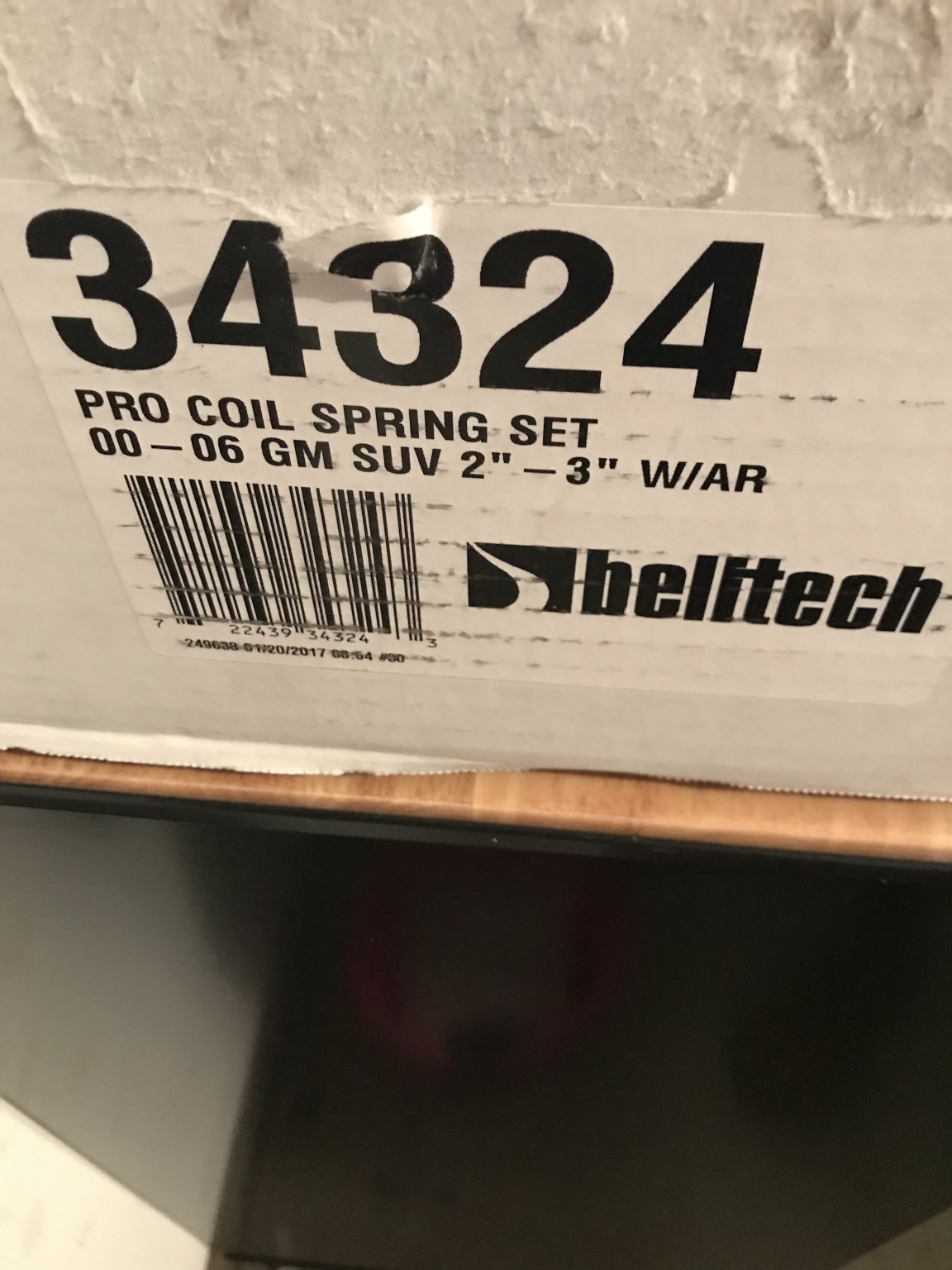

That could work.... is there anyway using the stock spring? Maybe getting a thinner isolator or something if they are that thick?
FYI Attached is the kit I have.

im trying to figure out why rode harsh but if you want only 1 inch of drop either the spacers or you can try the heater hose mod on stock springs and shorten the autoride rod

That box looks like its says its for 00-06 trucks...

00 to 17 it's all the same for springs
Thanks for all the help! I read somewhere you said the last generation has thinner shock issolators.... is that true? Will the fit on the 16 stock springs?

You can do what I did and ditch the Belltech rear springs and get McGaughy rear springs. Best move I ever made and I achieved the drop I wanted and no more of the driver side Belltech spring hitting the frame.
