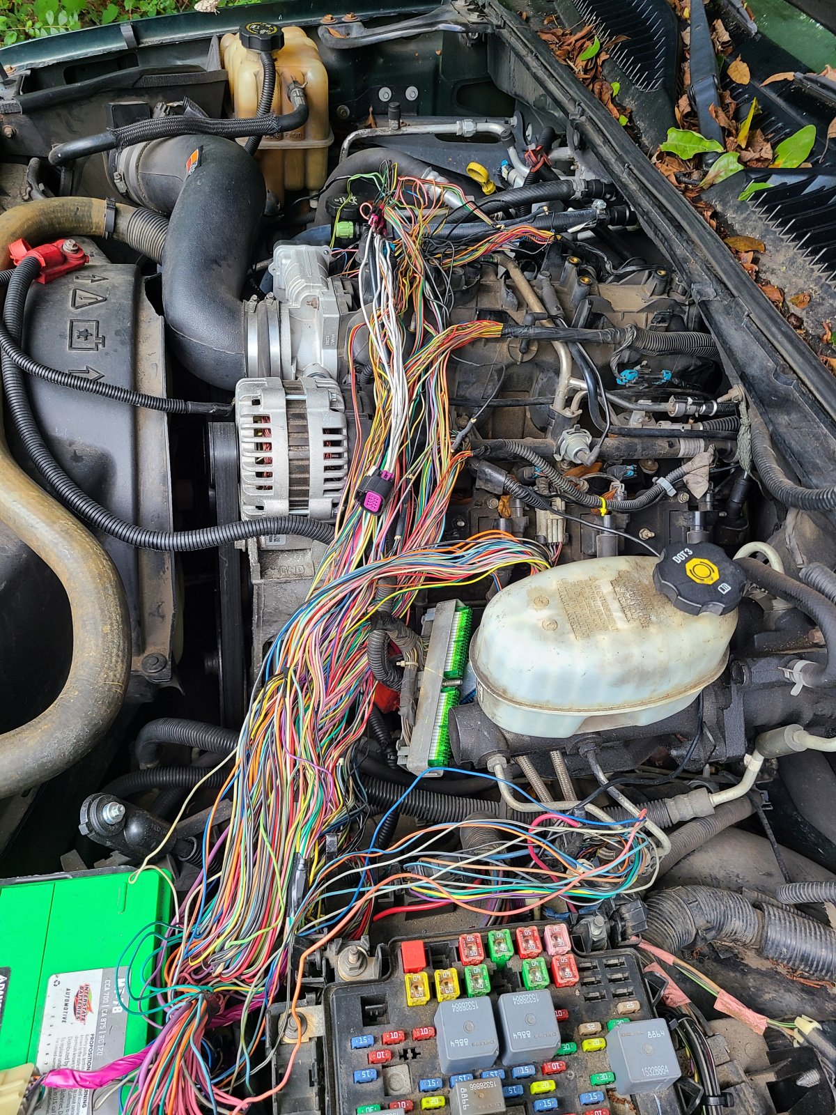

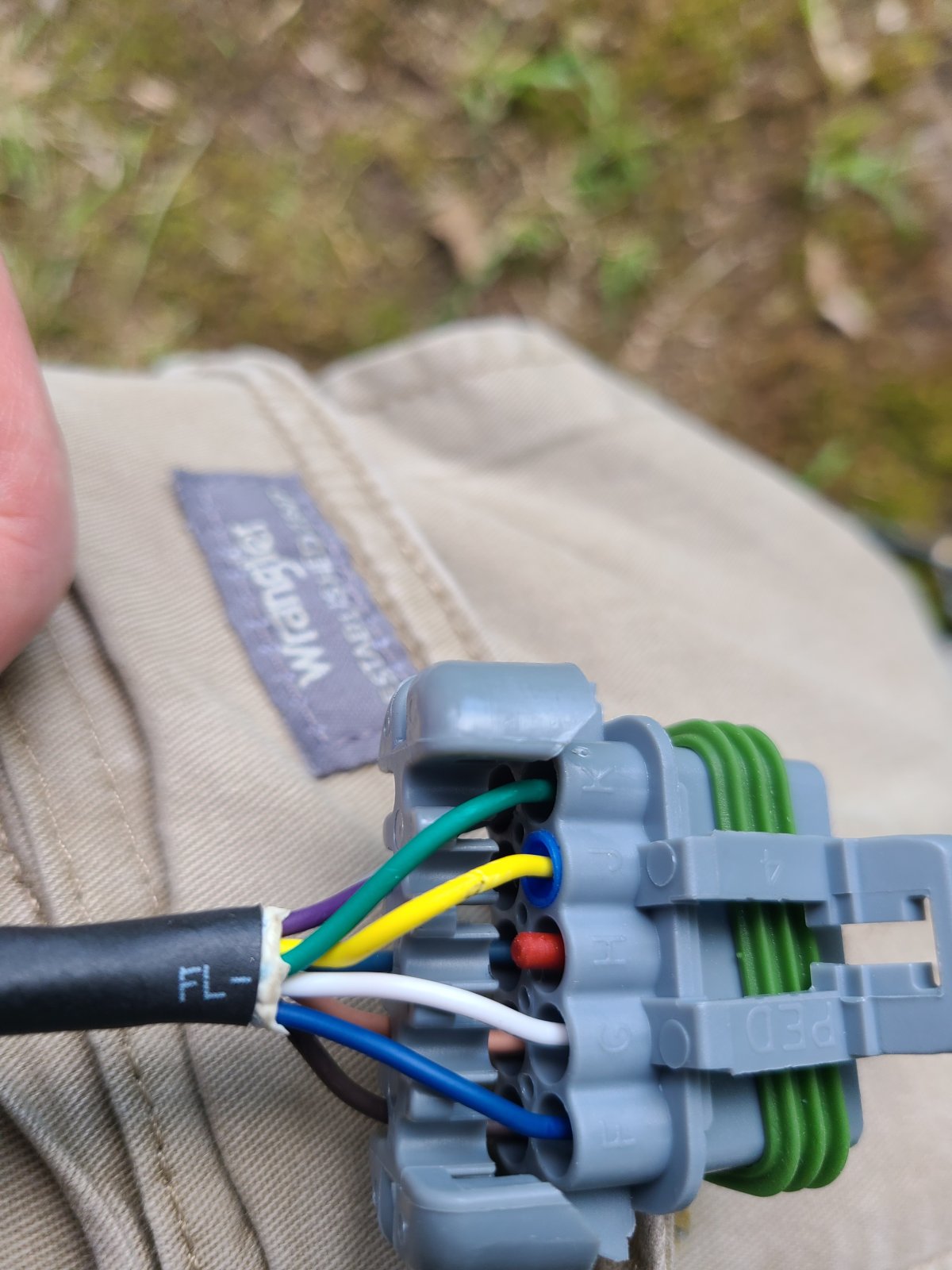

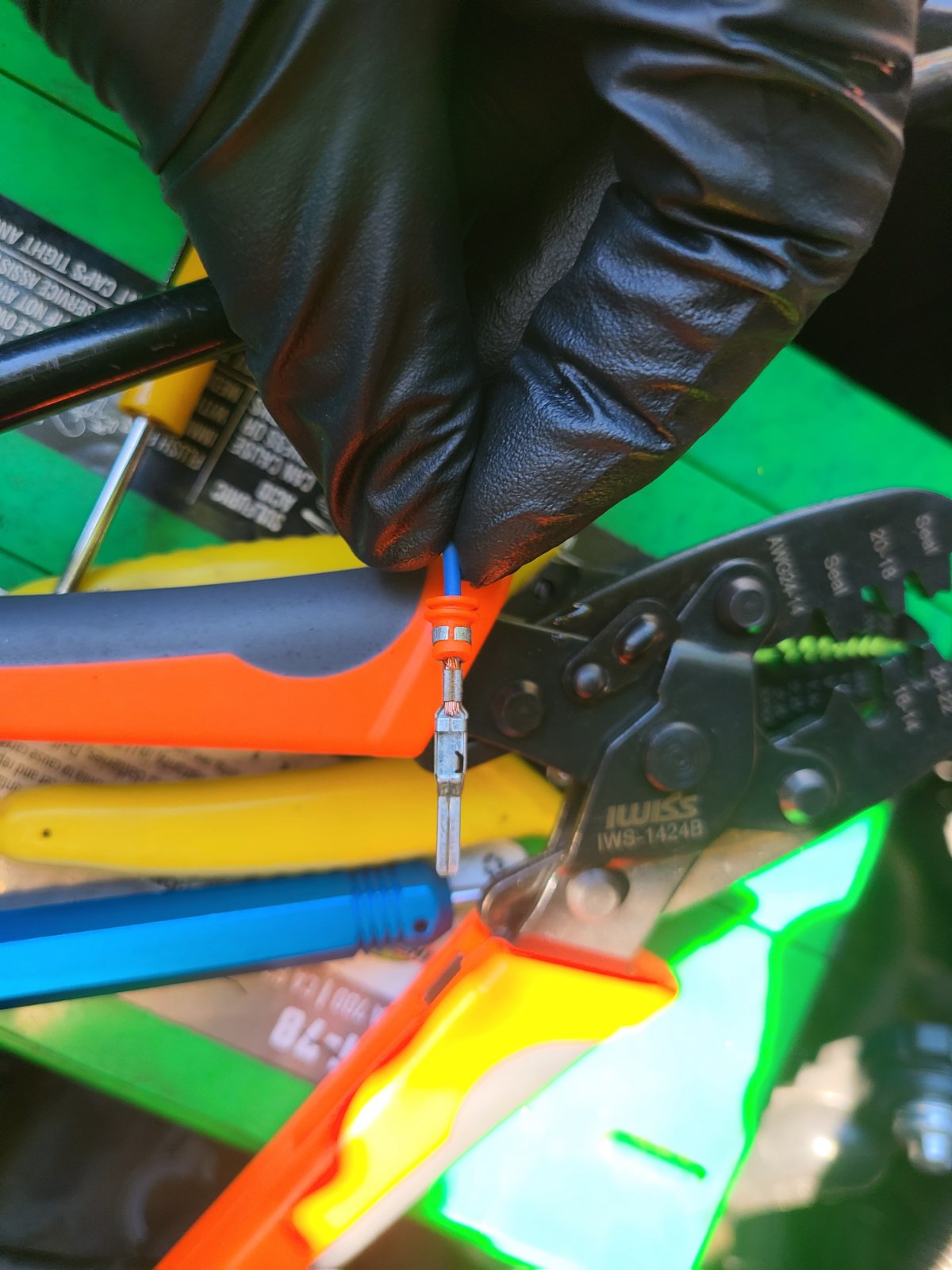

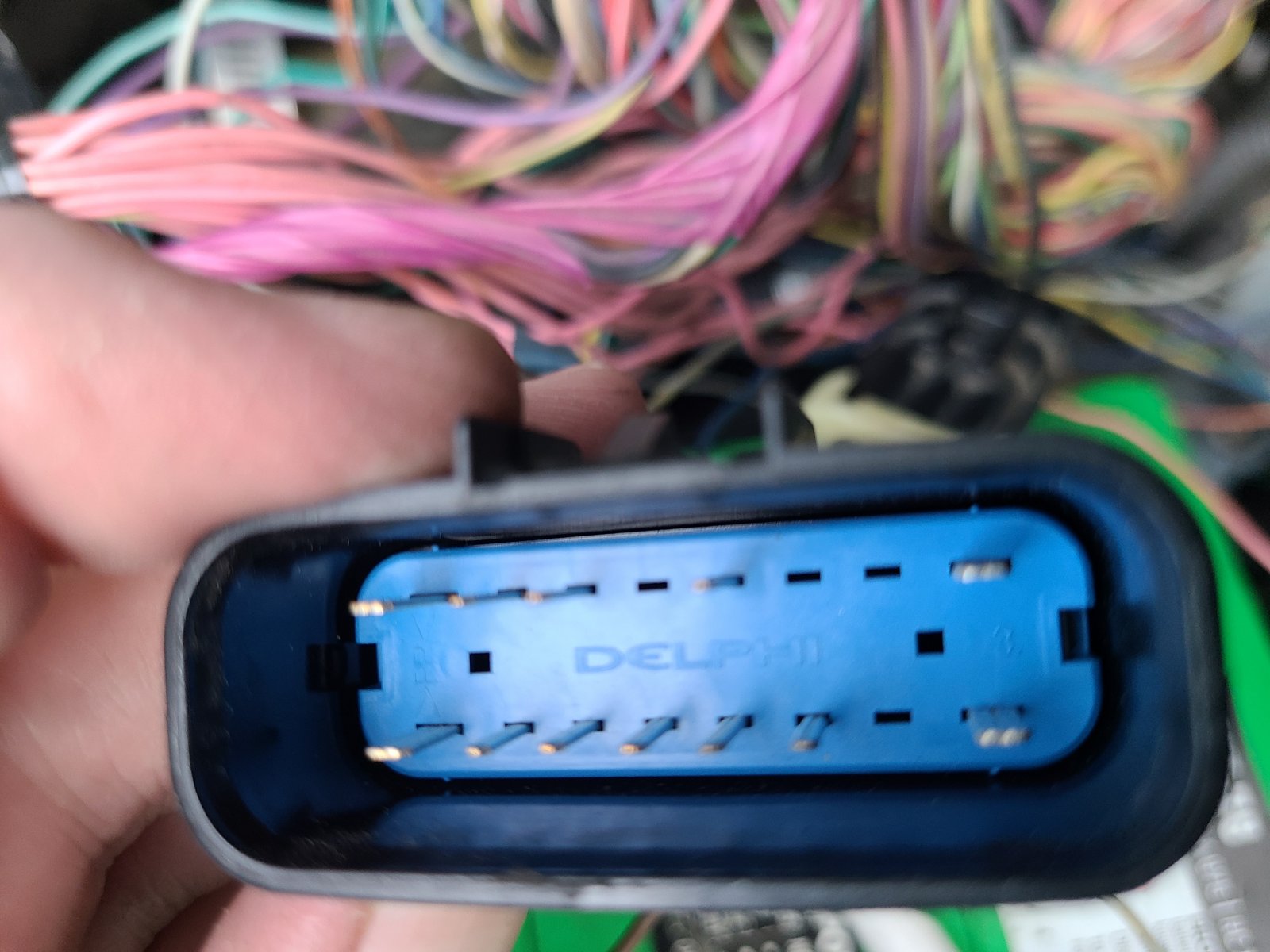

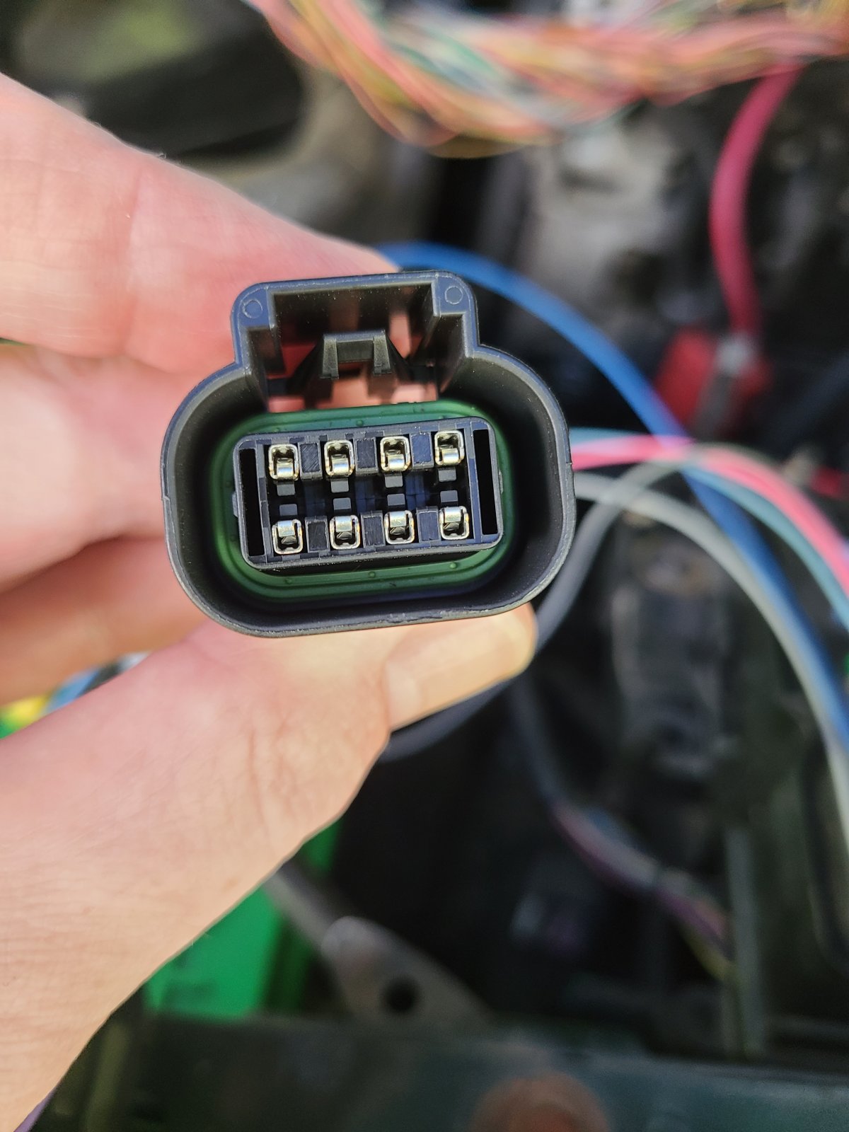

I am actually fighting this exact same problem almost verbatim to what you described.
I actually went further and replaced the entire 16 wire harness to the TAC with the proper Delphi pins and connector ends I got from EFi Connections. I also replaced the TAC to pedal harness as well with one they had pre-fabbed. I also got a refurbished PCM that was supposed to have the newest calibrations of which one was specifically for the P2135 voltage disagreement code.
I also redid the grounds like you said with new ends and heat shrink. I even opened the engine harness to install the 16 wire TAC module harness back like factory. I also bought the low adhesive wire harness tape. I also did new battery cables too.
I have even been re-pinning the PCM and the harness ends that plug into the underside of the fuse block.
I also just discovered I had an alternator that was overcharging my system for the past three years. I finally got that sorted by taking out back to Auto Zone and getting a Remy one that is now putting out the right volts. I also redid the connector that goes to my alternator with ends and terminals from EFI Connections.
It is the single most frustrating thing I have ever dealt with.
The weird part is that it began after I had my front right ABS wheel speed sensor replaced. Only the wire part that plugs into the wheel cylinder. It was broken when I got the truck making my ABS light stay on. It started with the P0220 first. Now almost three years later and all that work and I'm still getting P0220 and P2135. Sometimes together, sometimes not. Sometimes driving, sometimes when I crank up.
I just find it hard to believe that there is no solution when the truck went for almost three years before that without doing it.
I may unplug my wheel sensor again to see if it stops.
Please do post back if you find something and I will do the same.
I will look at the guide posted as well.
These are the pics of the new TAC to pedal harness and the new throttlebody plug end I made and picture of me crimping one of the new sealed terminals for the blue inline connector pictured. I had no idea they made so many terminals and crimp tools. And my engine harness all opened up !
I mean it definitely runs better now except for this God forsaken problem.
