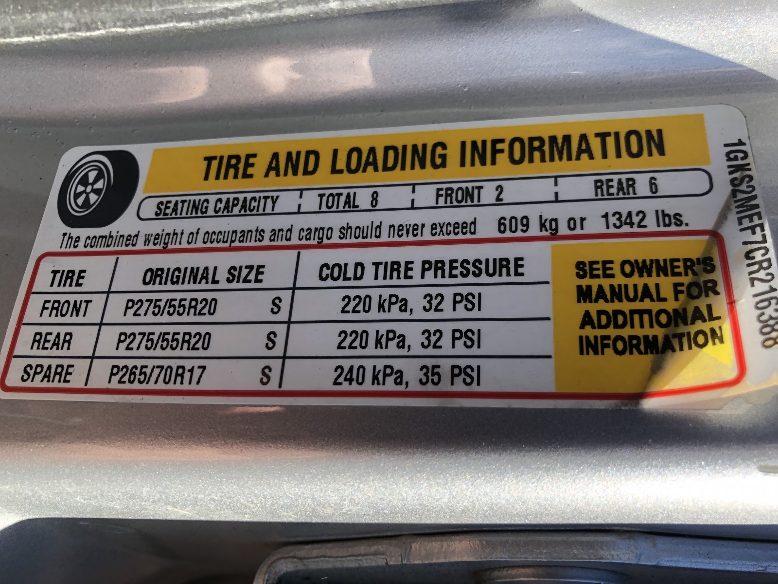

That payload on that sticker is goofy. It can seat 8, but not exceed 1342lbs, which means only 168lbs for each passenger. What if 6 passengers are 200lbs and 2 passengers are 125lbs, your overloading the vehicle by a bit over 100lbs. No luggage either. These trucks were designed for a bunch of skinny minnies, lol
