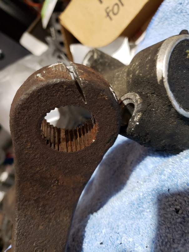

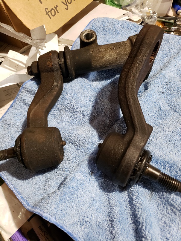

I changed out the Pitman arm, Idler arm and Idler arm bracket on my 2005 Yukon XL Denali 218k miles. I was going for the new year NH inspection and two places failed me because of Pitman/Idler arm play. I didn't agree, even with the wheel shake test, but I don't have any say in this... Either replace or don't drive it... a failed test for safety puts the truck in park apparently.
So, I ordered Moog HD parts, and replaced them. Not a fun job, but got it done with a little tool rental help from Autozone.
Now there is about one inch play in the steering wheel where there was none before. It used to drive straight and true with smooth turning. NOW it feels really weird. There is good feel and response at steering wheel during a turn, but the wheels feel as though their going to get away from me. Kinda hard to explain. Only to say that driving down a flat, straight road, I can move the wheel about an inch now without instant response.
What did I do wrong?
I used pickle fork for idler arm to center link and just pulled out the idler arm and bracket together. (reassembled new parts on bench to 80 ft lbs per Moog CC agent). Used pickle fork again on Pitman arm to center link. Used Pitman Arm Puller, but had to cut a line in old part to free up from steering box shaft (didn't damage splines as I only went about 90% through ). I did have to use an air hammer with chisel briefly in that cut groove to free up enough for Puller to work. Perhaps that action shook too much and damaged something inside Steering Box??
Also, Inner and Outer Tie Rods replaced with Moog about six months ago. No leaks and seem tight. There doesn't appear to be any real wheel movement when testing on jack stands.
Any suggestions would be appreciated.
Thanks!

I assume you jacked up the front end and grabbed a tire and checked for play based on your last sentence. If no play is present, it has to be in the box, shaft or column.
I have cut into the steering box output shaft in the past on several occasions without any issues other than paranoia lol.

I would put it on the ground and have someone turn the steering wheel while I looked at the steering linkage to see where the movement is. You may have damaged the bearings in the steering box. If so I would think it would be leaking fluid out. The new part could be bad.

Gear box usually has play in it by the time the pitman arm requires replacement, I always adjust the gear when doing a pitman arm.

This happened to me too. I damaged my steering gear when pounding a pickle fork in my pitmanarm with a mini sledge since a 2/3 jaw puller wouldn't fit. My steering gear had 265k and was getting stiff anyways. New reman AC Delco gear and its like brand new.

There was now a clunk and I could move the sector shaft back and forth with my hand after beating with the mini sledge. Steering was getting pretty sloppy even before than, afterwards it was much worse. I still have the rattle sound with slow turns from worn intermediate shaft and bearing in the steering column.
