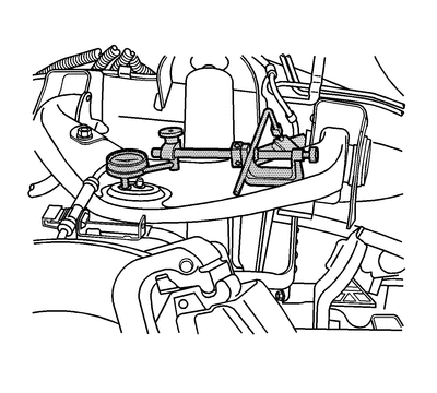

Ball Joint Inspection (Lower Ball Joint)
Special Tools
J 8001 Dial Indicator Set
    Click to Enlarge
  2. Raise and support the vehicle. Refer to Lifting and Jacking the Vehicle.
  3. With the wheel and tire on the vehicle, lift the suspension corner by hand to determine if any looseness is present. If vertical free play is experienced proceed with the following instructions.
  4. Remove the wheel and tire. Refer to Tire and Wheel Removal and Installation.
  5. Clean and inspect the ball joint seals for cuts or tears. If the ball joint seals are damaged, replace the ball joint. Refer to Lower Control Arm Ball Joint Replacement (Coil Spring Suspension) | Lower Control Arm Ball Joint Replacement (Torsion Bar Suspension).
  6. Install and position the dial indicator from J 8001 Dial Indicator Set against the end of the ball joint.
  7. NOTE
    Important
    Do not pry between the lower arm and the wheel drive shaft boot or in such a manner that the ball joint seal is contacted. Damage to the wheel drive shaft boot will result (4WD).
    Gently lift or pry the suspension upward then let it settle.
  8. The dial indicator reading should be no more than 2 mm (0.079 in). If the reading is out of specification, replace the ball joint.

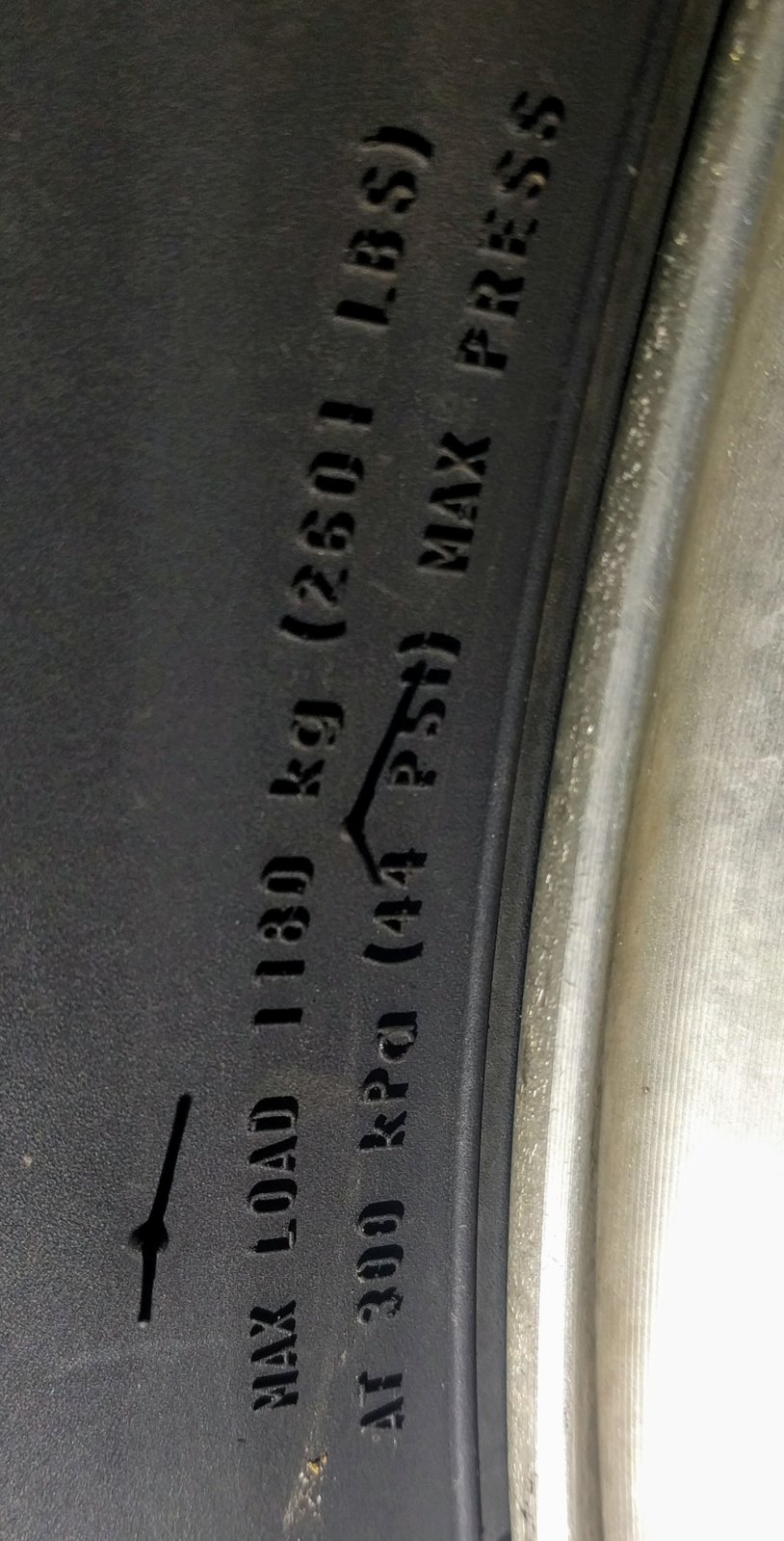

I may need to experiment with tire pressure! I know that there’s a lot of debate on what pressure to set tires at, the Yukon says 32 psi with the Stock tire size but the Firestone Destination ATs I have on it are taller and narrower than the stock tire! So the contact patch is smaller! The tire says 44 psi now I remember in Tech school that the pressure difference is due to the amount of sq inches of contact with the road the larger the contact the less pressure is needed to support the load! Vise versa, I have had many say to use the sticker # 32 psi regardless of the tire but I think this is only if it’s the same dimension tire? It does seem to handle better with say 38 psi than 32 psi I’m just afraid of ruining a $900 set to tires running them to high or low, the tread on The Destination AT is semi aggressive I’m going to post a few photos of the tires and specs to this message in a reply I can’t do it with the device I’m using right now
K
KR66
Sep 17, 2017
97
16

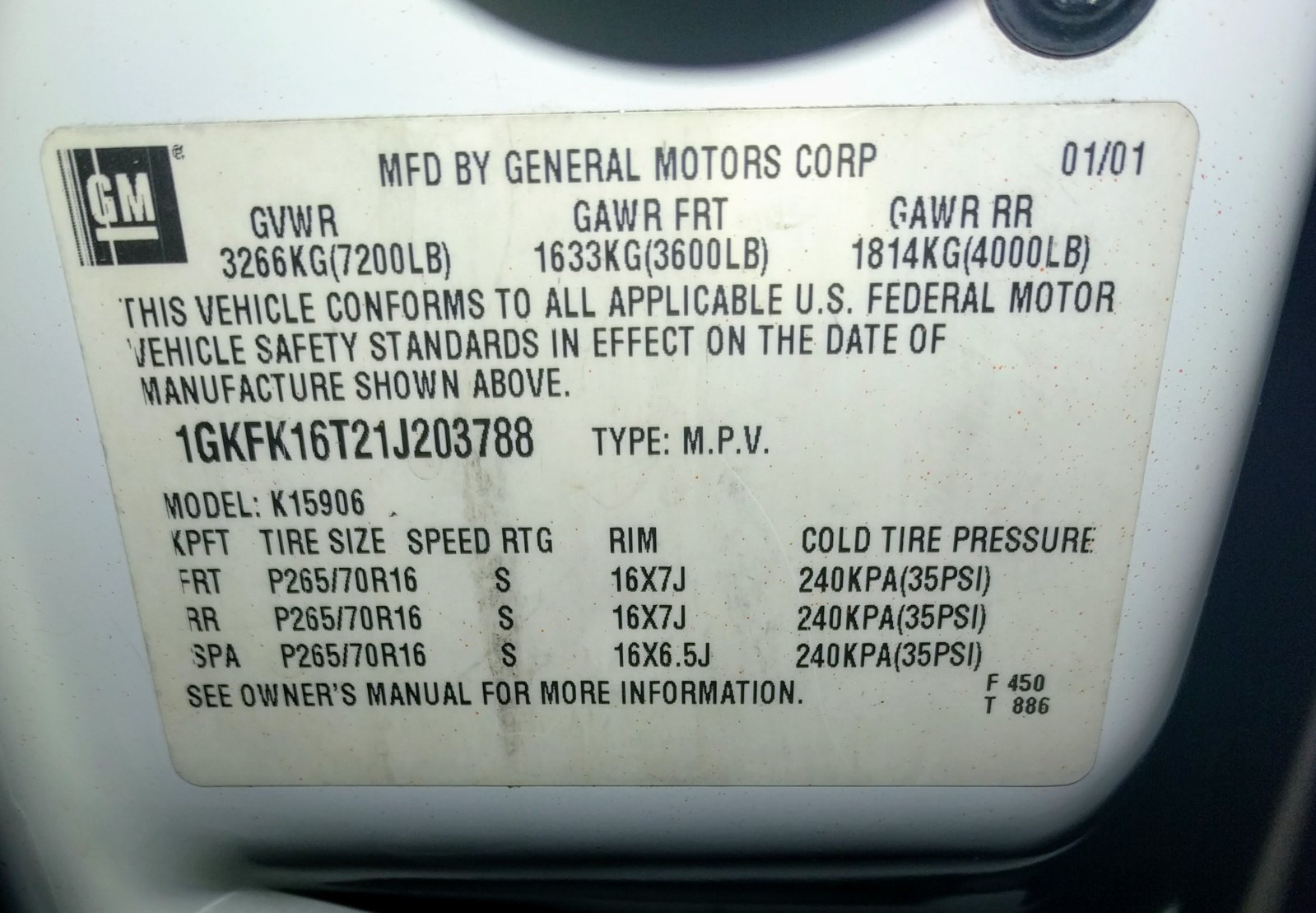

as you can see the factory size is supposed to be a 70 series tire and I have 75 series on it so the tire is a bit skinnier than the stock needing a bit more air to hold the same weight. The tread is little aggressive but not to extreme ( I like it because they stick and handle rain and snow really well! Almost impossible to trigger the abs in a panic stop (on dry pavement) I think they may grab as well as Michelin's) you can see all the new parts underneath it was all replaced between 12/17 and 5/18 (tires, shocks, tie rods, pitman, idler, bushings, Timkin hubs, etc)

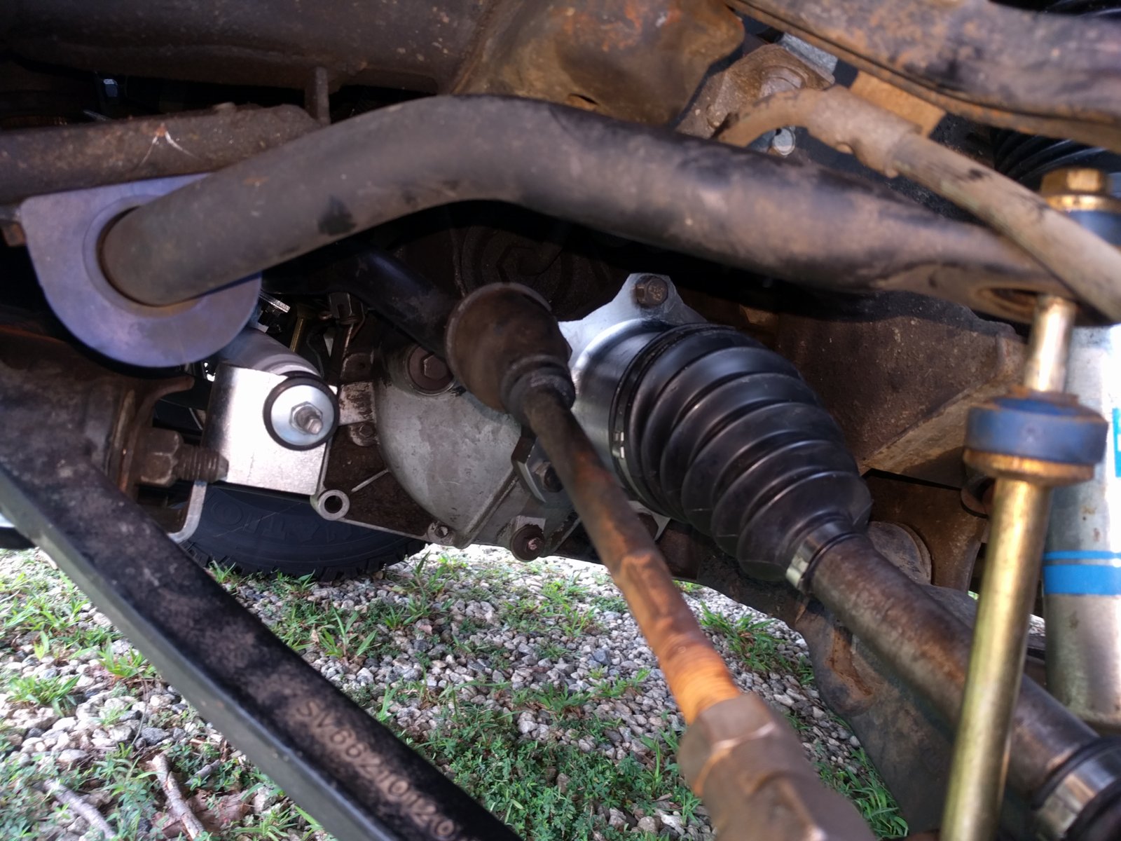

Are these the links you're talking about?
I think it's called the center Link unless they renamed them since I went to aito Tech school back in the 80s? I had never heard it called that before.

Looks like there's a few different names for it. The relay rod/center link is a long rod that runs the width of the vehicle, and bolt directly to the pitman arm and idler arm, and on the end of that your tie rods thread into it. Based on that picture you just sent, yours looks oriented correctly. So there goes my theory.
Not sure if you were in the middle of a project when you took that pic, but the stabilizer bar link (or sway bar link) looks like it's missing something or loose maybe. The brass colored bolt with the blue bushings in the right of the pic... it should be tight on the stabilizer bar. Sway bar... whatever you wanna call it.

It was disconnected I was changing the CV axle as you can see almost everything is new! I even put a steering stabilizer on it! That made no difference at all so I'm starting to worrie that it might have a cracked frame or something that I don't see yet causing the drift? It sometimes handles right like something went back into alignment? So the search continues
