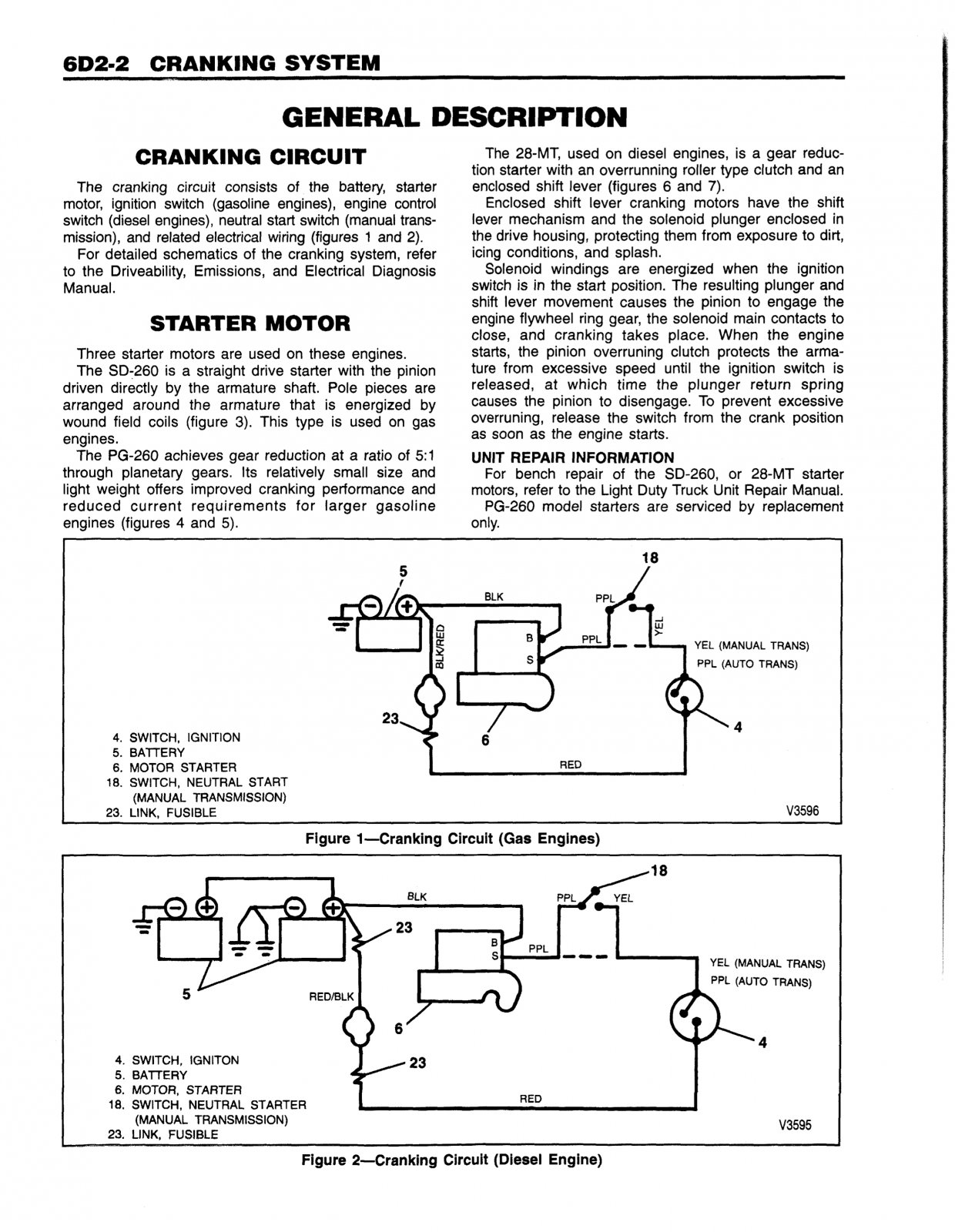

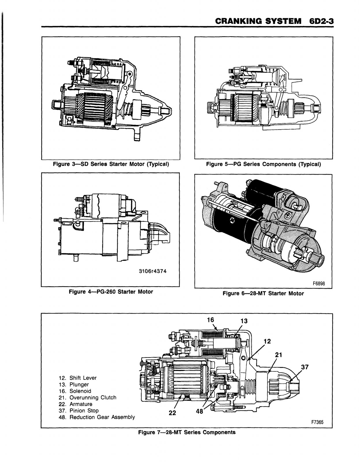

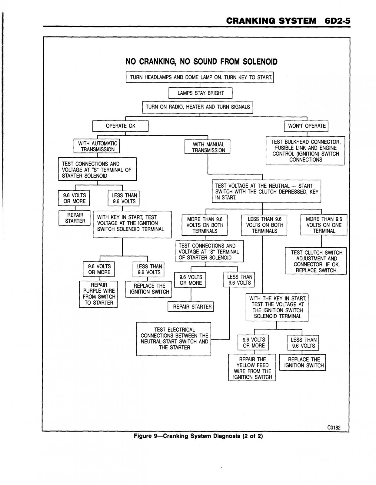

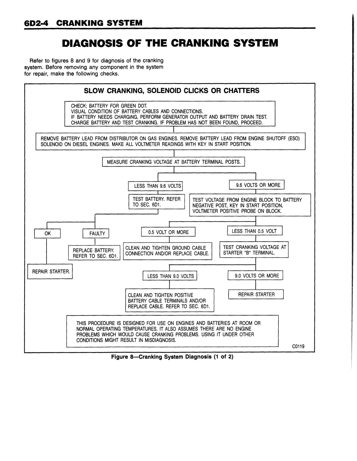

my tahoe is a 95 the transition year so TBI but the rounded interior every thing i look up says it should have a start relay... i have not found said start relay. so is it wired like a 88-94 where it just sends the ignition switch wire right to the S terminal on the starter?
The 95 service manual (attached) does not show a relay. For comparison, a 98 starter relay is in the fuse panel.
PDFs of the 1995 service manual volumes can be downloaded at this link:
