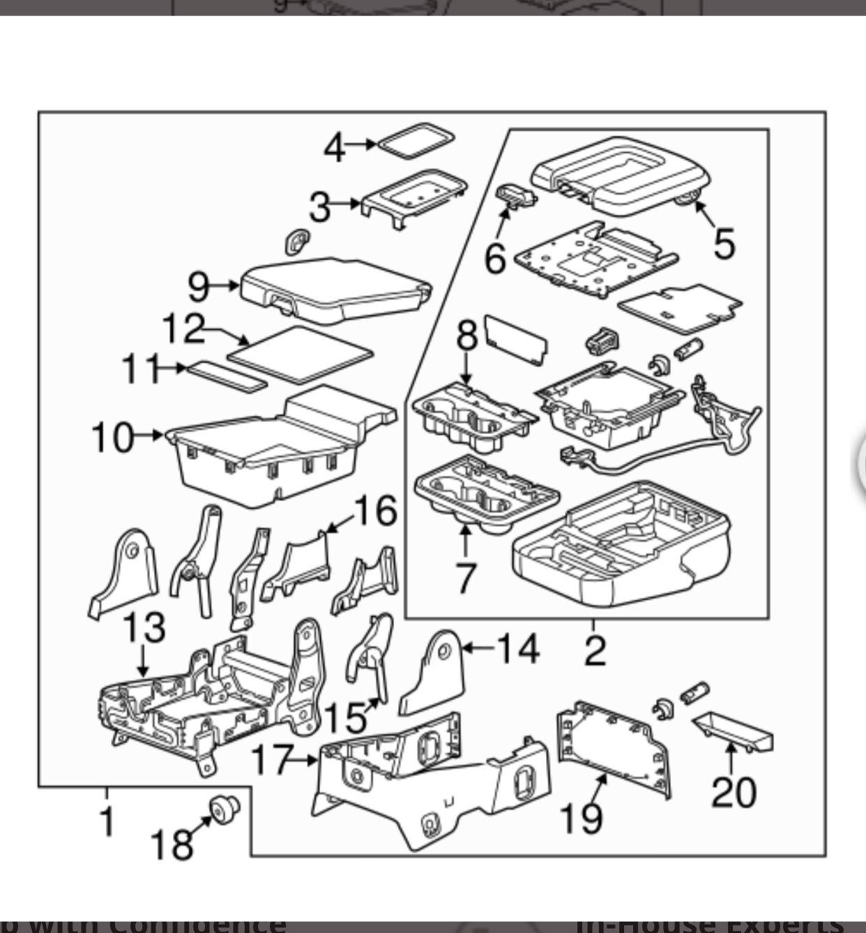

Post a picture of the console? There is no visible damage or anything to see. If you don't have a helpful response, please just continue your browsing...
PG01
Nov 6, 2016
15,686
21,099
Up here to the right
Hey man, just trying to help. Lighten up Francis...
If you put a pic i can see what it looks like and tell you what to take apart, most trucks have a reg console and not everyone knows what the foldable armrest looks like... here... google works bud

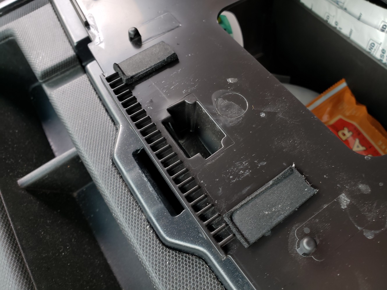

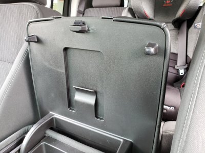

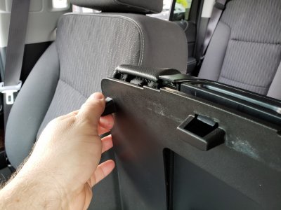

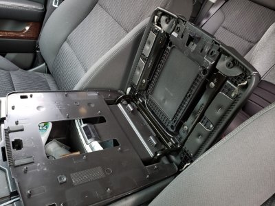

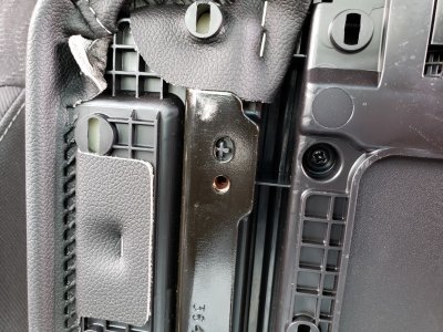

Finally got rid of the squeak. The underside of the console lid comes off quite easily with no tools. As shown in the picture, you can just pull it apart (I used the little stubby support legs to get started) and then slide your finger in between and down the edge to pull the clips apart. I then placed a few pieces of adhesive foam strips where the noise seemed to be coming from. Voila!
P.S. I also noticed one of the screws inside was missing, but I haven't noticed any issues from that part of the console lid, and decided to just leave it.

Glad you got it sorted out. Adhesive foam is the duct tape of interior trim panels.
