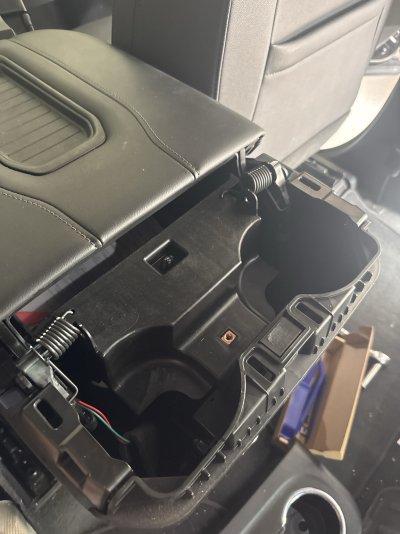

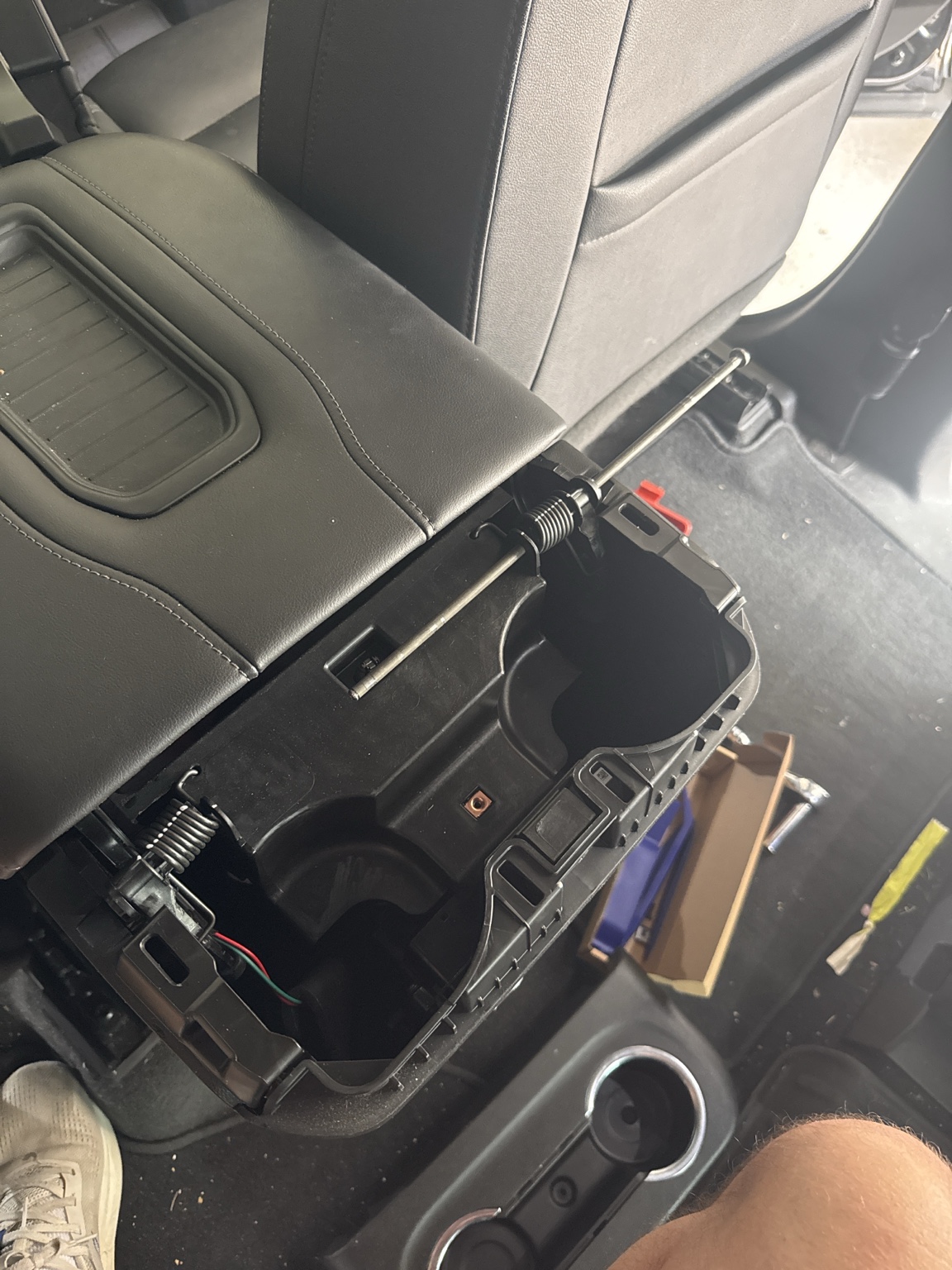

Step 1: Remove the rear cupholder / rear console trim​
Start by opening the center console lid. The rear cupholder/trim section behind the console needs to be removed to expose the hinge area. Remove the cup holder padding then the screw below (torque head screw).
Use a plastic trim tool and carefully pop the rear cupholder/trim panel loose. Work slowly so you do not break the plastic clips.
Once removed, the hinge mechanism will be visible.

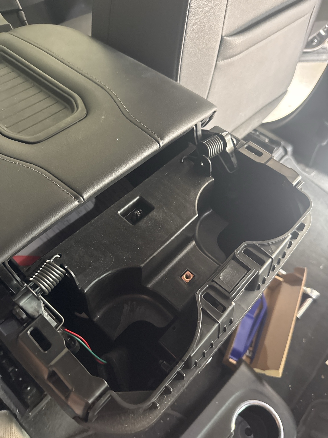

Step 2: Expose and inspect the hinge assembly​
With the rear trim removed, you will see the actual hinge setup.

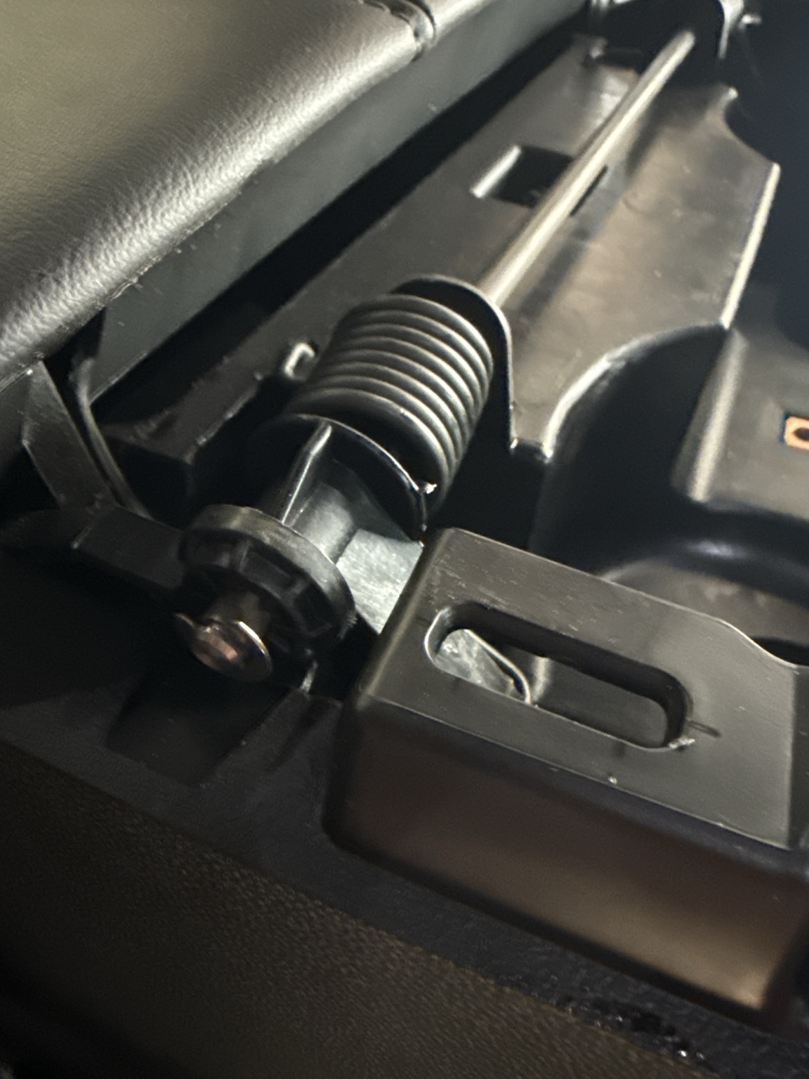

The armrest lid is held in place by:
  • One long silver hinge rod/pin running across the width of the console
  • Two torsion springs, one on each side
  • Push-on retaining clips/washers at the ends of the hinge rod
  • An electrical wire/plug routed down through the hinge area
The springs are under tension, so do not just pull the rod out quickly.

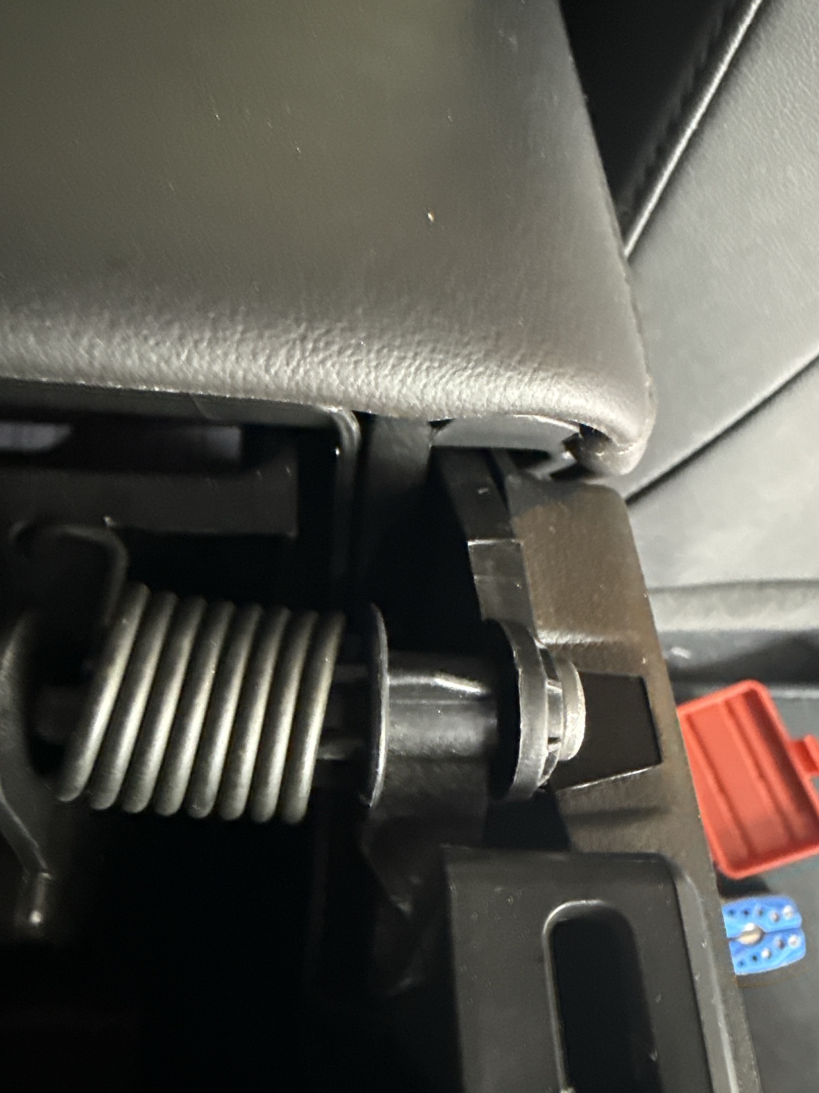

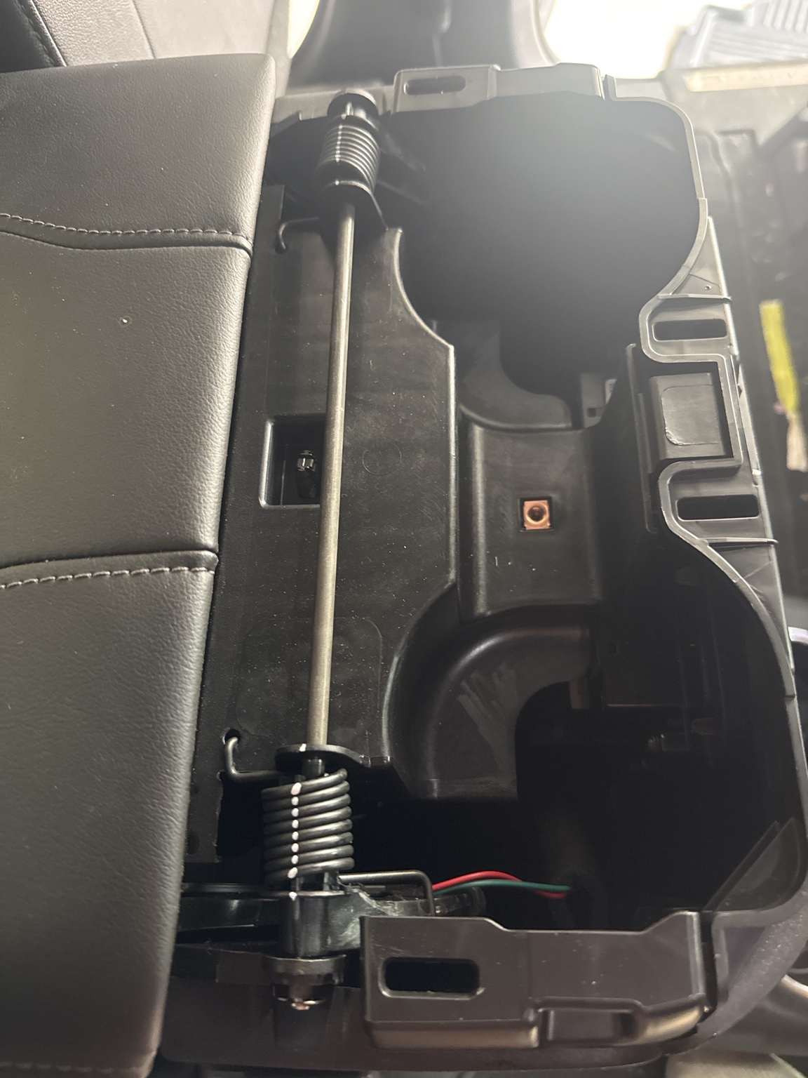

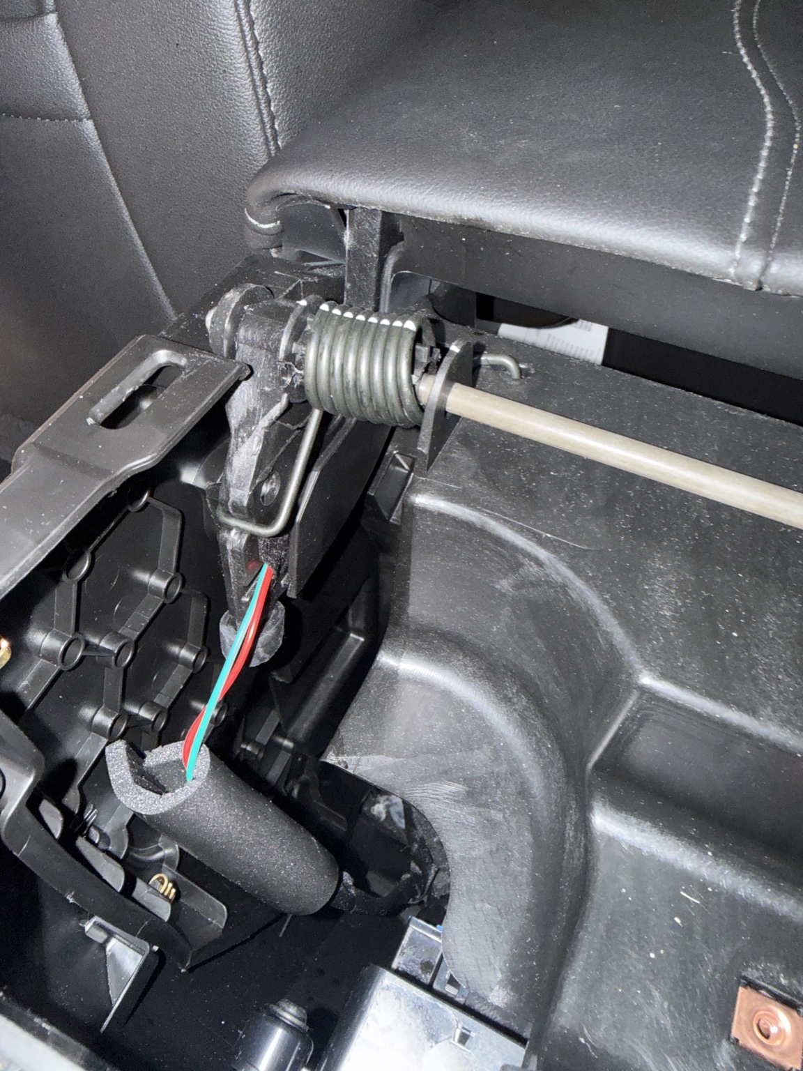

Step 3: Mark the spring orientation​
Before removing anything, take clear photos of both springs from multiple angles.
I also used a paint marker to mark the springs and their position. This helped me know how the springs were clocked before removal.
Pay close attention to the spring “tails.” These are the long ends of the spring that hook into the plastic bracket and create the lid tension. The spring tails must go back into the same locations during reassembly.

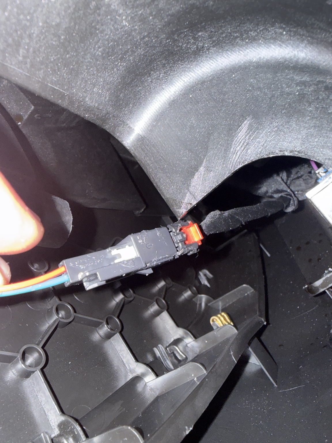

Step 4: Find and unplug the electrical connector​
There is a red/green wire pair coming from the lid and going down through the hinge area into the console. This wire must be unplugged before the lid can be removed.
Follow the wire down into the console until you find the connector.
The connector may have a red safety lock on it. To unplug it:
  1. Push the connector halves together first to release pressure.
  2. Move or slide the red lock slightly.
  3. Press the release tab/latch.
  4. Pull the connector apart by holding the plastic connector body.
Do not pull on the wires.
Once unplugged, feed the connector/wire back up so it will come out with the old lid.
Step 5: Remove the retaining clip from the hinge rod​
Look at the ends of the long silver hinge rod. There should be a small push-on retaining washer/clip on at least one side.
Use a small screwdriver, pick, or needle-nose pliers to carefully remove the retaining clip. It may bend during removal. These clips are meant to grip tightly.
Be careful not to lose it.

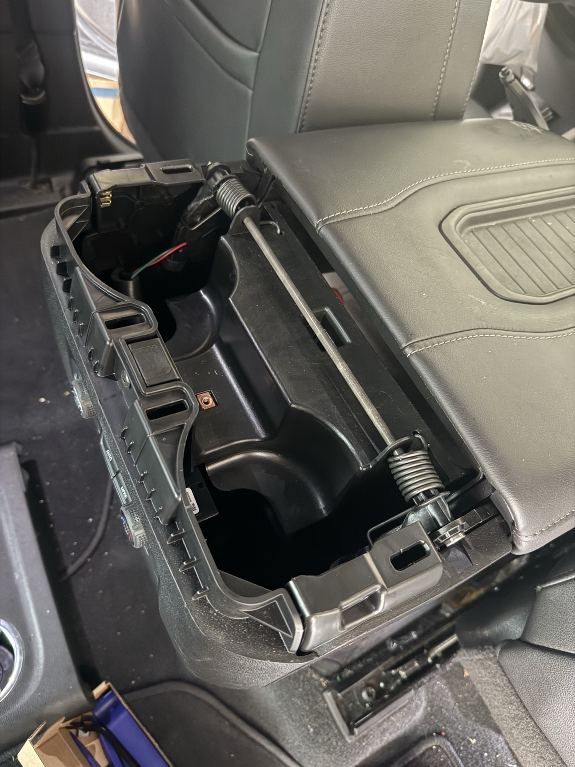

Step 6: Slide the hinge rod out slowly​
Support the console lid while doing this. A second person helps.
Slide the hinge rod out slowly from one side. Do not yank it out.
As the rod begins to clear the first spring, hold the spring with your hand or needle-nose pliers so it does not unwind or fall out unexpectedly.
Remove one spring at a time and keep everything laid out in the same order it came off.

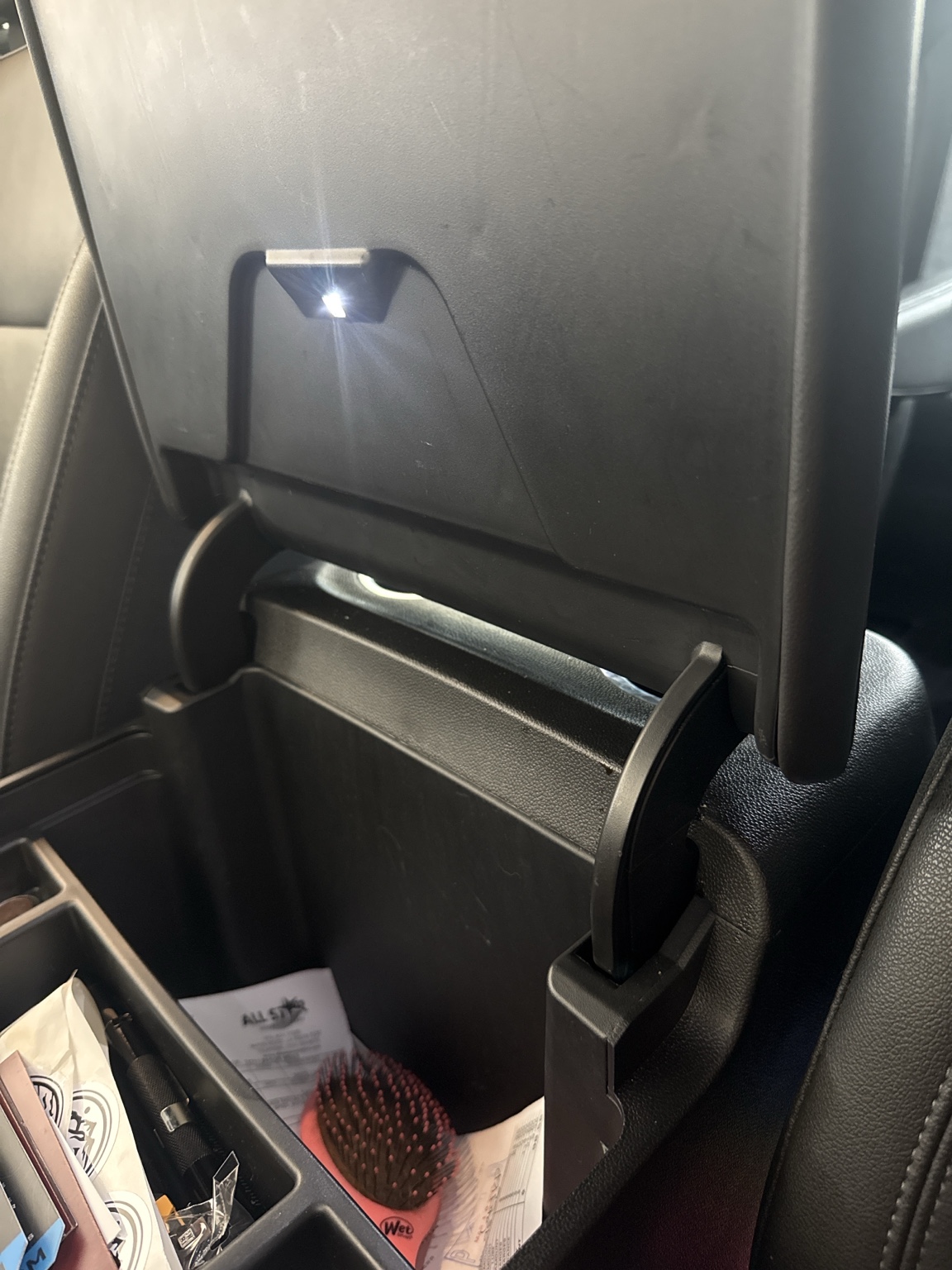

Step 7: Remove the old armrest lid​
Once the hinge rod has been slid out far enough and the springs are released, the old armrest lid can be lifted out.
Make sure the electrical wire is fully free and not caught on anything.

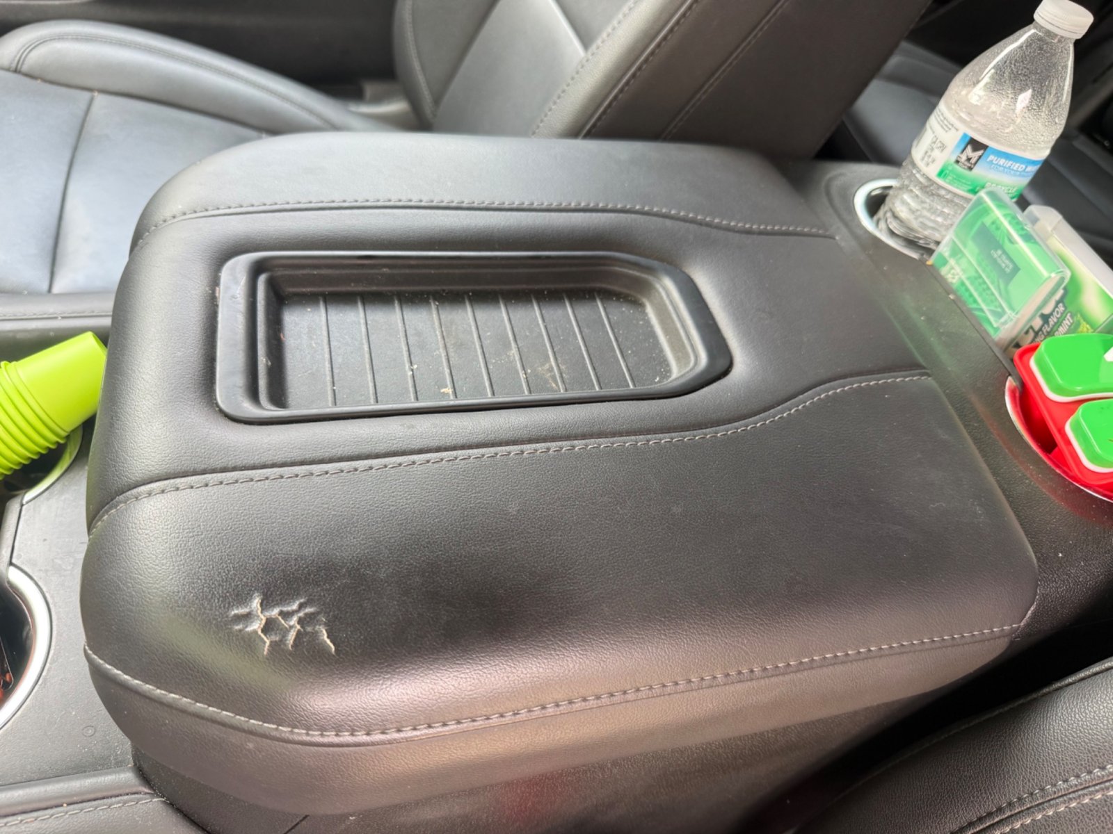

If your new lid does not have the rubber insert/tray on top, transfer it from the old lid.

Start feeding the hinge rod back through the hinge pockets. Reinstall the springs in the same orientation as they came out.
This is the tricky part. The spring tails must hook back into the same plastic notches/brackets as before.
Go slowly:
  1. Start the hinge rod through one side.
  2. Install the first spring in the correct orientation.
  3. Continue sliding the rod through the lid hinge.
  4. Install the second spring.
  5. Push the rod fully into place.
  6. Reinstall the retaining clip/washer.
