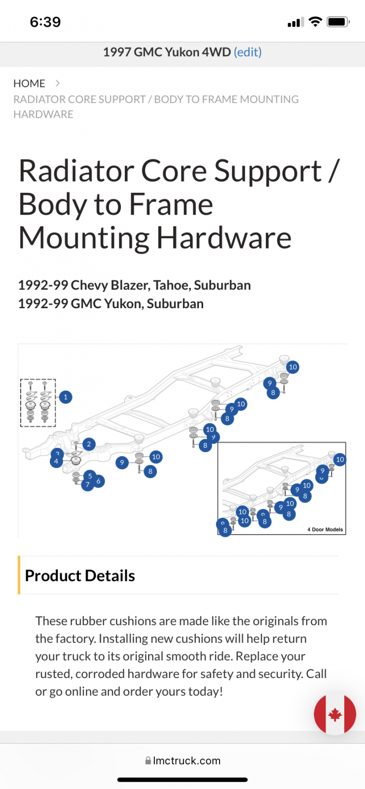

You can order the rubber body mounts from LMC Truck. I would highly recommend buying the hardware as well
