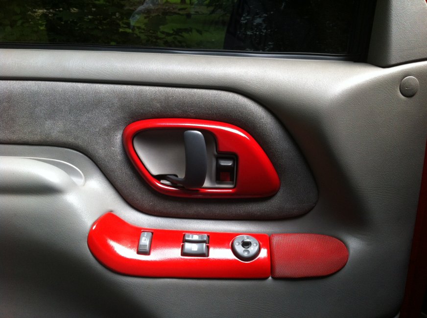

I've had the whole handle off before. It's a pain in the ass getting linkages on there. Doable though.
bowtiefreak
No Quarter
Apr 30, 2009
5,404
101
Near Philly
thanks. A little sanding then rattle can. Simple. Hardest part is getting the switches out
