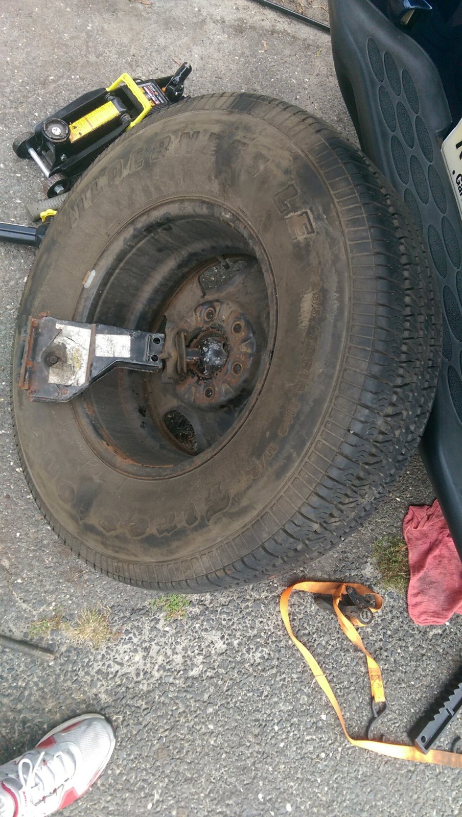

Pretty common it seems, Mine is also stuck. I have to manually go down there and have someone turn that cable while I wiggle it to come down with care. I dont even carry a spare down there anymore because of this, I just throw it in the rear.
33,186
51,406

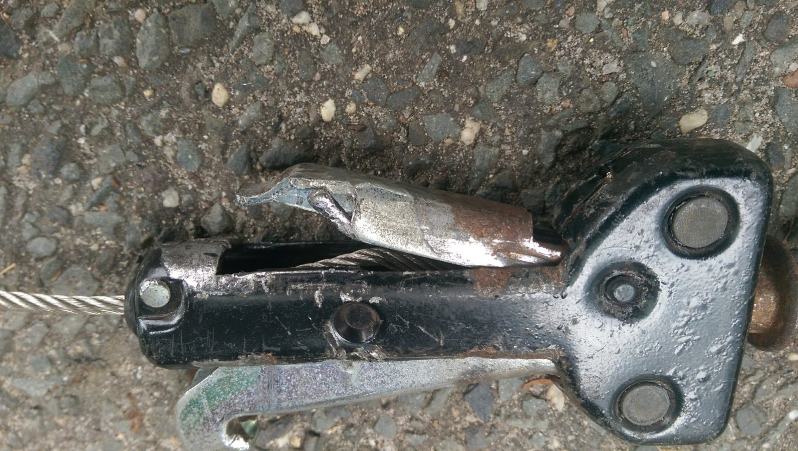

I couldn't get mine down either but I was able to get an extension and socket to the bolts holding the spare tire mechanism to the truck, so I was able to drop the whole thing down and work on it that way. Just another option. That's the mechanism in the pic.
