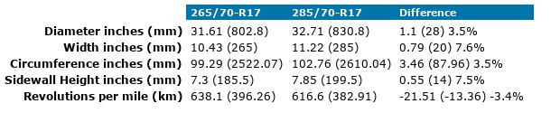

I am planning on installing a leveling kit and upgrading to some Cooper LT285/70/17s next month. I have a 2005 Z71 Tahoe with the original stock spare tire. I want to replace the spare but wanted some advice. Does it make sense to purchase a stock size (265/70/17) to keep as a spare that way the vehicle has stock size if I ever sell or or give it to my dad and he takes the kit/big tires off down the road? If I had a blowout and had to use the spare, is it a big deal to drive a few miles to get a replacement while on mismatched sized tires? (This answer may vary depending on if it front or rear blowout)

I`d just get a cheap tire of the same size. If you ever had to put the 265 spare on the rear and you had a locker even over a short distance it could hurt it.
There`s not a huge difference between the 265 and 285 but i wouldn`t take the chance.
