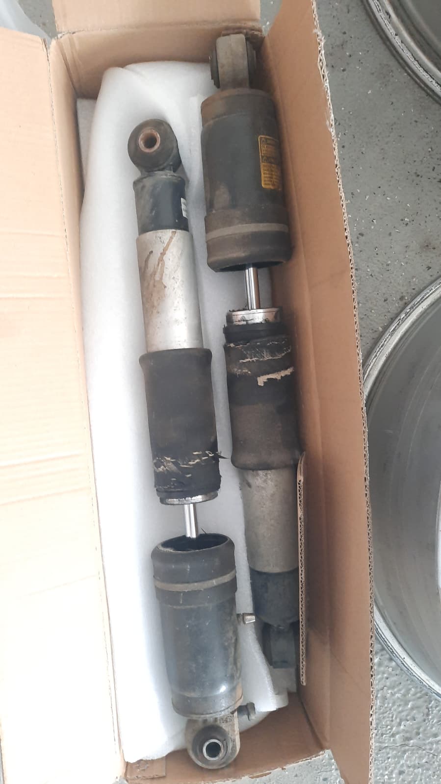

When I take a look at the old shocks....the compressor might had a lot of work ;)

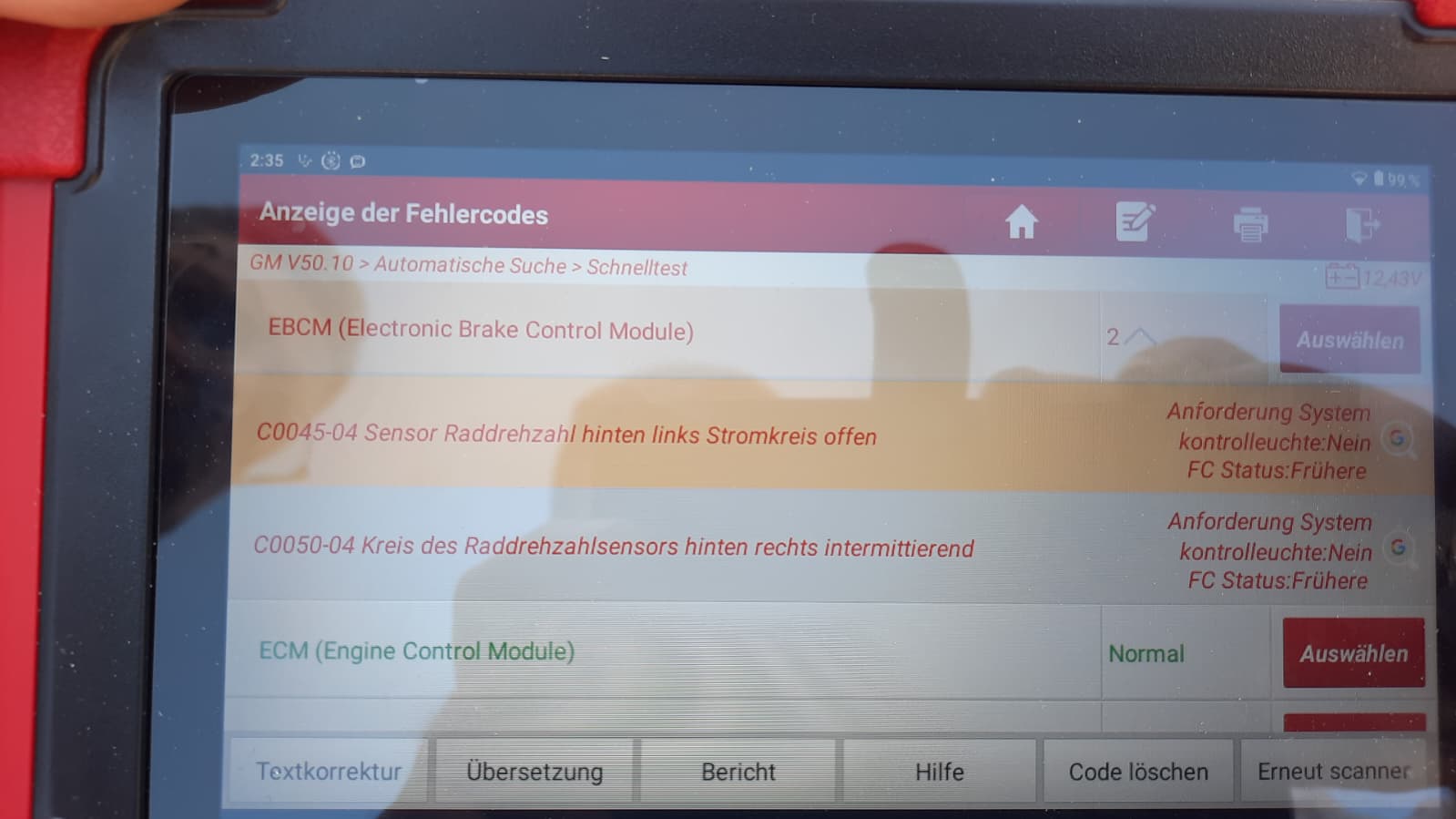

...and here is what my OBD says:

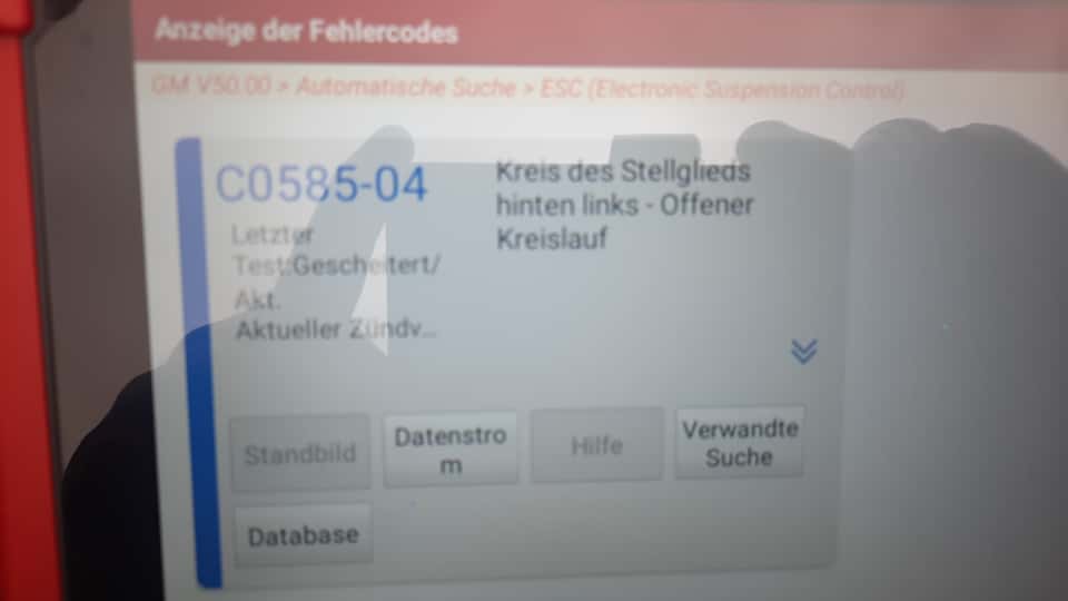

Sorry for delay! It took a while to find someone with a tech 2 Scanner thats decent enough for this.
Today was the day:
The error code says C0585-04 (left rear actuator circuit open).
So thats another wire-check-day for me next weekend...At least now I know where to look.

According to Dr. Google, and I think that the troubleshooting steps sequence make sense.:
GM C0585-04 indicates a fault in the Left Rear Suspension Control Actuator Circuit, likely due to a wiring issue, damaged connector, or a faulty suspension damper itself. To troubleshoot, first inspect the left rear suspension wiring and connectors for damage or corrosion, then test the suspension damper's resistance. If the wiring is good, the problem is likely a faulty damper, which will need to be replaced.
1. Inspect the Wiring Harness and Connectors:
  • Examine for Damage: Thoroughly inspect the wiring harness connected to the left rear suspension damper for any signs of rubbing, pinching, or corrosion.
  • Check for Corrosion: Pay close attention to the electrical connectors for green corrosion, as this can indicate a poor connection.
  • Verify Connections: Ensure that the connectors are fully seated and not loose or damaged.
2. Test the Suspension Damper (Shock Absorber):
  • Measure Resistance:
    With the ignition OFF, disconnect the harness connector from the left rear suspension damper.
  • Test the Damper:
    Using a multimeter, test the resistance of the damper between its control terminals.
  • Compare to Specs:
    Compare the measured resistance to the specified range for your vehicle (refer to the vehicle's service manual, as this range can vary). If the resistance is not within the specified range, the damper is faulty and needs replacement.
3. Swap Connectors (If Necessary):
  • Identify the Issue:
    If the wiring and damper resistance appear normal, you can perform a diagnostic test by swapping the left rear connector with the connector from the opposite side rear shock.
  • Check for Fault:
    Clear the DTC and see if the code follows the connector to the other side. If the code now indicates the right rear shock, the connector itself is faulty and needs to be replaced.
4. Replace Faulty Components:
  • Replace Damper: If testing confirms a faulty damper, replace it with a new one.
  • Repair Wiring: If the wiring is damaged, repair or replace the damaged sections of the harness.
5. Clear and Re-Test:
  • Clear the Code: After completing repairs, use a scan tool to clear the trouble codes.
  • Verify the Repair: Drive the vehicle to see if the code returns, ensuring the system is functioning correctly and the suspension warning light is off.

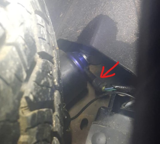

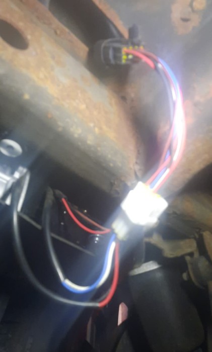

I was in hospital due to a intestinal obstruction...still not on top, but home again and I checked the wiring and the connectors. Everything looks fine. Also put some electric grease to every connector.
The wire that causes all the trouble should be the one in photo 1. That wire goes directly to a harness that goes to the front.
So I can´t swap the connectors to see if the error code goes to the other side. :(
Fram that harness there is a connector coming out that goes to the compressor (Photo 2, just routed it outside the frame just for the photo).
Next step yould be to measure the resistance of the damper. But I don´t know what would be the correct resistance...
