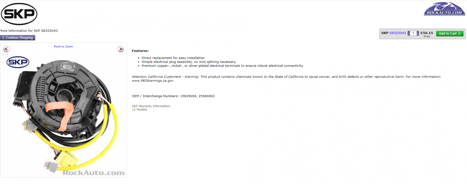

Today I replaced the clockspring on my 07 LTZ (with steering wheel controls & cruise control).
Replacing the clockspring went perfectly, and I now no longer have an airbag light - fantastic!
What is less fantastic is that I now have non-functioning steering wheel controls. Both left and right.
This is the clockspring I bought: SKP SK525043
- Ive already re-removed the wheel and checked the connections, they look fine.
- Have I bought the correct clockspring?
- Chances of a defective part?
- Is there a fuse I can check for the steering cotrols?
- Any other tips or advice?
Thanks a lot in advance :)

Put a GM OEM clock spring in there and see if that solves the problem. I know it’s 3x the cost of the SKP part, but it’s been hit and miss for me with SKP stuff.

did you make sure that it was the correct one needed?
for instance if you bought one and it was for a lower trim level say lt and you have a ltz then the controls may not work
if you got the correct one the only thing I can think if is to check if one of the pins is not seated correctly or something of that nature.

I ordered the one pictured above. It said for models with cruise control... There were no further distinctions on RockAuto...
All the cables plugged in and it looked the same as the old part.

The one he bought is listed for the LTZ trim on RockAuto but they have been known to be wrong.
30,699
48,338
Thanks
I looked on rockauto website and see what you mean, I would verify the oem part number used. it may be on the old one which makes it quick and easy to verify

Plugs aren't swapped around? The photo makes it look like there are two very similar plugs.

No, that's not possible. The plugs in the photo are for the airbag.
The steering wheel control plugs are attached to the wheel and plug into the female connector on the clock spring.

Google has led me to find that there are apparently 4 different versions of the clockspring, the only difference being on the pin-outs. I wonder if Ive been sold the wrong one.

However the steering wheel controls work again! Which confirms the first part as either defective or incorrect.

3rd times a charm! Its fixed.
This time I opted for the SMP CSP313.
I now have the GOAT dashbaord back :) No airbag light and working steering wheel controls. This being the 4th time ive done the clockspring, it took me only 20mins from start to finish :)
Rockauto agreed to take the first 2 parts back - originally stating that they would deduct almost $100 from the refund for the return shipping! When I argued that fact they said they would provide a full refund.
All is well that ends well.
ADVICE FOR FUTURE READERS - Avoid the cheap SKG part as you run the risk of having an incorrect pin out. The SMP part looked to be just as good as the ACDELCO and was made in Mexico rather than China if that counts for anything.
