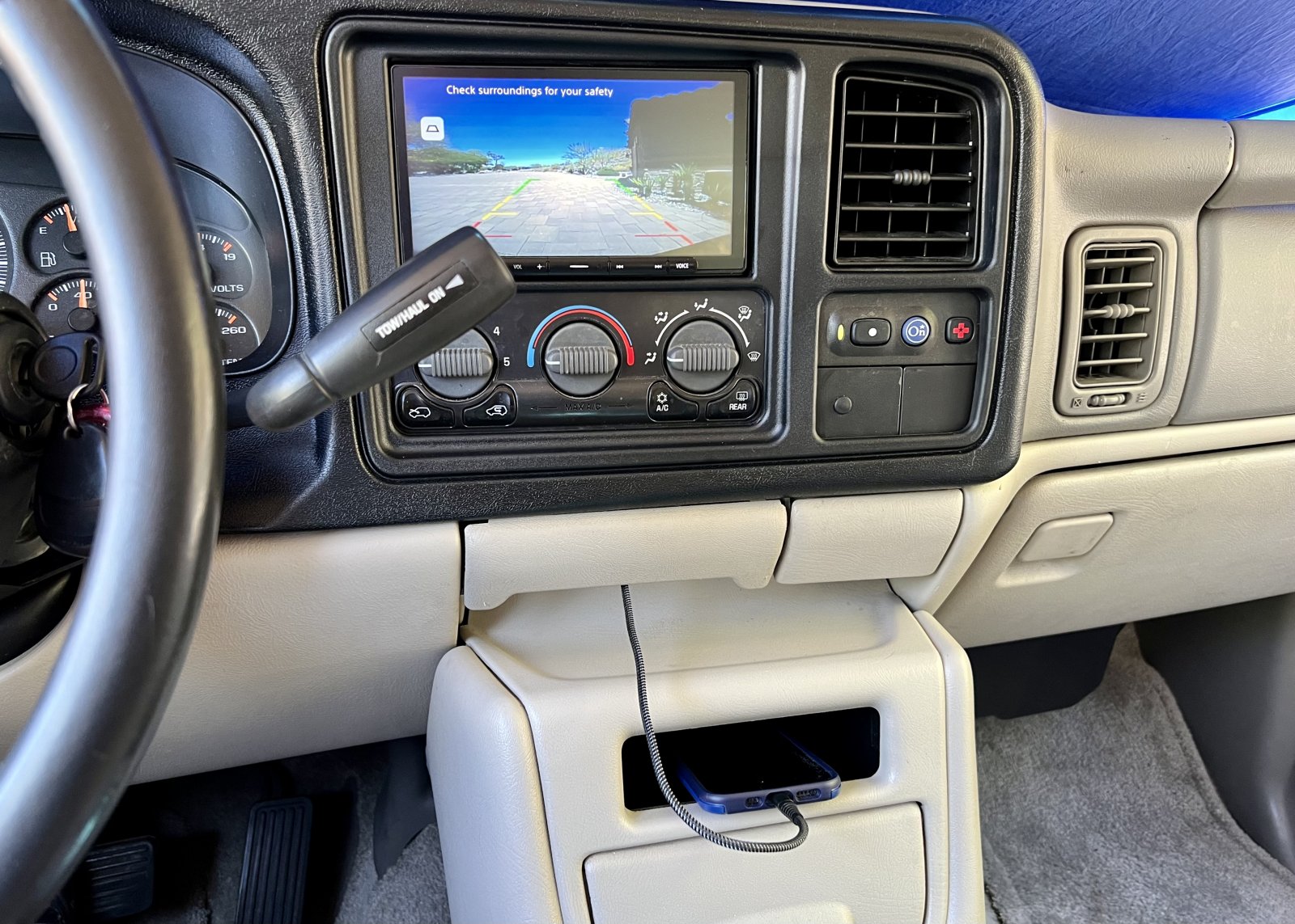

How do you do this? I’m pretty mechanically inclined. I was able to replace the HVAC door vent actuator, installed back-up camera / audio system w amp and speakers. Can change the oil. Replace tail lights. I got good tools but don’t have a lift. Is this something I can do Myself on my 2001 Yukon SLT? At 170,000 miles I’m sure it’s time to replace the suspension but I don’t know where to start.
I’ll YouTube it but would appreciate your insight.
