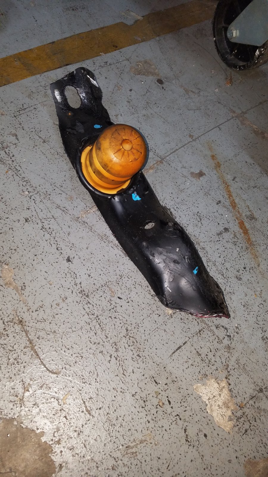

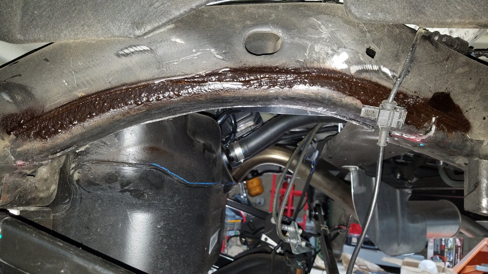

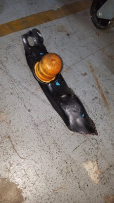

After 2.5 hours fighting, I succeed made 2 tiny mistakes but nothing serious thank God!!:chewie:
Gas tank got mil a bit by the hacksaw and with the grinder when removing the weld it went into the frame about an eighth of an inch by about half inch, so I have a light weight frame now :anitoof:

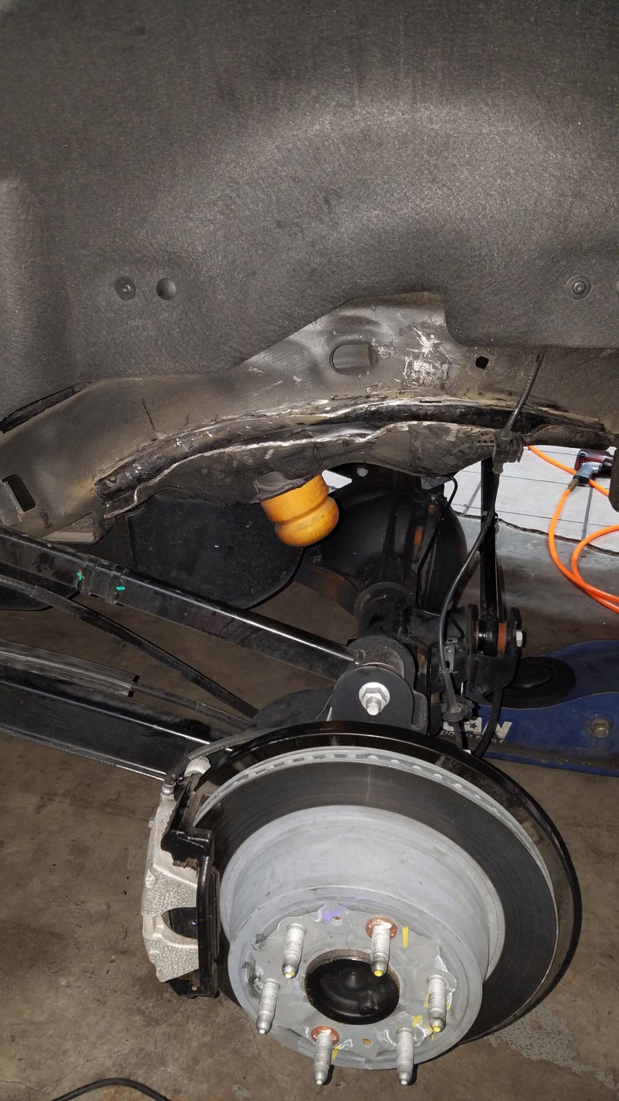

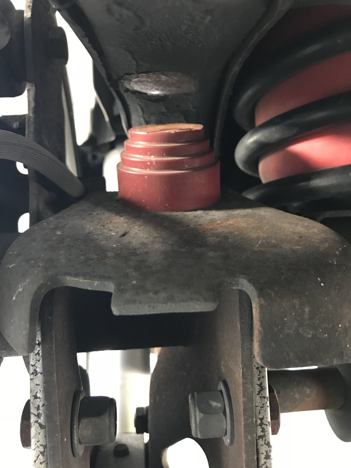

That looks good man. You might need to cut that bump stop down a little bit.
See mine here. I had to cut 2 of the layers off on mine. And you can see where it has made contact on the frame.

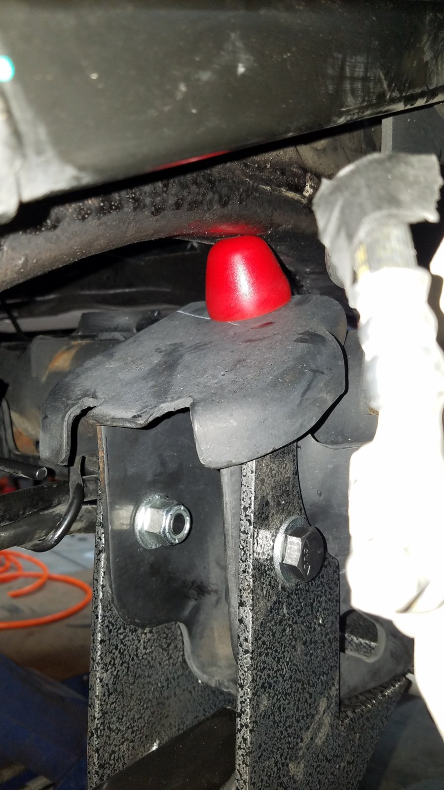

Still can travel about
They are very small yours seems like it was twice the size of this one's but ill keep an eye on it, I have bags too so it shouldn't be bottoming out unless is something massive like trying to catch air like the dukes of hazards lol

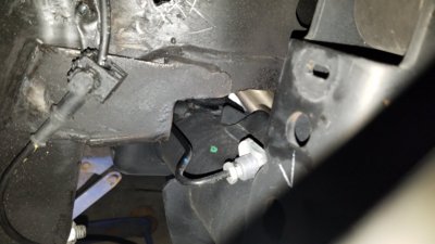

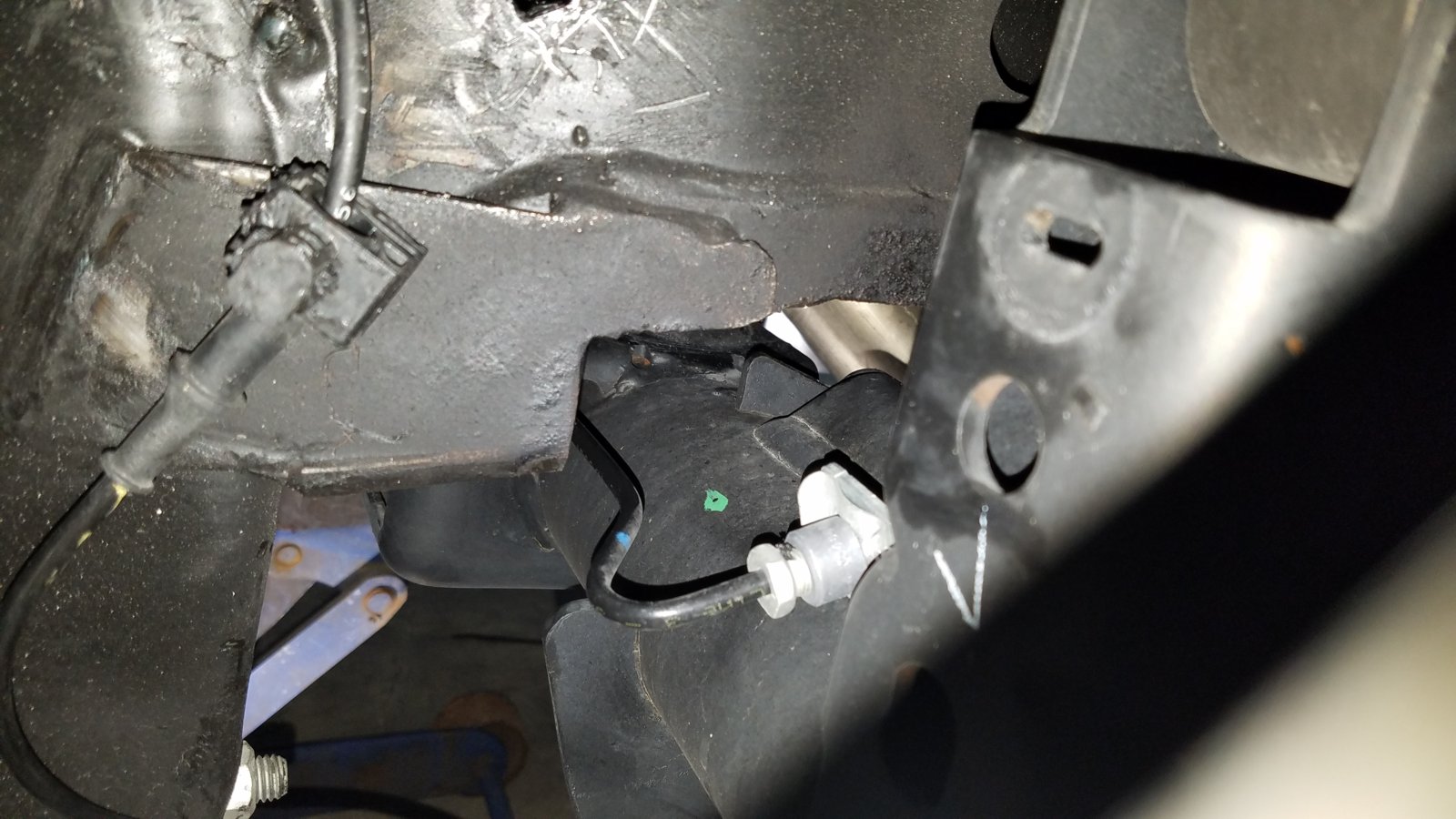

Here is one more on clearance

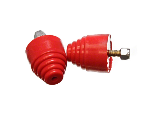

Just FYI. Here is what my bump stop looked like before I cut off the top 1/4” and another really lower profile option. They have so many if you find that one being a pain/too close to the frame.

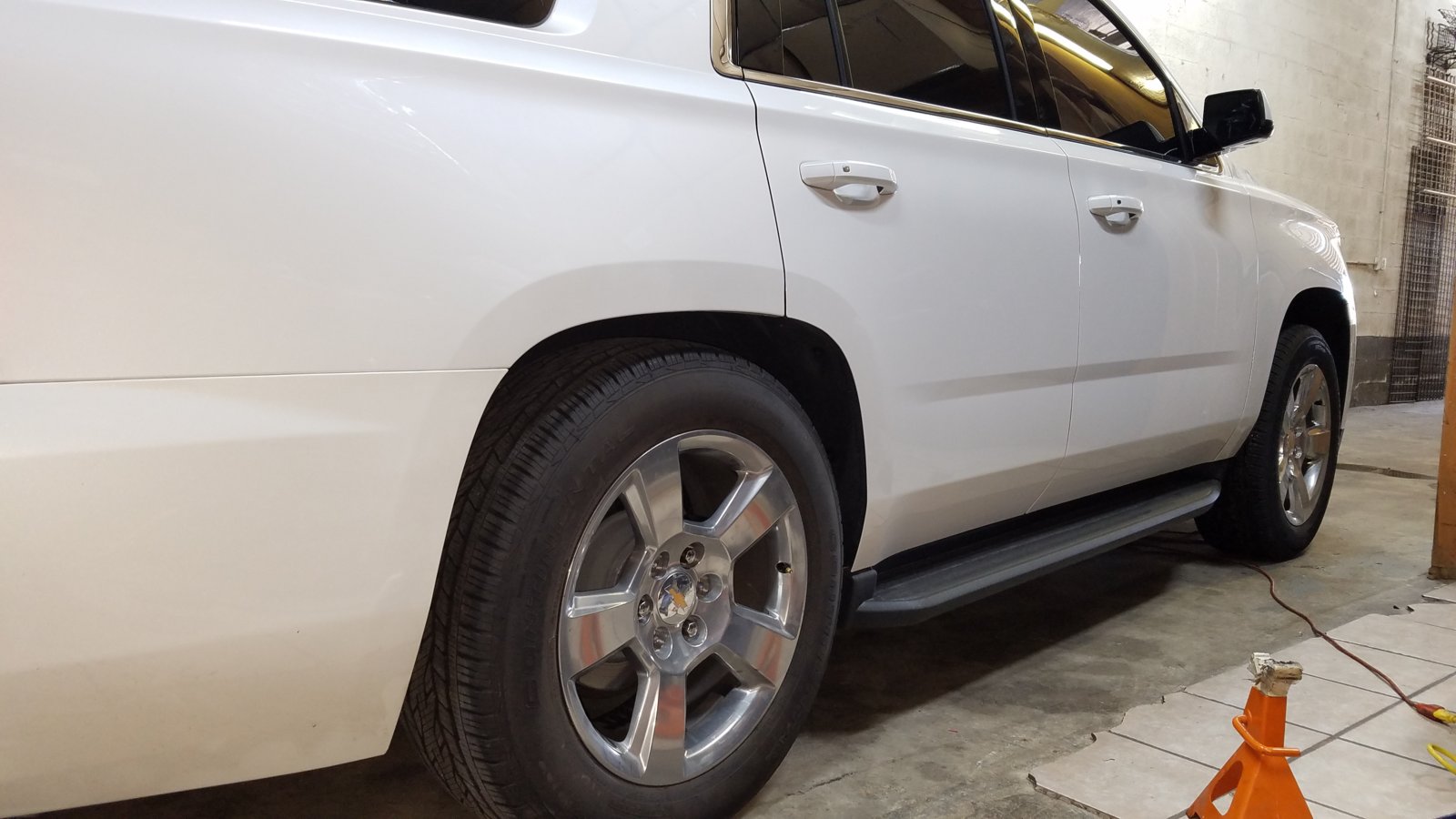

I have to say that the truck looks pretty good even on 20"
