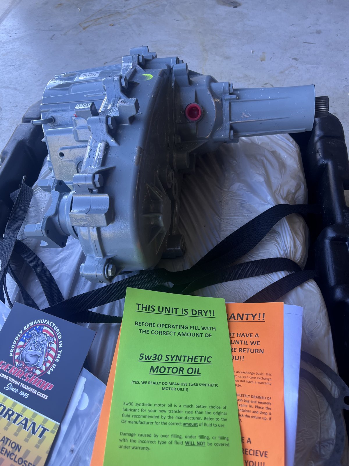

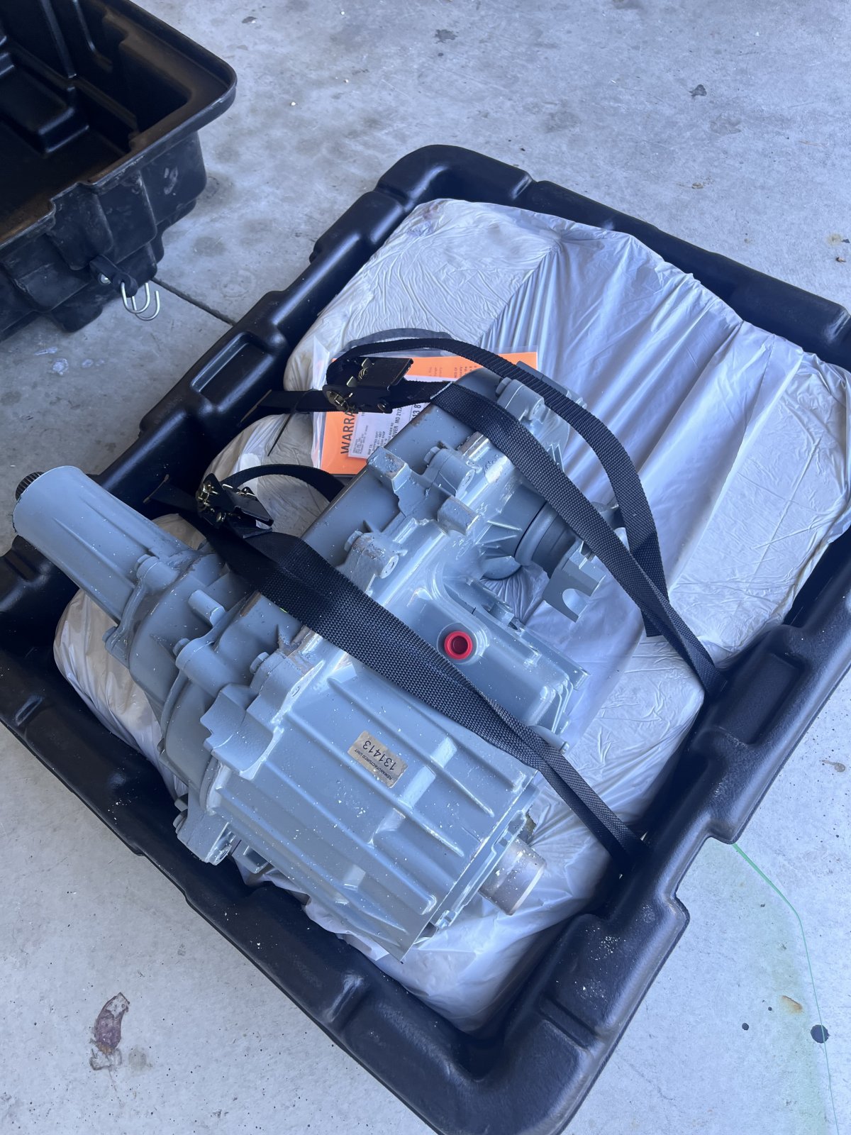

Ok so ordered a rebuilt T-case from “The Gear Shop” in MD, arrived last week. Today I’ll be making the swap.
In their instructions as seen if you zoom in on the green paper, they say to use 5w-30 synthetic motor oil for lubricant instead of the traditional T-case oil… anyone heard of that before?

I know I wouldnt be using a motor oil for a transfer case... These should use the smurfblood or dex.
The first versions of chain drives in 70's- Almost ALL aftermarket recommended motor oil. By the mid/late 80's it was an accepted substitute. Like using motor oil in an Allison.
