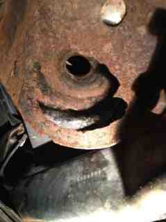

So how do I fix this?
Maxxtraxx K5

right side radiator support mount.. Easy way to patch this up? ImageUploadedByTapatalk1338331803.963603.jpgImageUploadedByTapatalk1338331829.003832.jpgImageUploadedByTapatalk1338331722.367349.jpg

If it is rusted that badly I would be careful with the metal around it because you may just burn right through it when welding.

Fab your own bracket or get someone to do it for you. From the looks of it you got a good templet to go by. Just take your time and after words POR 15 the crap out of it.
