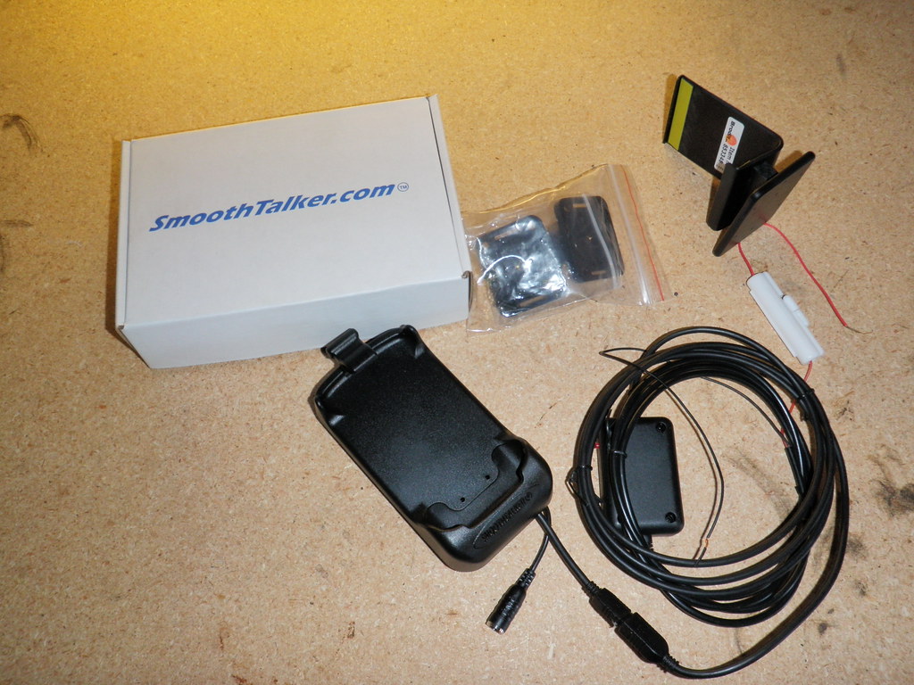

Here is the kit I bought:
Smoothtalker BTHB97IA it is for the Blackberry bold 9700, but they make kits for most phones. The kit I bought was the one that had to be hard wired in to the car. They make others that can be just plugged into the 12V outlet, but why do that if you are mounting your phone?

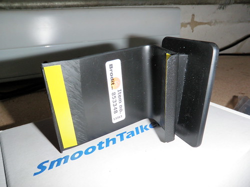

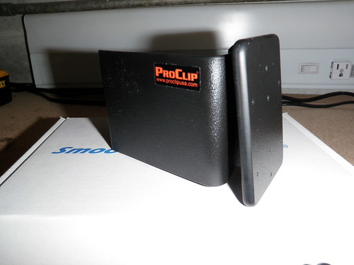

Here is the clip I installed:
Proclip #853306 GMC Yukon 2003-2006 - ProClip Center Mount, Low
Everything was straightforward... I mounted the cradle to the Proclip, removed the double sided tape and snapped it in place. I like this system because there are no holes to drill...

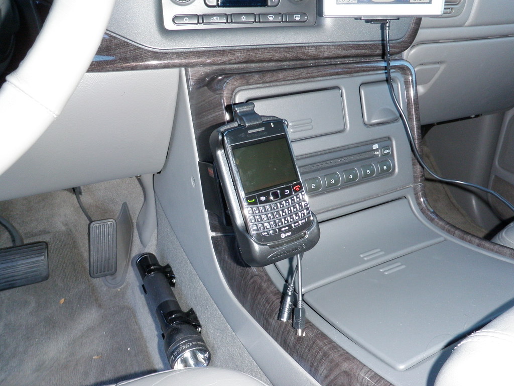

Final result:
(not pictured)
I ran the wires down the center console to the back of the console, tucking them in along the way... I then ran the wires to the fuse box and tied them into the Aux#2 fuse... which is 12V power all the time.
