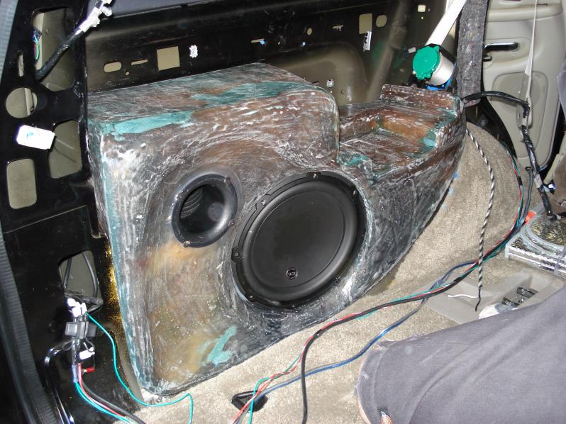

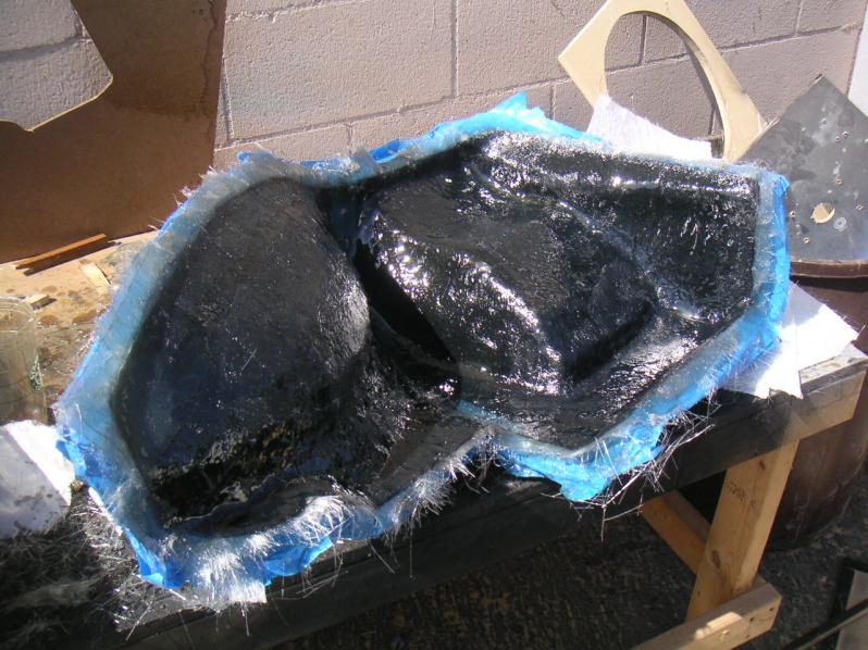

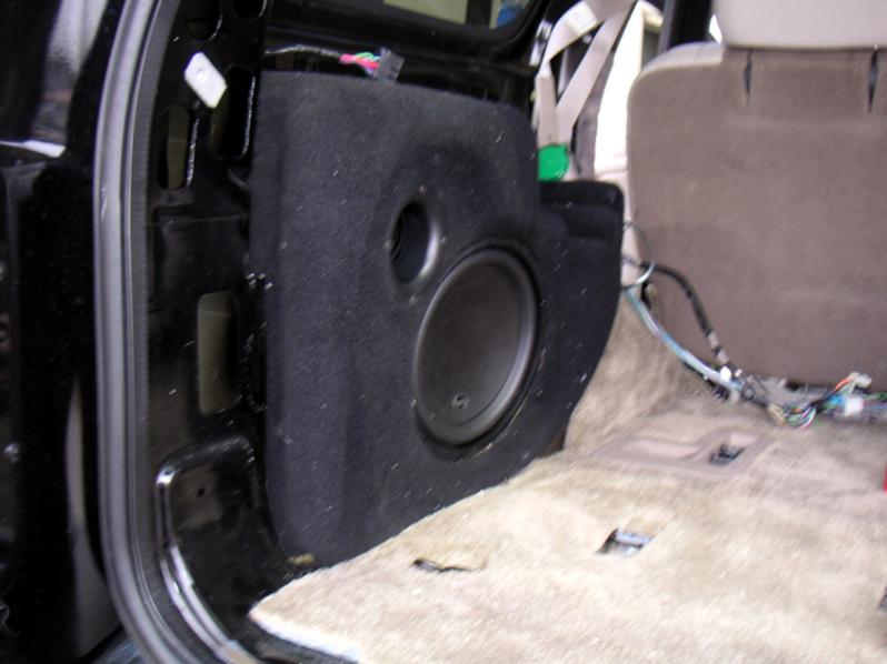

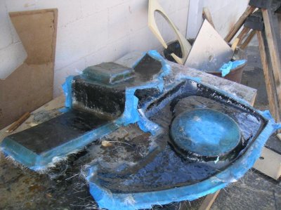

Here's some pics I found online of a custom enclosure for a 12" that fits behind the stock plastic cover. Looks to be all fiberglass and ported. Wanted to try it myself but my superior shot it down. :(

yea next one i build i will glass the back and have the front MDF.. the issues i see with this layout are:
the sub location is firing at a solid flat surface of the panel.. = massive vibrations, and distortion of sound..
then a ported box behind a closed panel = vibrations.. i would have left it a closed box..
now if you have the mat and resin out. i would mod the entire panel and glass in a grill over the new sub location.. and that would clean things up and all would go in harmony..
the reason i went with MDF over glass in my truck is i prefer the solid sound of MDF over a glass box. and i had the MDF in my shop.
now a 2 pieces of mold and then mesh to a full box. closed and a flat 12 in the stock location i think would be preferred.. this could be a standard driver model JL i cant tell from simply looking at the cone and that may be the reason for the location change as that section is deeper to allow for the larger driver vs a flat shallow mount sub..
****also this guy kept his CARGO box storage.. and to me that was valuable box air space keep that in mind..****
