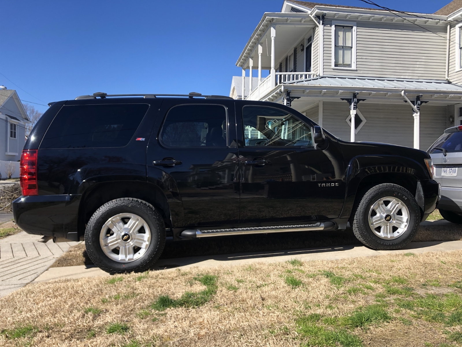

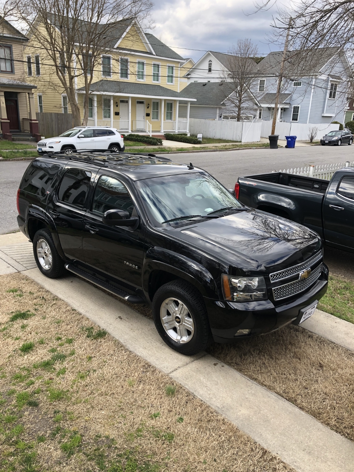

Honestly just remove them. Tahoes look great without them. I picked up a 2011 Z71 last week and the previous owner took them off:

They do look good without the moldings, Until some jack hole swings his door in to it.
Yep, definitely be careful where you park and don't always automatically go for the closest parking spot. But even if you had them and some guy swings his door into yours you're still gonna have a nice scratch, it's just that it will be on the molding rather than the panel. My last tahoe still had the moldings and I had about three separate little dents in the passenger door from people opening their doors into it--the moldings didn't stop it.
