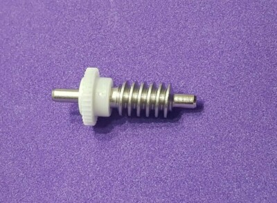

All you need is this little gear and a small vice you can grab at harbor freight for cheap doesn't take anything fancy as long as you have a large socket to slip over the gear motor housing you are good to go I am not even sure what size it takes like a 28mm? or something around there, I put that gear in 2 years ago still works great it took a couple tries to get everything right, no grinder or anything special needed. you don't even have to take the mirror off the truck it can be taken apart mounted to truck still.
if I can do it, anybody can...

it's not hard to do takes about 30 minutes about as long as this guys how-to video
only I would not use a screw driver to remove the outer cover use a plastic pry tool so you don't scratch stuff up or damage the trim
you will need a vice of some kind, harbor freight has cheap ones that you can attach to a table or workbench

Best kit hands down took about 2 to 3 hours a side but worked great after. (bought the 2 Pre-Attached Gears + 2 Motors)
Great customer service. Fast shipping.
