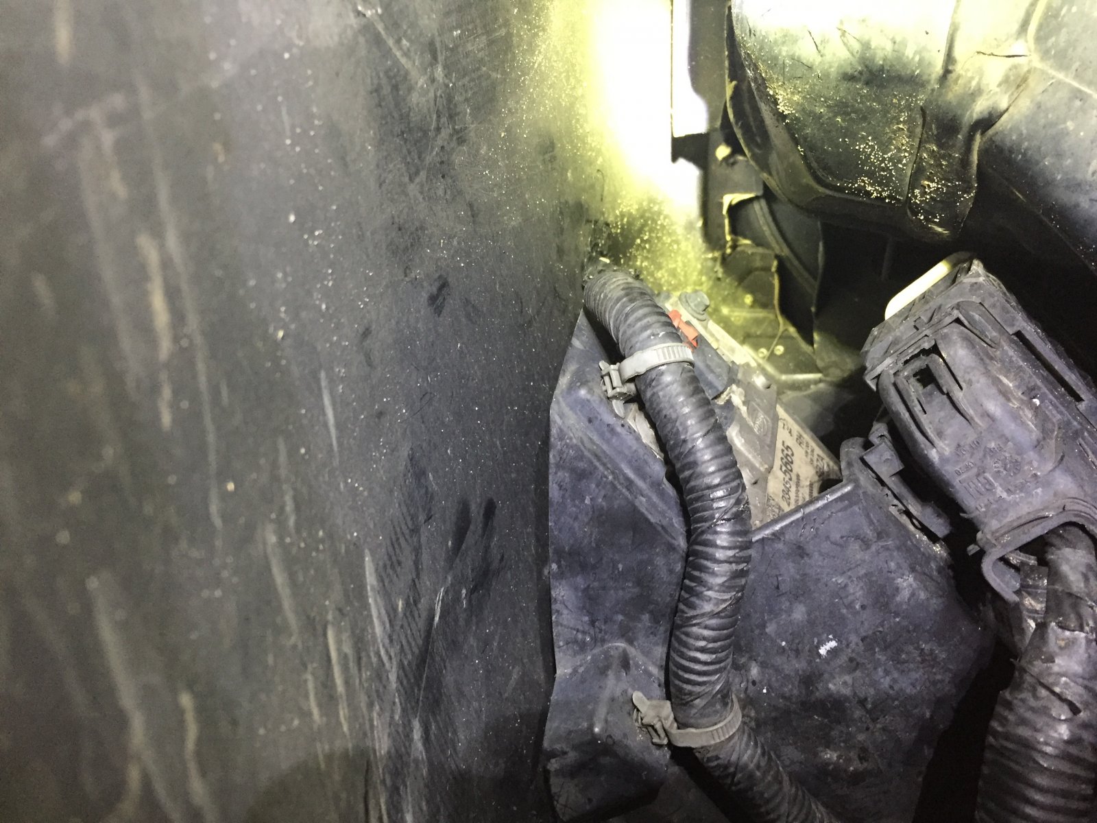

Constantly getting the “side detection Unavailable” message at startup. Looked under the bumper and the PS sensor heat staking has failed at 2 of 3 tabs.
What is the proper GM fix for this issue? I’ve heard a new bumper is required?

After trying several glues and adhesives I bought a $17 plastic welder from Harbor Freight and it’s solid now. Error message is gone and indicator functions, might be less sensitive than beforehand can’t remember.
