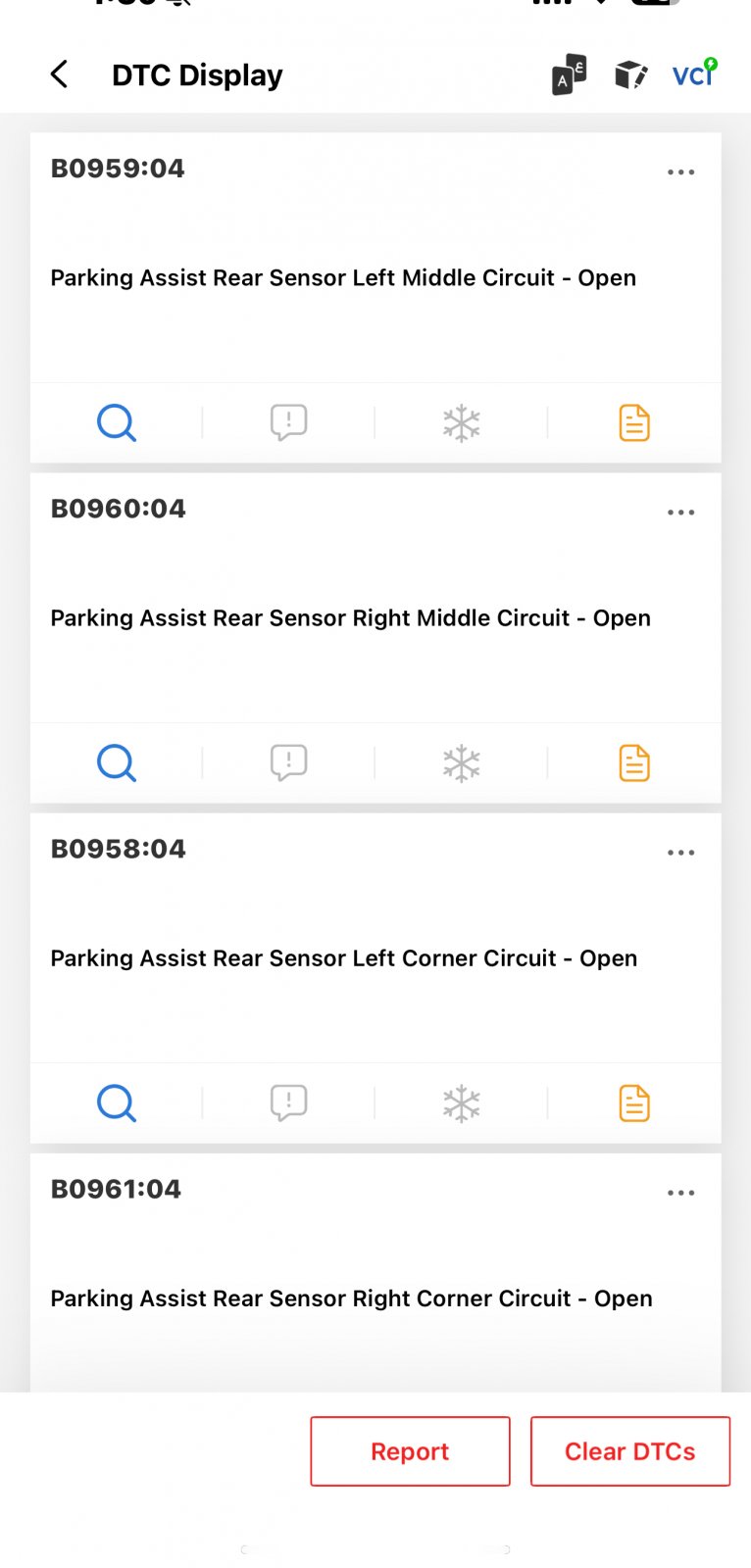

Hello! My blind spot monitors, rear parking sensors and hands free lift gate have not been working. I used a scanner and saw that theres no communication with left blind spot module and that all the rear sensors arent working. I’ve cleaned the connectors on both blind spot module harnesses and have checked for any wire tears and there’s nothing. I tried to find a fuse that could be linked it but can find anything that goes to the modules. I’ve also heard that the haptic seat can cause issues but both motors in the seat are working. Was wondering if anyone else on here knows how to fix this or has encountered this problem. I have some screen shots below of what the scanner showed.
