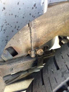

I just got my readylift leveling kit installed on my 08 Avalanche LTZ. 2.25 front and 1.5 rear. The guy at the shop called readyLift to ask about it since the website states that it will not work with autoride. Readylift said that they have to slide the bracket where the autoride connects to the rear arm forward about an inch, which they did. it all looks good and level. has anyone else done this?

I had a mechanic install my leveling kit on my 07 Avy LTZ with AutoRide but he didn't mention having to do this.

I thought the only thing you had to do was adjust the autoride sensor.

he did adjust the sensor, by moving the arm, it tells the sensor where it is in relation to height.....simple geometry
