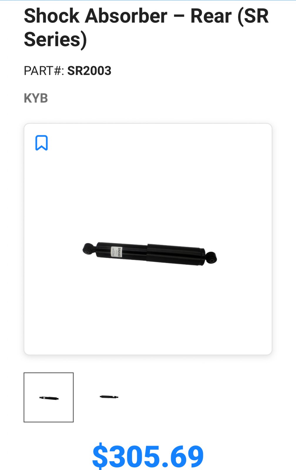

Wanted to repost this. Looking into replacing the shocks on my 03 Tahoe. My RPO codes are ZW7 and G65 so it needs the Premium Smooth Ride suspension. Wanted to slap a pair of KYB brand but I didn’t expect them to be $300 a piece. If I have to spend that then so be it, but if there is a cheaper option that will give me a comfortable ride then I’m open to hear it. I basically just like to keep things as stock as possible when it comes to ride comfort.

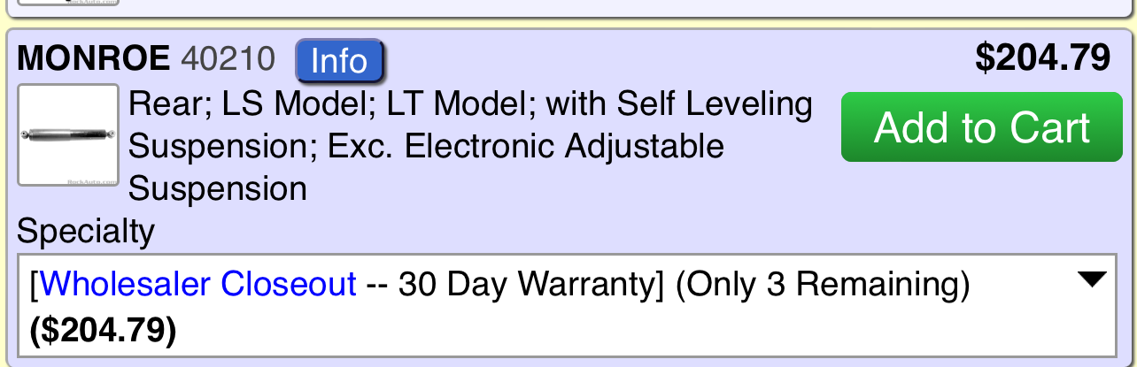

A couple months ago, I snagged some "wholesaler closeout" Monroe Nivomats from RockAuto. Saved about $250 overall and they work great. Looks like they have 3 in stock right now: https://www.rockauto.com/en/moreinfo.php?pk=951468&cc=1424247&pt=7556&jsn=1429&optionchoice=0-0-1-1
Those are saying for vehicles equipped with factory air or electric suspension. Are you sure that’s what I need?

The description is a tad misleading but here's from the search page:
40210 is what i have on my truck.

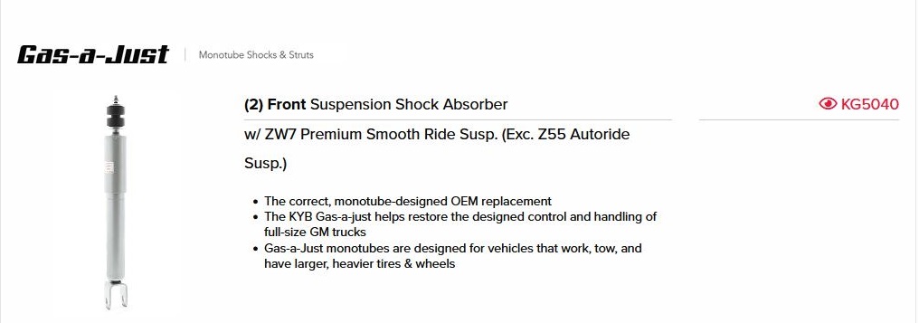

I also have the same ZW7/G65 suspension on my '04. My OE Nivomats in the rear work just fine so I left them in place. I did replace the fronts with what KYB indicates are the Premium Smooth Ride replacement shocks - KG5040 - and I'm very happy with the ride.
If you're interested in the KYBs, verify in the KYB catalog: https://www.kyb.com/catalog/

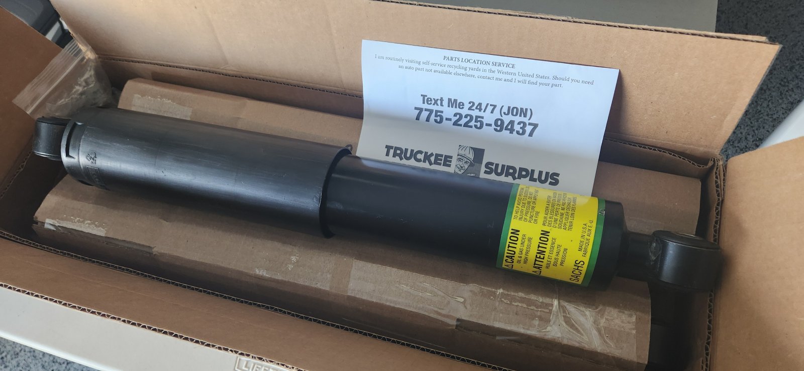

My friend, Jon, with Truckee Surplus has nearly brand new 'used' Nivomats as a pair for less than $300 including shipping. He specializes in shocks also. He's been doing it for years.
I just returned a pair, because ( after all my research), my Yukon ZW7 smooth ride does not use them. Nivomat rerquires a softer spring, so stick with OEM.
Not sure how I feel about getting a set of used shocks. Plus this name brand I’m not familiar with.

Used shocks though? Can you personally vouch for these shocks?
The seller, inspects the vehicles for 'evidence' of newer shocks, he removes. The Sachs 'Nivomat' shocks he sent me were in a brand new condition ( The OEM decal was also original and clean) . I spoke with him, and he has been doing this for a long time. He also guarantees them.

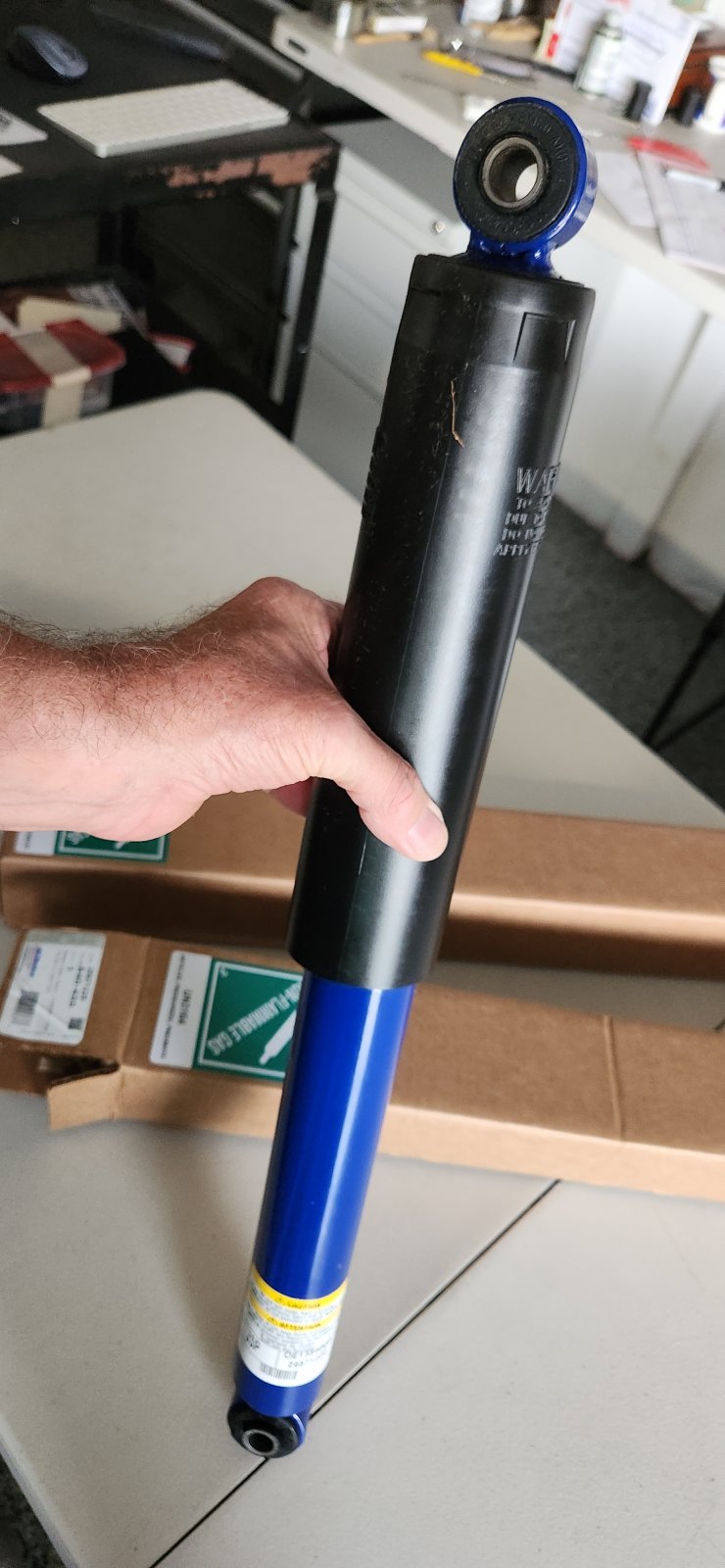

I just received today, my OEM / AC Delco replacement rear shocks. Since the originals have 175,000 on them.....
My Hellwig front sway bar to arrive today, also.....
I am happy.....
I am happy.....
Did these come from Jon ?
