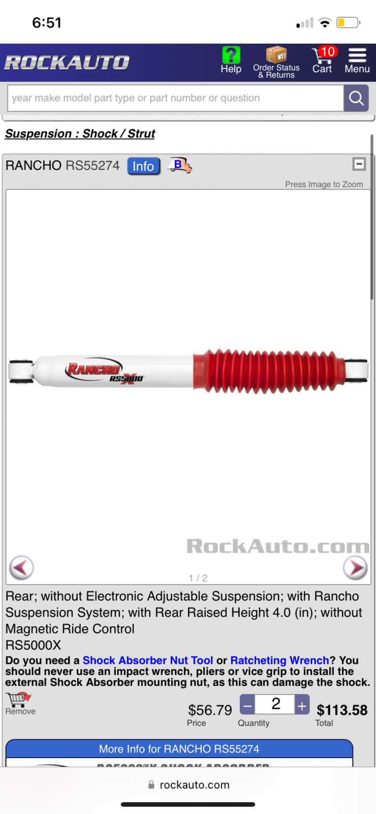

I have a 2007 Yukon I need new shocks I’d like to add 2 inch spacers to the rear I’m looking at the Rancho rs5000x would I still need the spacers to get any lift ?

These are the ones I’m asking about

@Yukon2007 All lift is achieved from longer springs or spring spacers. If you plan on lifting it 2 inches I recommend buying shocks that are designed for lifted Tahoes or use shock extension brackets. If you use stock height shocks with a lift the shocks will not perform very well

Ok thank you the ones I posted are for up to a 4 inch lift
