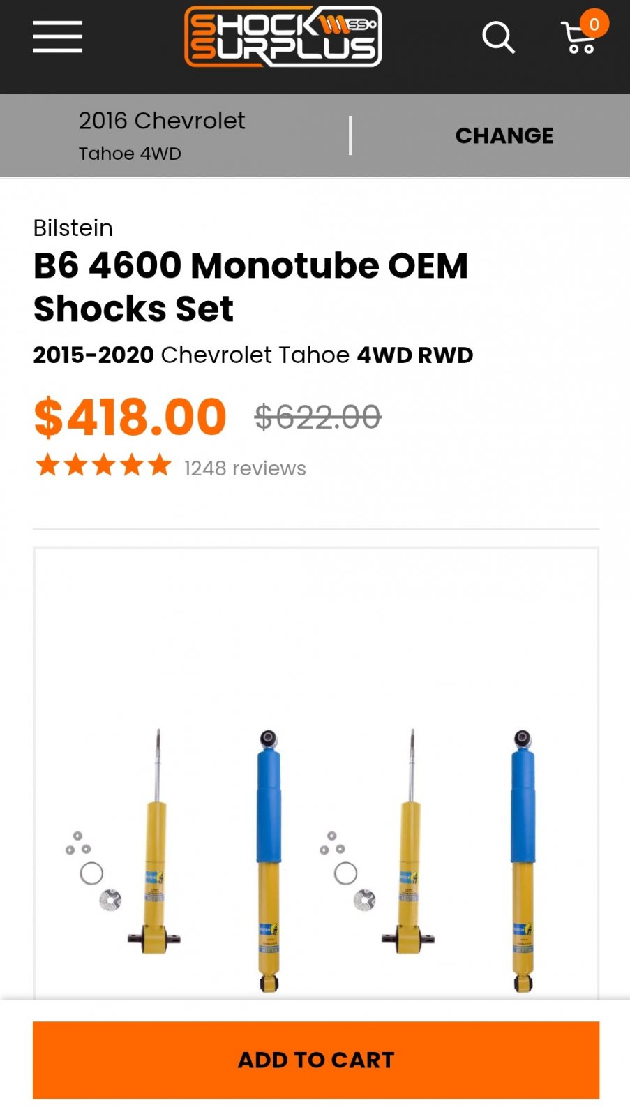

Good evening, so I know there are plenty of threads for this but most are a little outdated. My 2016 Chevy Tahoe now has 160k, shocks feel like they are done for. Did some research and most are either super expensive or say they are for without Magnaride. I did howver find these. are these good? They seem way too cheap. They dont specify of they are for magna ride or not.

the 5100's or 4600's are commonly used for non magride, or with a magride delete but if doing a magride delete you'll want stiffer springs on the rear like moog, there really isn't another close spring replacement unless you get some oem ones from a non magride vehicle

Those are for degrading your great riding suspension to a "dumb", non-computerized suspension. Sure, it costs less, but ask around and you'll see a great many folks who did this eventually restored the suspension back to original.
If you're riding on 18" wheels they'll feel fine but not with larger diameter wheels with shorter tire sidewall. To each his own.

Remember the old saying, "You get what you pay for, AT BEST".
Go to GMPartsDirect.com and enter your vin. Then, match the secondary suspension RPO codes to the RPO code sticker on your truck.
If you want a passive suspension for any reason, many folks here use Bilstein shocks, but as stated above, you will need to replace the rear springs with stronger/stiffer ones.
