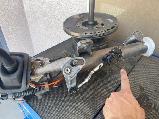

If that's confusing (and im sure is), here is pics of what im referring to.

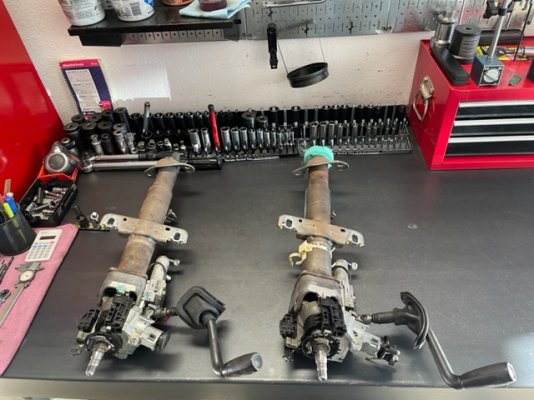

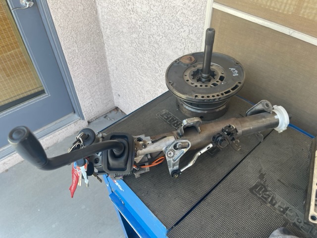

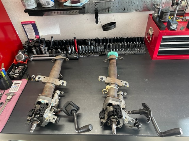

Steering column (mine's an 03 5.3L but is largely the same as yours). I replaced this one with a column from the junkyard as the one shown had an upper column bearing failure.

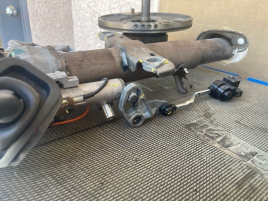

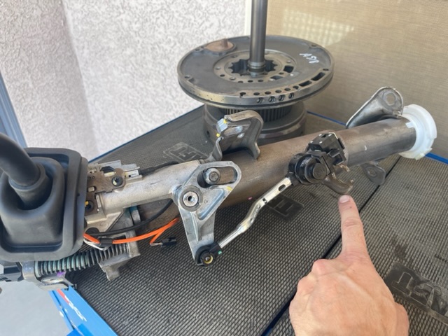

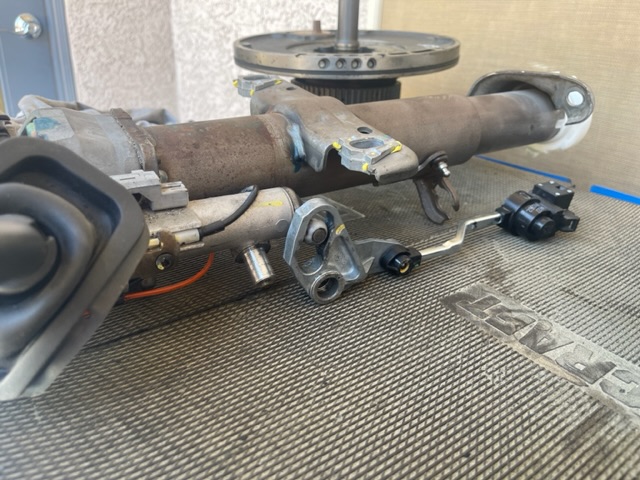

Im pointing at the shift cable bracket on column. The shifter cable's locking tab mechanism must be engaged in that bracket.

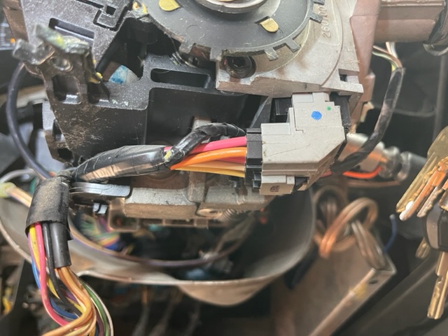

Pic of shield after lower paneling is removed
