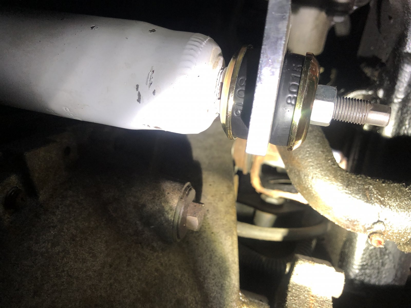

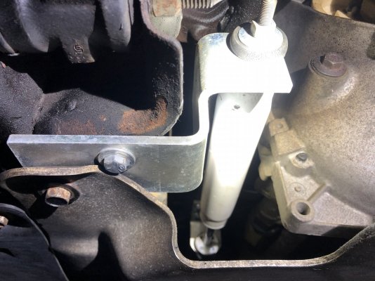

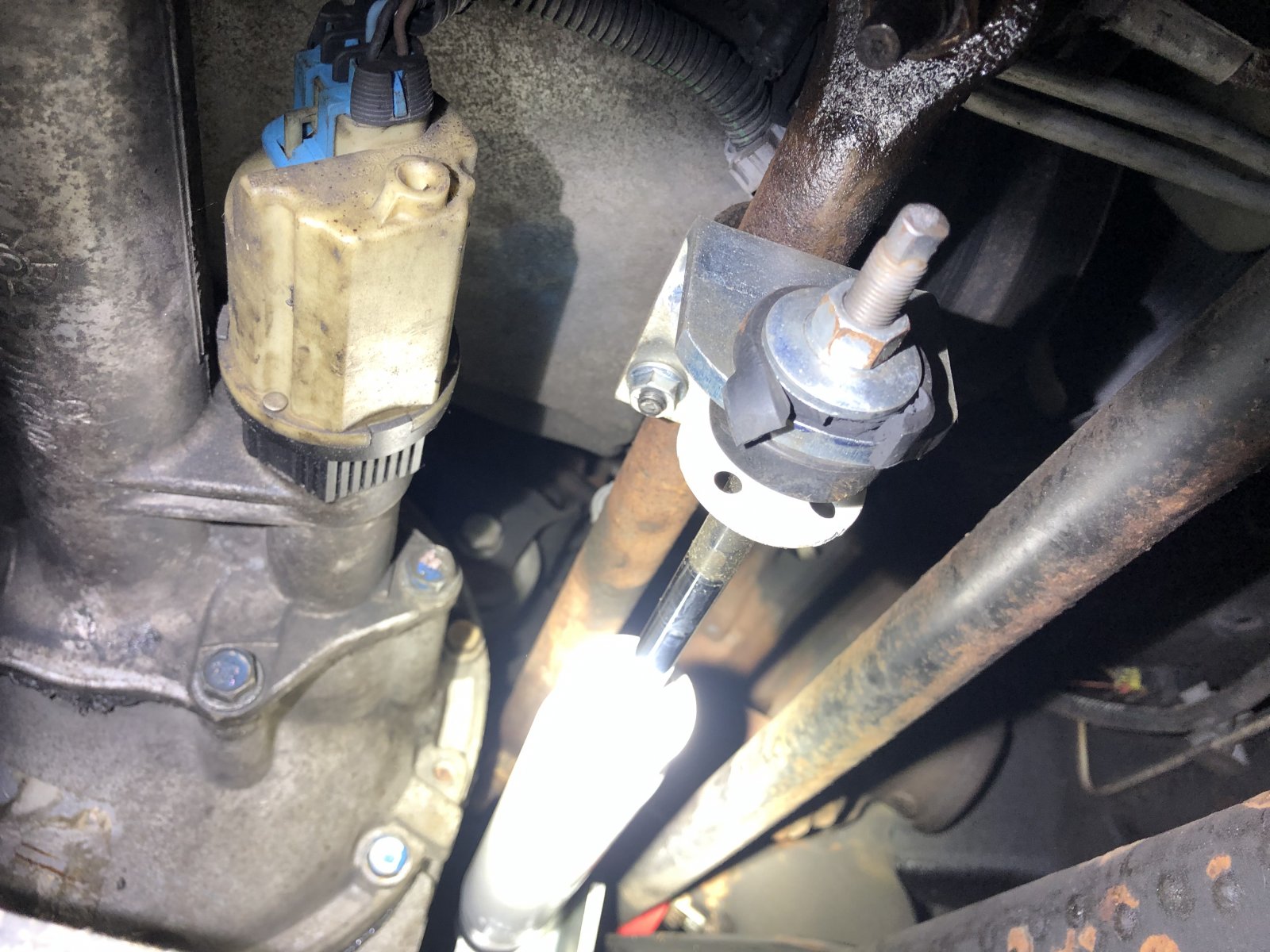

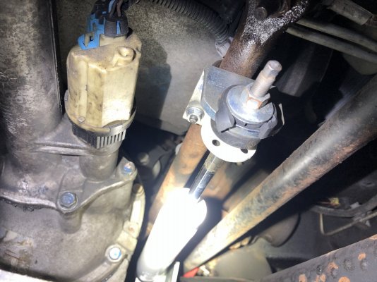

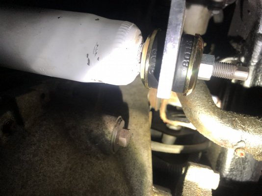

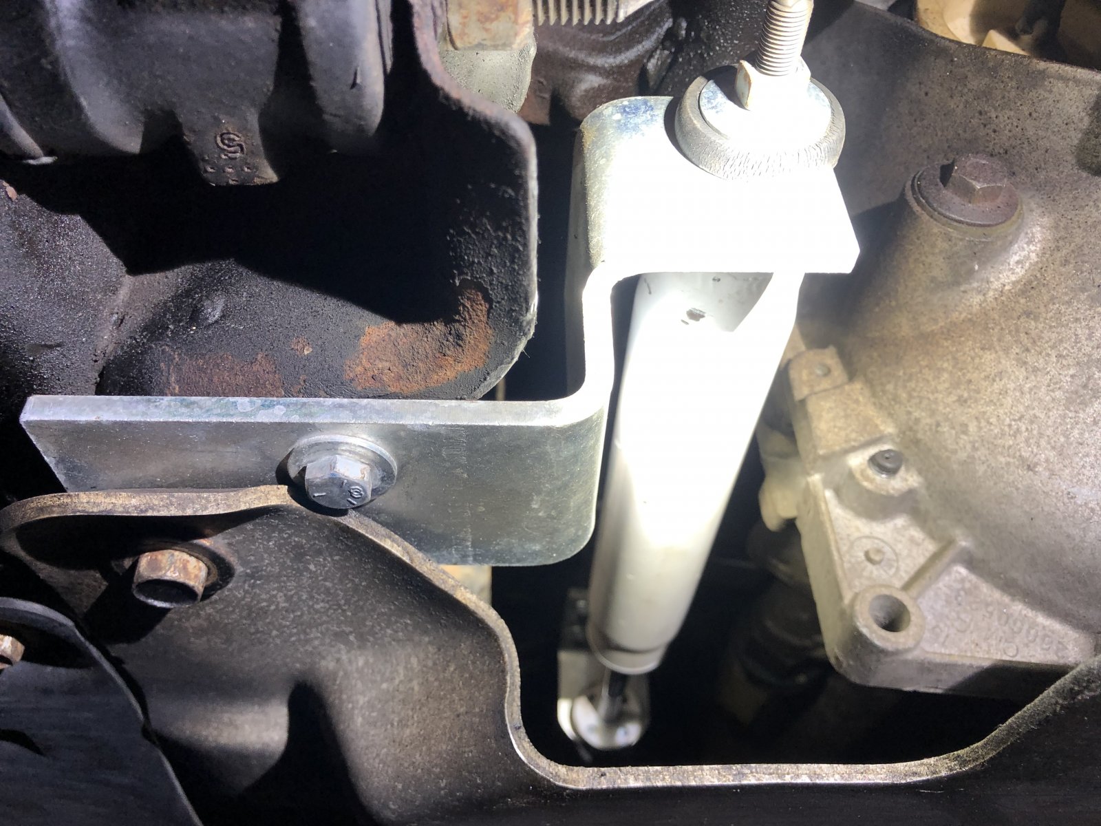

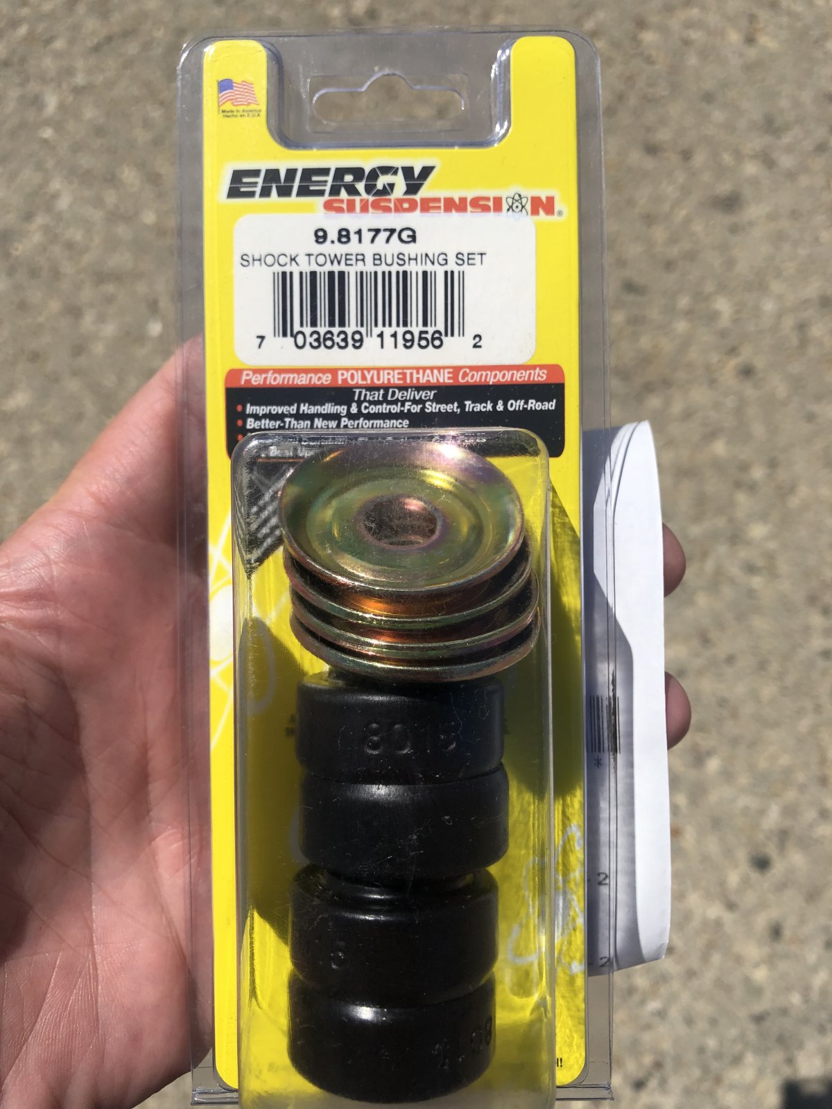

You wouldn't happen to have a picture of that mounted, would you?
Here you go not the best pics and yes i overtightend the bushing but i still think they were junk felt like cardboard after 2 weeks.tried a few till i found the right ones the red ones are what you need the black ones didnt fit correctly.This 50 dollar part and the polyurethane sway bar end links and bar bushings made the most improvement out of anything i have done to the hoe.I dont dread driving 50 miles to work and back daily now its a pleasure.Once i put the 33 duratracs on it and keys it was all over the road in crosswinds and every pothole was scary.Now at 80 mph i let my hand off the wheel and hit pothole and all good.
