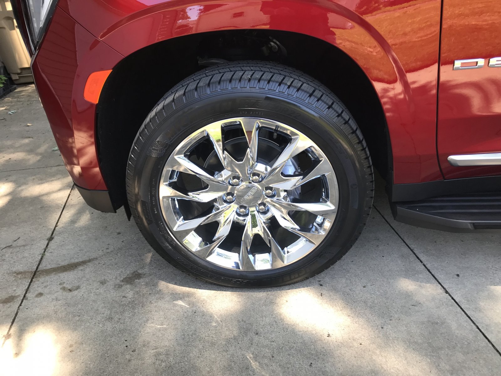

Curious what tires came with vehicle. My 22 Denali came with 20" Bridgestones that had a shake at 65+. The 22" wheels I had on constraint finally came in with Alenza"s and I changed them to Michelin LTX and no shake.Tires were the problem. IMG_0410.JPG

Curious what tires came with vehicle. My 22 Denali came with 20" Bridgestones that had a shake at 65+. The 22" wheels I had on constraint finally came in with Alenza"s and I changed them to Michelin LTX and no shake.Tires were the problem.View attachment 391379
Those Michelins look excellent on your wheel, and the wheel set up looks great against the red backdrop of the Denali!
I went from Bridgestones to Michelins as well, and could not be happier like you. A year into my first set of defender, LTX tires, and absolutely love them.
