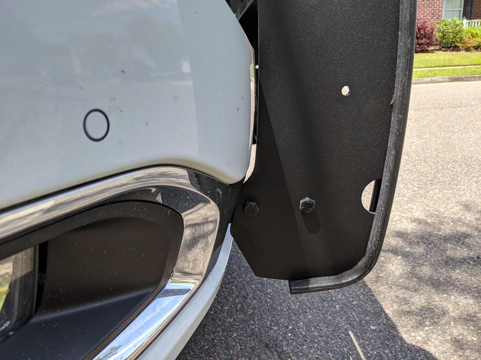

Ended up going with the go rhino bar. Had to modify it to fit on my yukon. The middle pics show where I had to cut a diagonal to take away some material to clear the lower lip of the bumper. The last pic is of these little rubber stickers that "ranch hand" sells for $5.00 that literally just stick on the offending sensors. Havent had any issues with sensors at all. They work. I left the outside ones alone and they do their job well. In fact I dont miss the center sensors at all. They only seemed to go off when I was parking in front of a bush or something.
MVIMG_20190425_132810.jpg IMG_20190425_132802.jpg IMG_20190425_132826.jpg IMG_20190425_132820.jpg
sydneyman
Mar 20, 2019
8
Forgot to mention, I like that the go rhino bar allows the use of the factory tow hooks, the top isnt above the hood line, and you an add headlight guards later if you want.(those holes in the uprights) Very happy with it.
