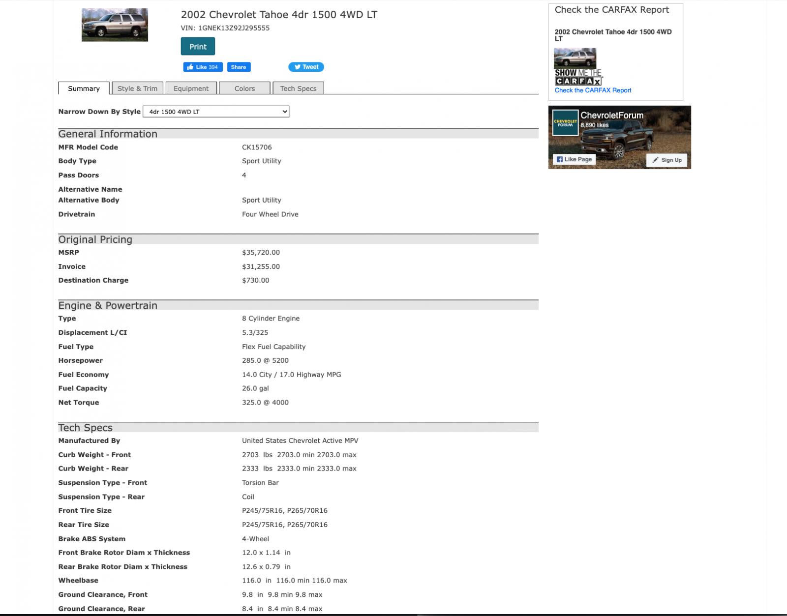

This is the first page from a VIN I was looking at for some other reason (it is not mine).
I tested before I posted earlier.
This one will give you basically all the information that would have been on your factory sticker.
Maybe not the same exact format, but a wealth of information on standard and optional equipment for specific VIN.

That's generic and not vehicle specific. No RPO codes are provided which is what the OP was looking for. Compnine provides the RPO codes for that particular VIN if the vehicle is in their database.
You are correct, sir.
On second look, it is generic as you say.
I thought it listed VIN-specific options by name (without RPO codes), so he could throw a VIN in there and see if "Autoride Suspension" showed up.
Maybe it does not got as deep as I thought.

I must have been looking at the VIN decoder on Chevrolet Forum for the "window sticker" stuff.
Right, I plugged in my VIN again and the first thing that came up was 3.08 gears, which it doesn't have.
