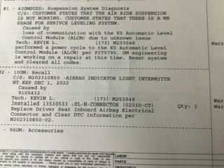

We got ours back from the dealership yesterday and, yes, all it needed was a reset. Working great over the last 36 hours. Silly problem to have, but glad it was easy enough to rectify.

Got mine back , it was just a reset but speaking to the service tech they aren’t sure what the real issue is. I’m back at normal ride height now and plan to leave it there .
