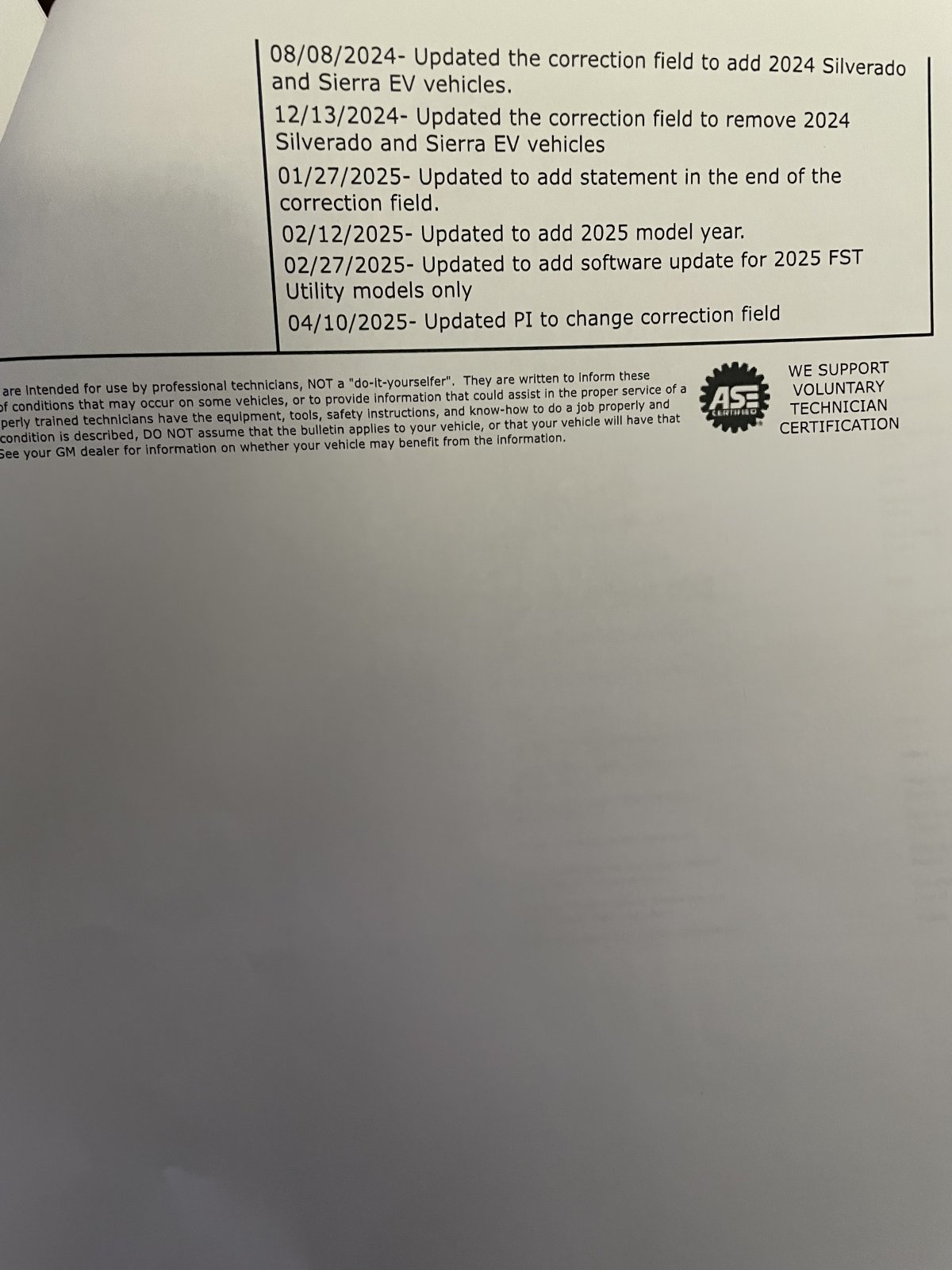

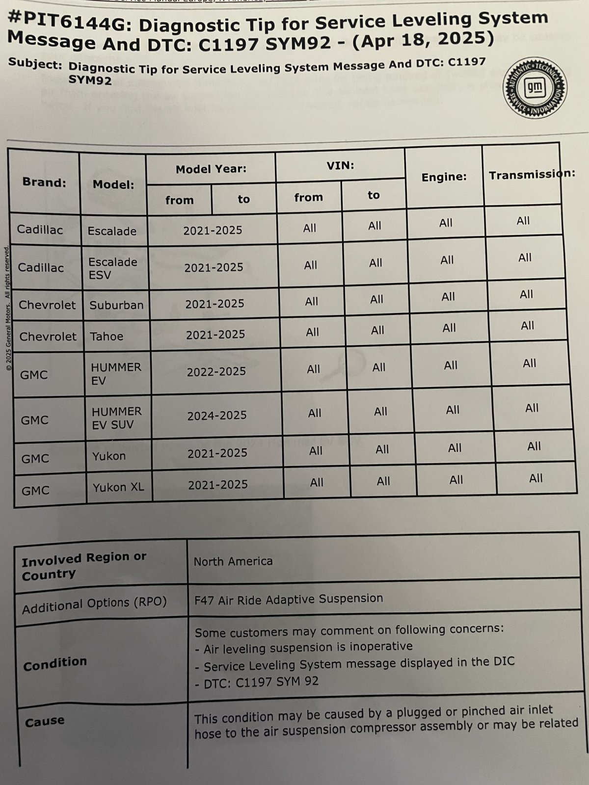

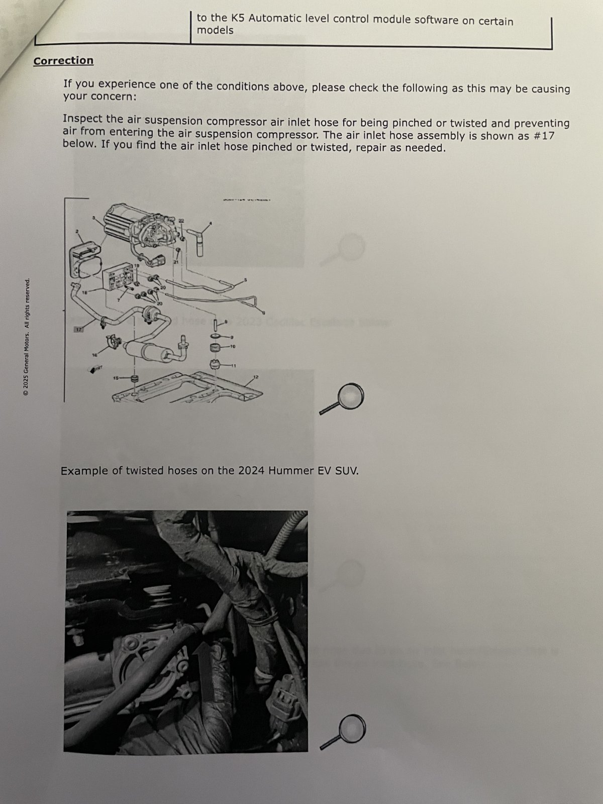

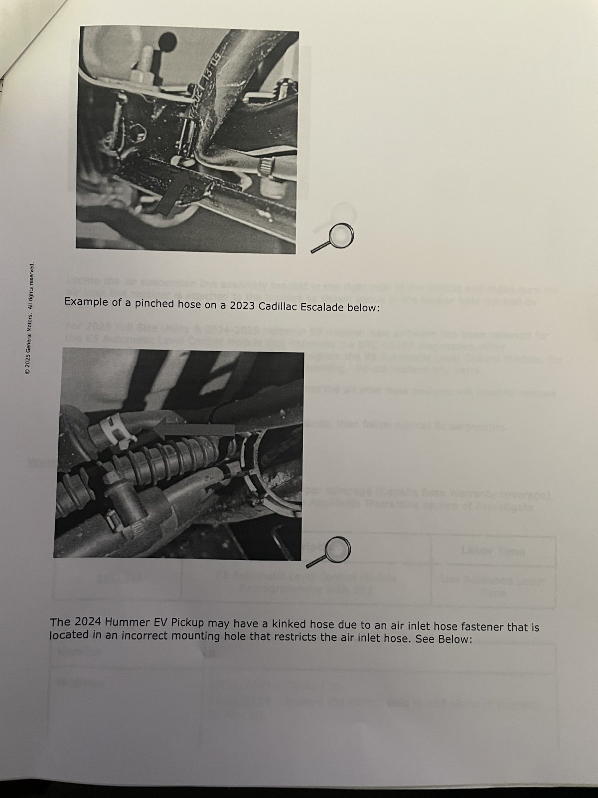

There’s a tip for this from GM on the air ride leveling system for all the full size vehicles, here’s some photos I took of the diagnostic tip they gave me.

More

Your truck is doing exactly what mine is at this point.
Thanks for the tech note. I had spotted this many weeks ago and brought it to the dealership's attention; they said they had looked into it, but not sure I trust that.
