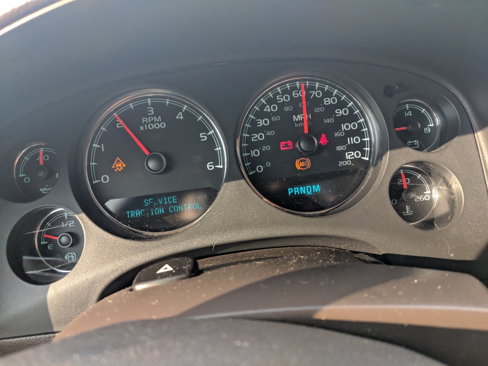

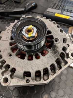

Alternator took a dump on my yesterday night but I was able to make it home.
Got the new one installed this morning before work but the batteries might be dead for good.
Last night batteries tested at 9.4 volts
After installing the battery light was still on but went off briefly on the highway and then back on while in stop and go traffic.

Well two new batteries and it's still not charging correctly . New alternator is on and is putting out 14.5 to 15.5 volts, passenger side batter is already at 11.4 volts while running and drivers side battery is 12.5 while running. This is after 5 miles after new batteries and letting it idle for about 10 minutes
I need to check grounds now, passenger engine side ground is tight but I can't see where the small ground off of that goes too.
Any insight is appreciated.

All grounds we're good and clean but I did find the mega fused trashed . Ordered one from the dealer and will be installing today.

I'm thinking it's a fuse or still possibly a ground wire, from what I know the NBS trucks ground wires can corrode from the inside, you do not need to change the pulley, if that was the case there would have been a recall years and years ago, also if your mega fuse was burnt or melted that's also a sign of a bad ground or your old alternator fried it which is possible but pretty unlikely.
Water got behind the mega fuse and grounded against the fire wall where a spot was rubbed through.
