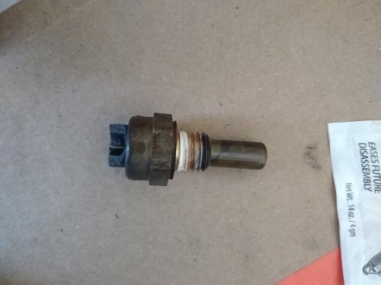

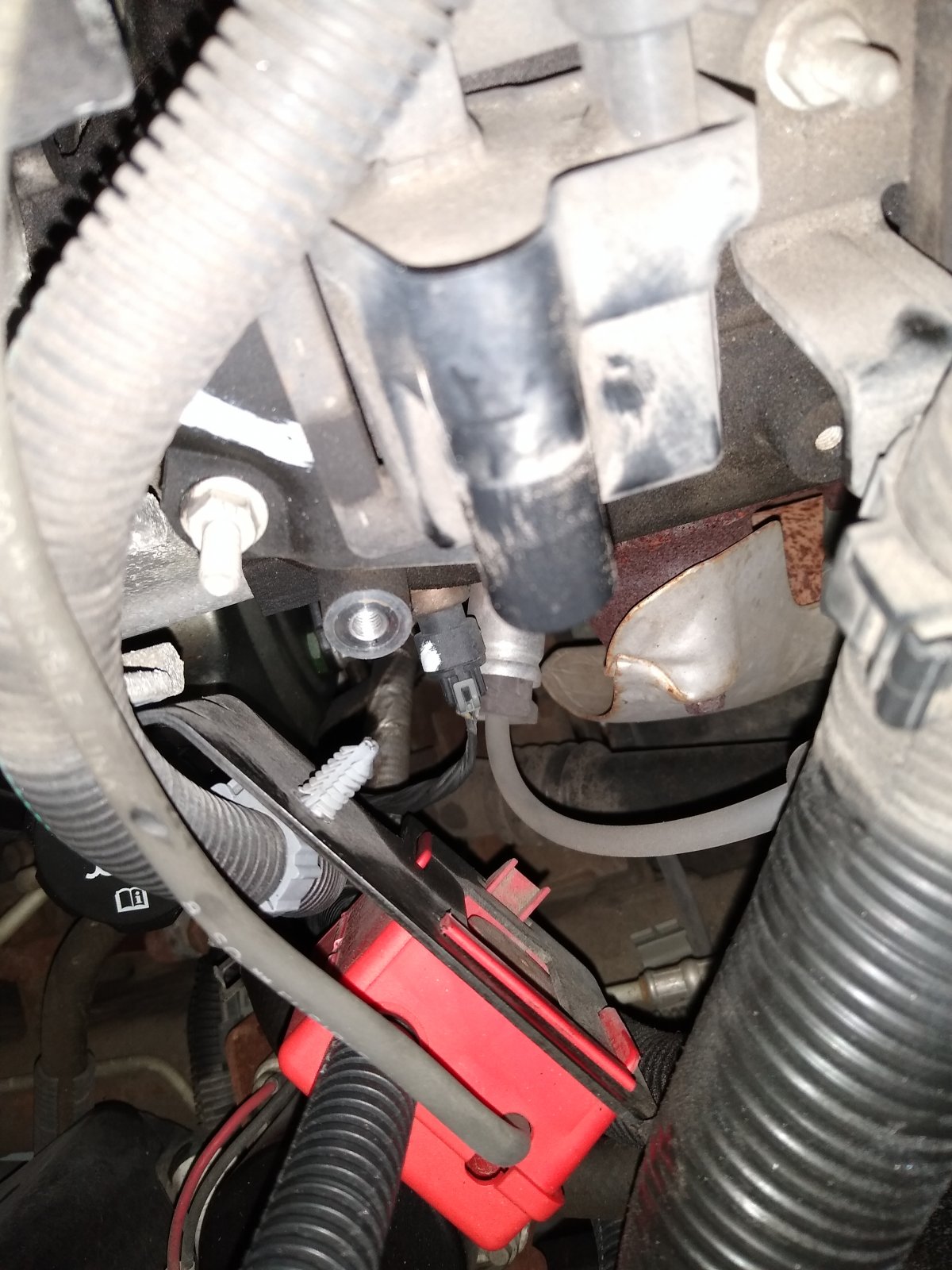

Hey guys, I decided to change the spark plugs on an 05 Yukon I picked up a few months ago. It has 115k miles with a pretty thorough documented service history. As far as I know they have never been changed. It took about 4 hours but I got #1-7. It was more difficult then expected but I only broke one thing.
there is a little sensor right next to cylinder #1 the fell apart when I hit it with the wrench. Does anyone know what this sensor is? It's very small.

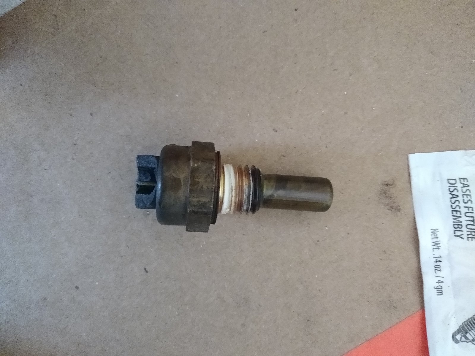

Got the new part in. Took about 10 minutes start to finish. I didn't notice any drips or leaks and the temp gauge is reading right in the middle like before. Thanks again for the tips!
