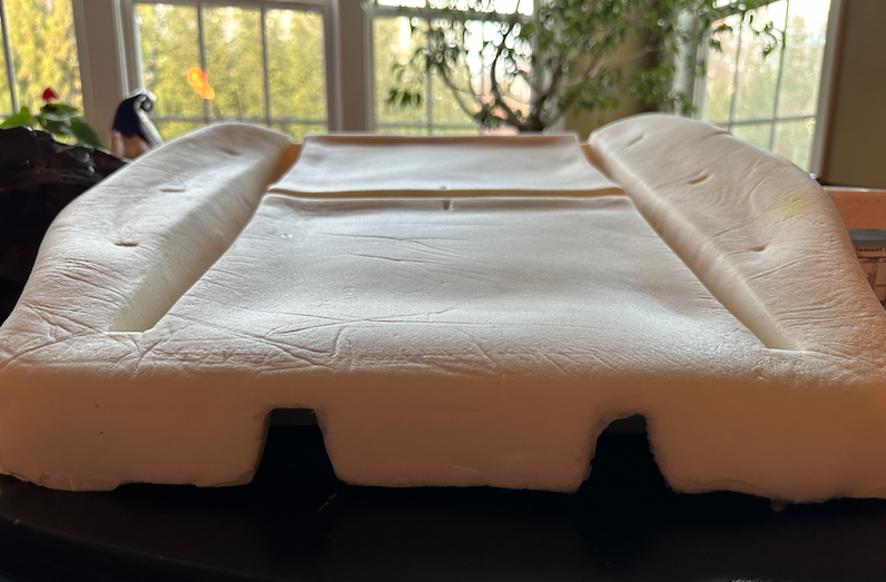

Significant disappointment here with the eBay foam cushion. It looks like it was already used. The outside (left) bolster is significantly lower than the inside bolster. See picture below. Contacting the seller - not happy at all. Don't waste your money with this clown, folks! Seller was autoparts-tom.
45,012
An identifying numbers on it? I'm wondering if someone sent the seller their used one as a "returned new one".
No, not that I can see. My guess is that it's one made by them but was returned after being used for several months and the customer was pissed because it didn't hold up. Going to order from the Seat Shop instead.

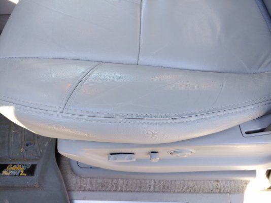

Here are the pictures of the leather replacement bottom seat cover on my 07, I had it replaced about 60k ago. You,ll notice in the back where it is short and the non-leather gray material is showing (Pix 2). Like I said previously, the guy I had do it, built up the cushion some so it may have cause it to come up short in the back?
The leather has held up pretty.

That's a lot of "short". Even though the cushion was built up, it should be squashed by the cover once it was wrapped. The cover doesn't stretch nearly as much as the cushion compresses and it wraps around and hooks to the seat pan. Or maybe it was REALLY tight and the cover stretched over time from the cushion pushing out on it?
Aside from that, I agree- the material looks to be holding up great. Thanks for the pics and input!
