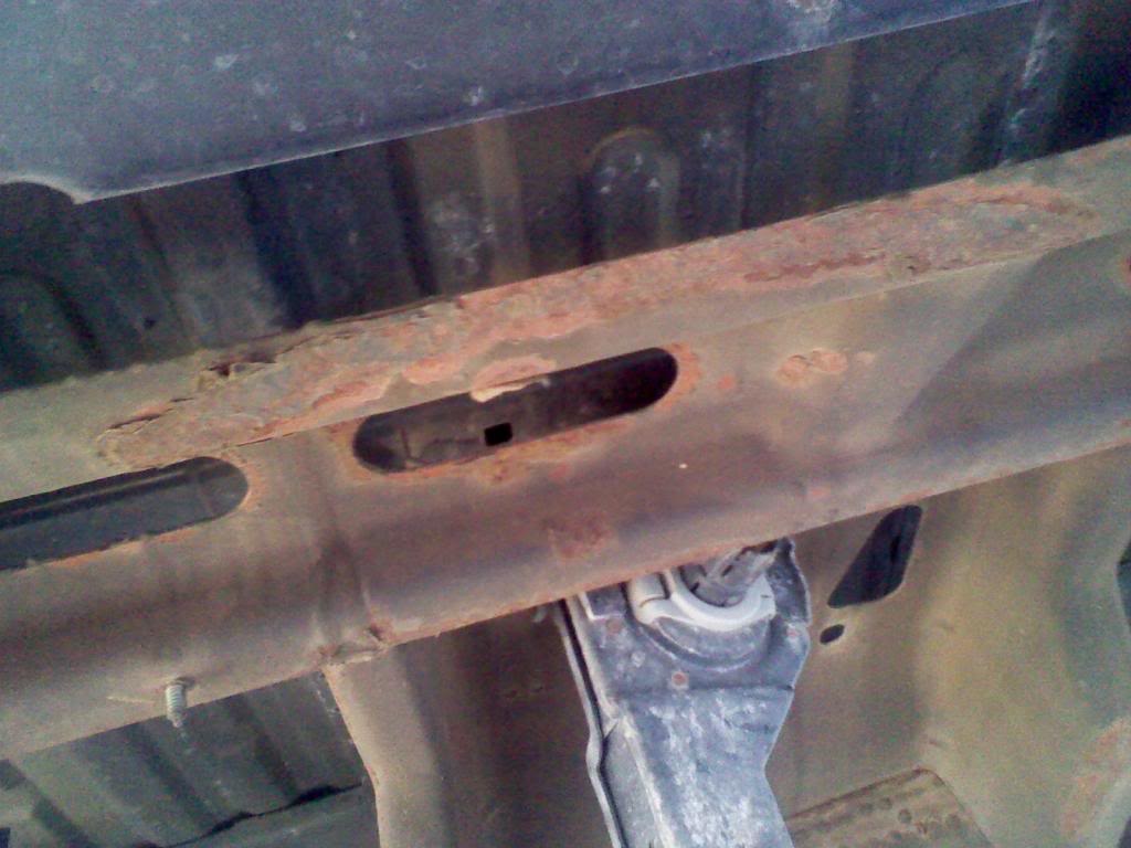

should i worry about this, and what can i do to fix it?, this is on the spare tire area.

before you put that on, clean off the rust...get a wheel for removing paint/rust, stick it in a drill and clean off the rust.
I know POR can cover rust...but if you're under the truck, it's only an extra few minutes!!
