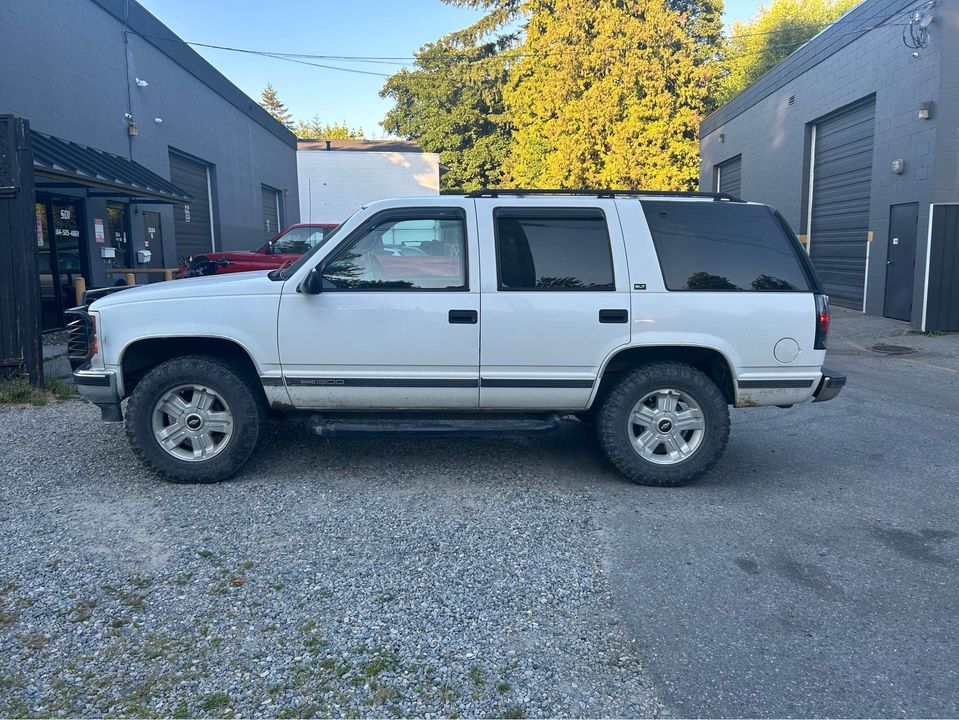

Where is the truck located? Is it where they like to use road salt?
Looks pretty clean, especially for a ‘86, but I live in Iowa where they apply salt rather liberally in the winter.
If I were looking at it, I’d look closely along the chrome trim on the fender arches for any sign of bubbling paint. I’d look inside the wheel wells along with underneath along the rocker panels.
Hey! It's located in Canada, over near Vancouver. Looks pretty clean for a Canadian vehicle, I will make sure to keep my eye out, it's a 96 with 291,000km on it.
B-train
Sep 12, 2022
2,461
4,306
Agree with @wjburken If it's not rusty underneath, the door seams look good, etc then you probably have a clean truck.
The rust does appear to be surface related from years of driving with no mud flaps. Sand it down, prime it with rust converting primer, and coats with matched paint, or use black bed coating for a thicker, tougher repair. Then put mud flaps on it.

Another '96 owner here. Mine's brutally beat up by salt in our region. Just about to hit 204k miles. Engine runs strong. No known issues with the fuel injection system in the nearly 20 years I or a former owner have owned it. Former owner is a close friend of mine and I did his repairs for him when he owned it.
The body on that '96 you're looking at appears to be decent from the pics.
Be prepared to replace things like brake lines, fuel lines, etc if it has surface rust.
I'd also look at the body mounts to verify integrity.
But at first glance you likely have a solid candidate to purchase IMO.

Hi, I am from the Vancouver area. I had bad rust on my '97, but that is mostly because I took it to the land of salt and gravel in Alberta. If it has spent it's life on the B.C West Coast, it may only be surface rust. I would sandblast the area, apply Corroseal, smooth, prime, and paint. Or just run it and enjoy, if it does not bother you.

Hey guys I wanted to buy this 96 Yukon and it looks to have rust on the quarter panels (?) on both sides. The seller says it is only surface rust. Is there an easy fix for this?
If I do go to buy it, what should I look for in terms of rust?
(Disclaimer: The owner did say that there was no rust underneath)
Open all doors and check behind the rubber seals at the bottom.
