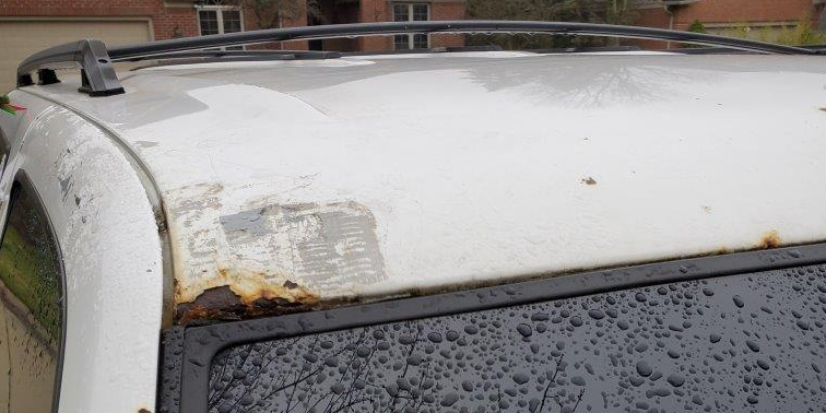

2drTahoe97
Jan 19, 2025
8
Reviving an old thread. I have the same problem and would like to get an opinion on where the water is coming in? Where the roof rack is screwed in?
50,943
19,372
Could be roof rack or right where that rust spot is at the windshield.
