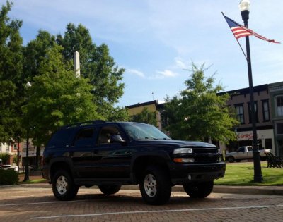

Uploaded a picture of the hoe with the old setup!
