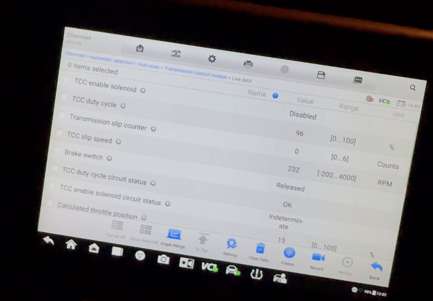

Sorry for the delay gentlemen. I only got around to doing the road trip part of the suggestions this weekend. I'm including a link to a video of 5 minutes of autel data I recorded. Sorry if it's a little sloppy. I didn't want to take the camera off the autel so that we could see everything that was happening, should be able to hear what's going on with the RPMs with volume. I do scroll through all the trans data throughout the video so you can see different parameters.
From what I've found, it does seem like my TCC speeds are all out of whack, but please do correct me if I'm wrong. Everything else was in check as far as throttle postion, intake position, brake actuation, etc.
There were no trans codes being thrown and nothing stored in history. I have access to the autel as well as tech 2 so if there's anything else I need to look for on those please advise. I'm pretty good with doing my own service on my vehicles. This would be my first time going into the trans myself. If/when I do it myself, if you guys have any suggestions to video walkthroughs, they would really help me along the way.

Here's a screenshot of the relevant information...Notice the duty cycle is over 90% when TPS angle is less than 25% and the TCC circuit is enabled WHILE slip speed is greater than 0-5 RPM...90%+ duty cycle means the PCM is commanding a full charge of max available line pressure to the torque converter clutch and it's still slipping. Slip speed under these circumstances should be zero.
Now the question is: Why is the TCC slipping?
See my above list of suspects and start testing each, ruling in and out as you go...
