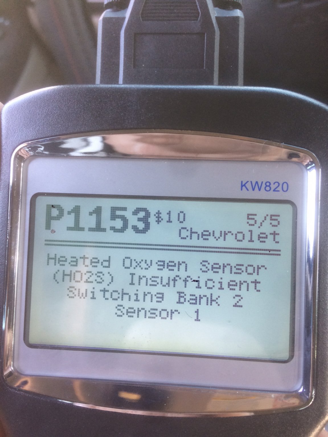

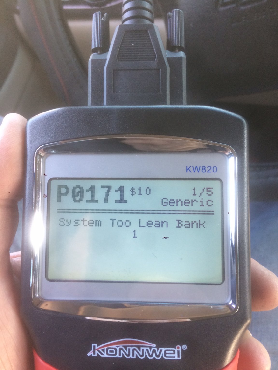

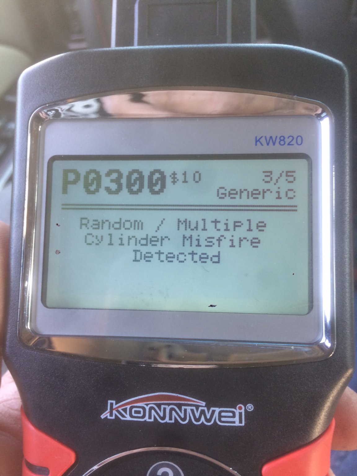

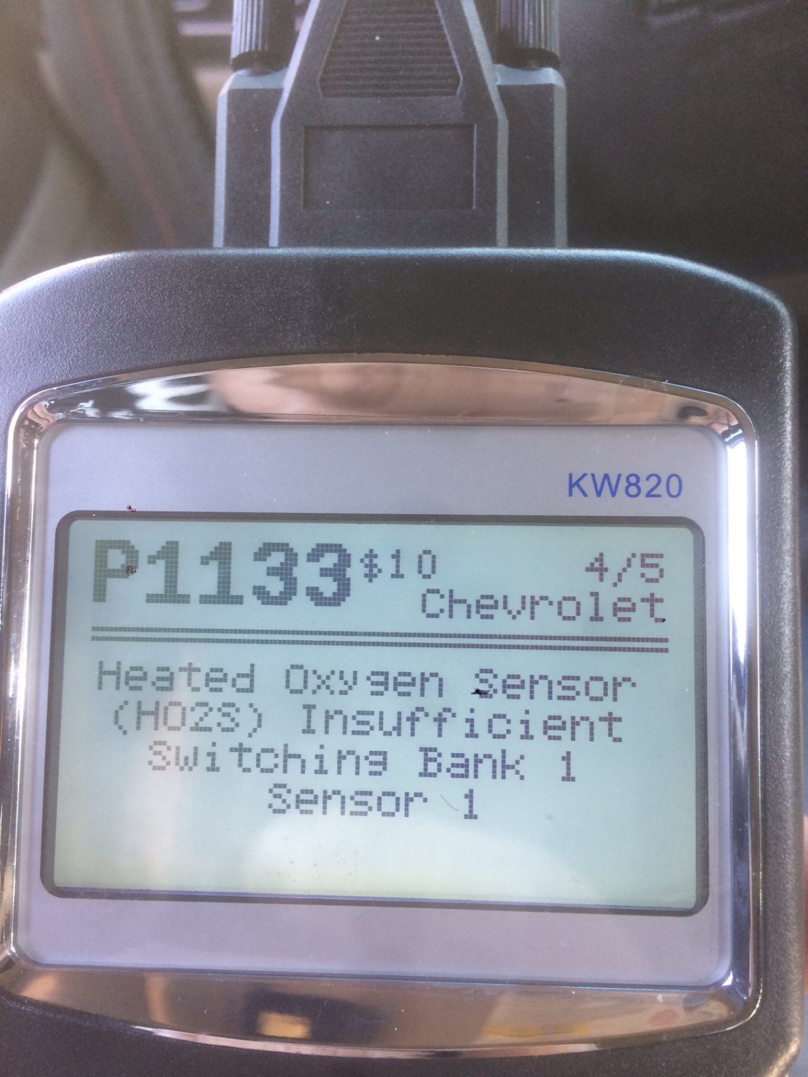

Not trying to hijack but I'm having similar problems with rough idle and didn't want to start a new thread for basically the same problems. I've replaced all four 02 sensors, removed my k&n cai and replaced with OEM air intake, new maf, new plugs, wires, coils, fuel injectors, fuel pump/filter/regulator etc. all ac delco parts
I went ahead and ordered new knock sensors, harness, permatex rtv silicone, intake manifold/valley cover gaskets, and a new intake manifold...I want to try and replace everything but the intake manifold first to see if that resolves my issues.
The only thing that's got me scratching my head is, after I disconnect the maf sensor plug it runs and idles perfect????? I pulled 5 codes yesterday...any help would be greatly appreciated
Order new intake bolts too the TSB says not to reuse them

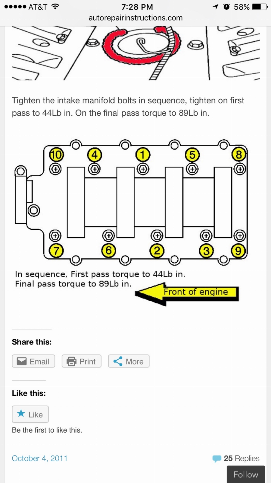

Can anyone confirm the torque settings for tightening the knock sensors, is it 15 inch lbs or foot lbs? Also need torque settings for tightening the 10 intake manifold bolts. I've been searching and I keep getting different numbers
95escahoe
Aug 2, 2010
5,162
4,466
For the intake bolts I found this
