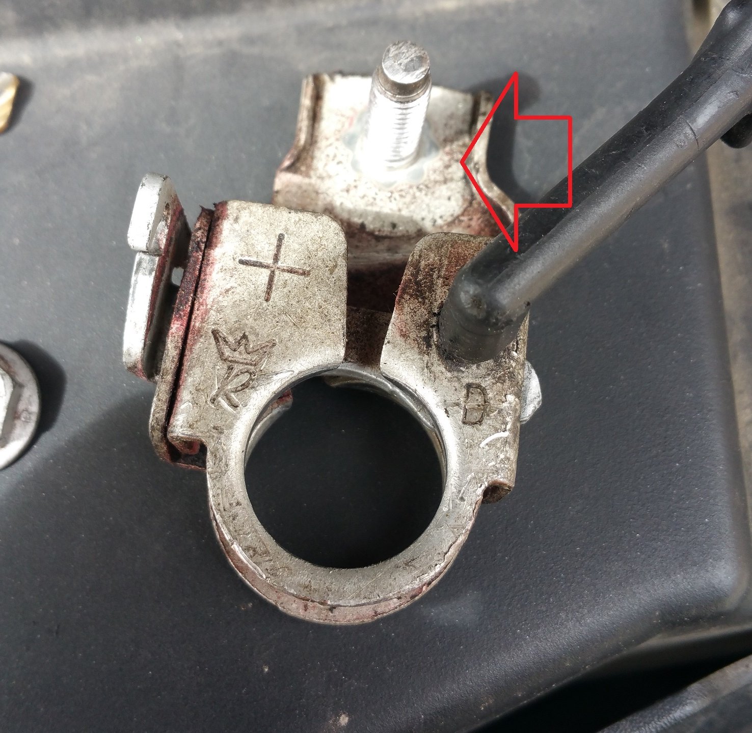

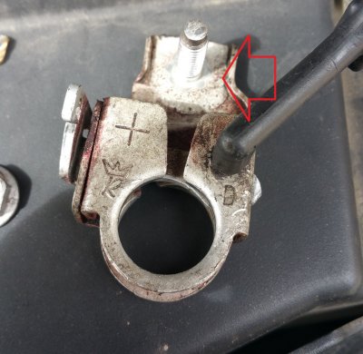

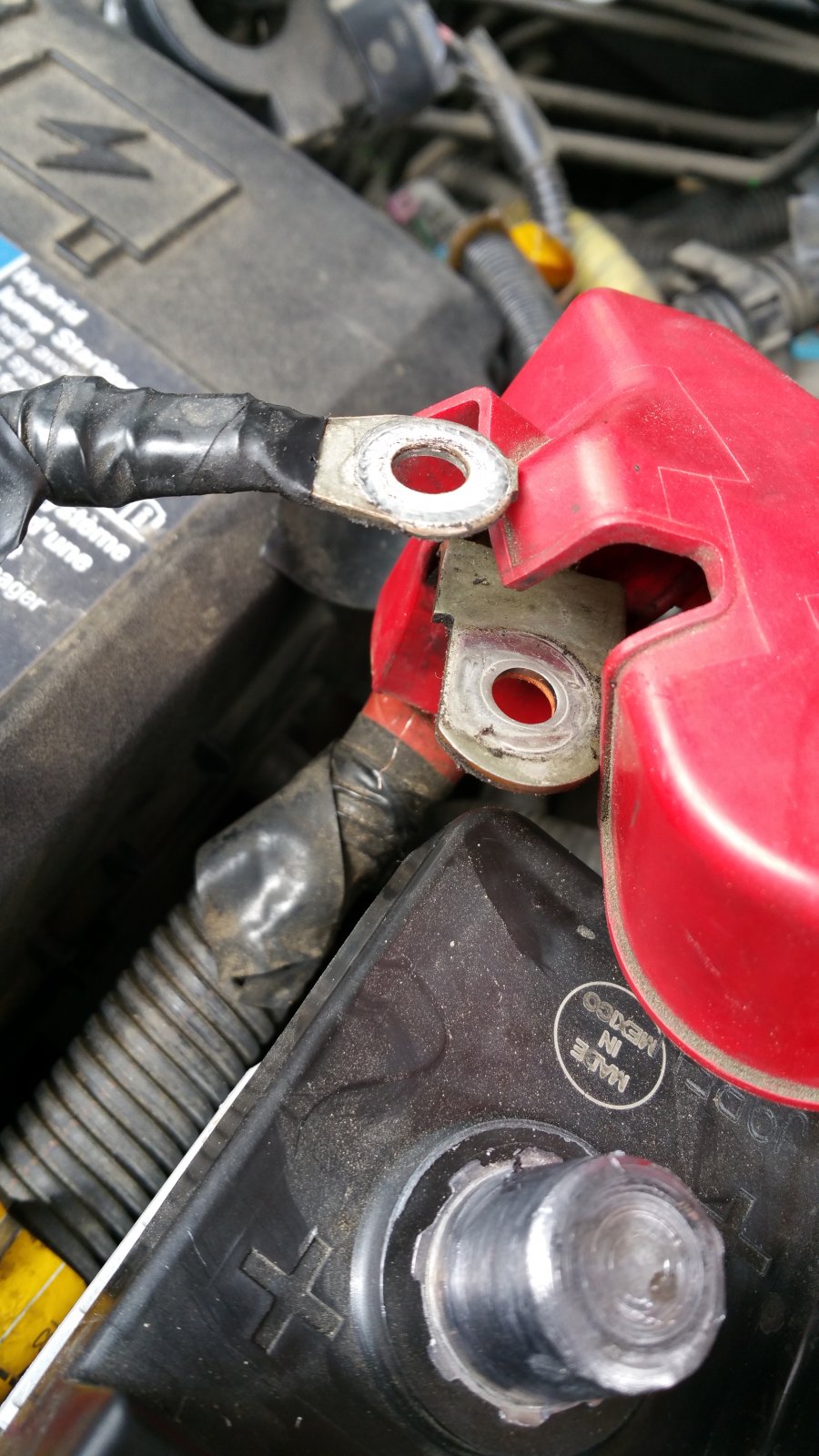

the battery is not charging correctly
14.9 (in drive/park)-15.2(in M mode W/trailer on) volts stable is where it should be at idle cold start
new battery? might be a loose wire, mine runs rough it's the battery cable, it starts getting loose? sometimes to the point where it does not move at all even though the voltage looks good on paper AMPs x OHMS X volts =fail to deliver
my voltage has HIGH ripple (gotta figure that out) yeah that is going to cause issues...
my cable is pretty dirty i did clean it lightly(worked for a little while) but going to do a Deep cleaning tomorrow :D
with iso alcohol luckily I bough a couple of bottles before the MAD rush for supplies
but DONT reconnect the cables tell it's 100% dry other wise it will catch fire
like 5-10min you may also need to reset the time
BG1988
Nov 14, 2018
3,007
1,371
so I cleaned the up cables I pulled the screws to find some "dirt" aka impedance the voltage is good and the ripple evens it self stable once the battery is charged up I was at 14.835 volts to 14.865volts the ripple on dipping and rising from 14.2 to 14.7
you need a 10mm socket under the positive cable but i cleaned up both of them the negative cable was ok
that dirt keeps it from making good contact that was probably why when i adjust them it would fix it for a tiny bit of time
It did fix the oscillation.or upto 2000rpm high idle.. but not the rhythmic rough idle
But the rhythmic of the current idle is different then the rhythmic rough idle in the past
(not talking about the Oscillation idle that is a whole another issue that has been taken care of)
