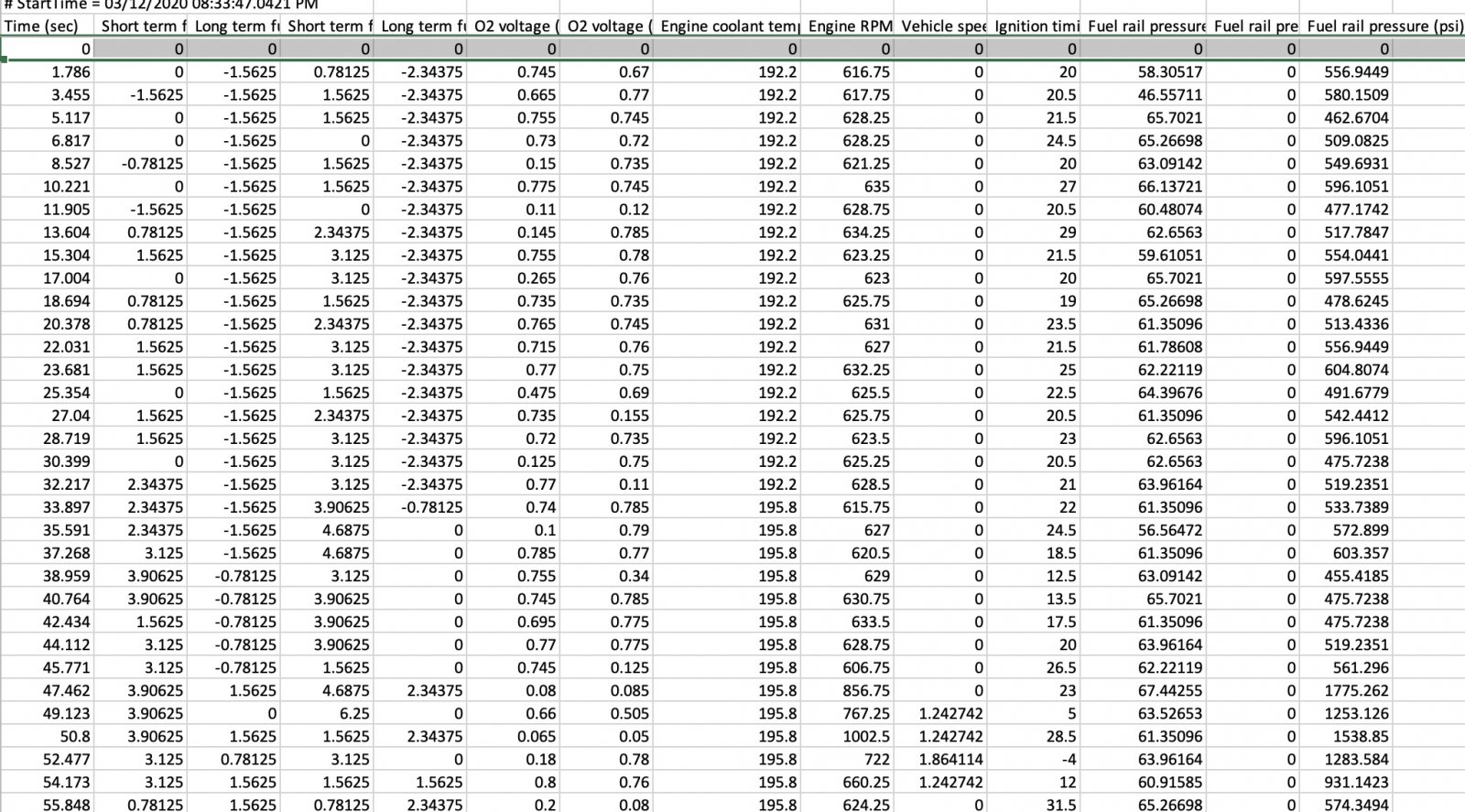

Idle pressure is at 39-70, it fluctuates quite a bit.

With the WFH there is a lot less driving so hard for me to quantify the effect. Interesting observation from BlackBear folks, they see that my idle numbers in logs are rock stable, but the actual truck is shaking. Justin feels it is either injectors or a mechanical issue and not actual misfires. I am sure Justin knows his craft and saw 100s of 5.3s like mine. Problem is that I paid for a dealer to install brand new engine and transmission mounts, tech did the whole re-seating procedure, so mounts are likely to be properly installed.
Fuel pressure numbers I have posted above point to solid pressure numbers on both low and high. What I do not know on DI engines if pressure on idle should be ruler-flat stable or it can move up and down. This is a mystery. COVID situation brought us a recession and taking $12K loss on a vehicle is a plain wrong financial move, but dealers are clueless and not willing to do any work on the truck as it is "within spec". I now even question if engine is smoother on the full tank or this is my phantom wishful thinking.
